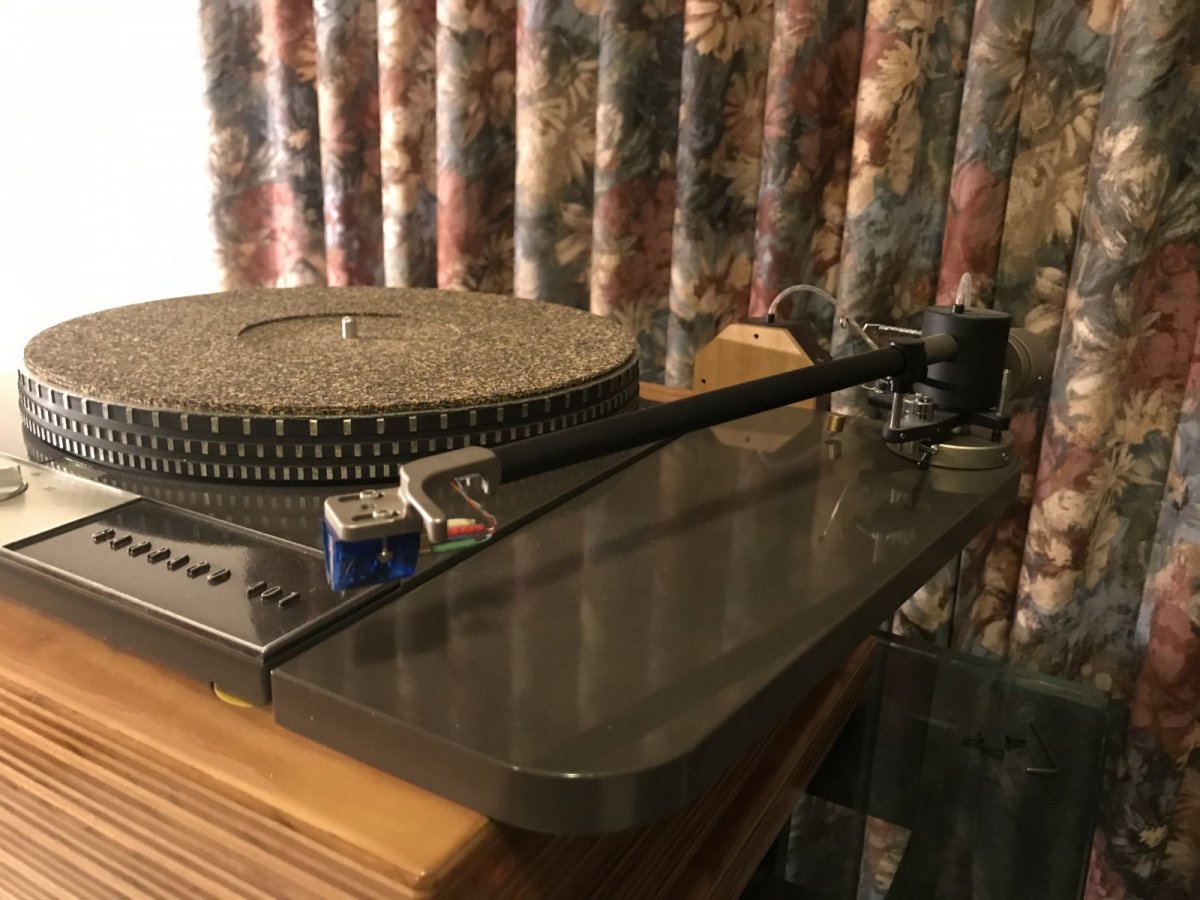

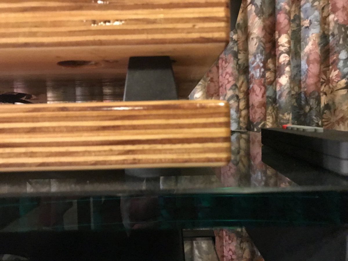

Baffilled Posted September 18, 2020 Posted September 18, 2020 (edited) Hi Tax, I too have a Garrard 401, I use Herbie's gear underneath it. I've experimented a bit. Seismic are better but at a considerable price. I use Fat Dot underneath the sub plinth plate and Tender feet big tall extra firm under the plinth. The plinth is made of marine ply, with an aluminum arm plate that was color matched to the original color. I've been told it's better to have the turntable motor and tonearm on the same plate, that is, not separated. The tonearm is a 12" Golden age audio with a custom head shell, the cartridge is a modified Zyx bloom with a sound smith tip. I was fortunate to work with the brilliant Peter on this project, he was surprised how good it sounded, but as earlier mentioned, preferred the Commonwealth followed by the 301. I've sent a pic to explain above Hope this helps, Kev. Edited September 19, 2020 by 65eclipse 3

Tax Posted September 21, 2020 Author Posted September 21, 2020 On 18/09/2020 at 9:08 PM, 65eclipse said: Hi Tax, I too have a Garrard 401, I use Herbie's gear underneath it. I've experimented a bit. Seismic are better but at a considerable price. I use Fat Dot underneath the sub plinth plate and Tender feet big tall extra firm under the plinth. The plinth is made of marine ply, with an aluminum arm plate that was color matched to the original color. I've been told it's better to have the turntable motor and tonearm on the same plate, that is, not separated. The tonearm is a 12" Golden age audio with a custom head shell, the cartridge is a modified Zyx bloom with a sound smith tip. I was fortunate to work with the brilliant Peter on this project, he was surprised how good it sounded, but as earlier mentioned, preferred the Commonwealth followed by the 301. I've sent a pic to explain above Hope this helps, Kev. Thanks Kev! Plinth and set up looks great. Yes, Duc was very helpful and was always willing to try and fabricate something when needed. I have 4 of these Herbies footers. I am contemplating whether I should cut out a recess in one of the plinth layers and then use it as a sandwich for the next layer. Not sure how it would work with the solid hardwood I am considering. Would possibly work in a birch play void with the wood veneer wrap.

Baffilled Posted September 22, 2020 Posted September 22, 2020 Hi Tax, Enjoying the thread, Could you please give me your opinion on the difference between the herbies and Gai 3s ? Metalbeat, was there a significant difference when you replaced your old platter with the Artisan fidelity copper platter? I've been drooling over them for years. Just for the record, I manufactured a few platters for 301"s and 401's a couple of years ago out of 6061 Ally and just the billets cost $125.00 each. 6 1
