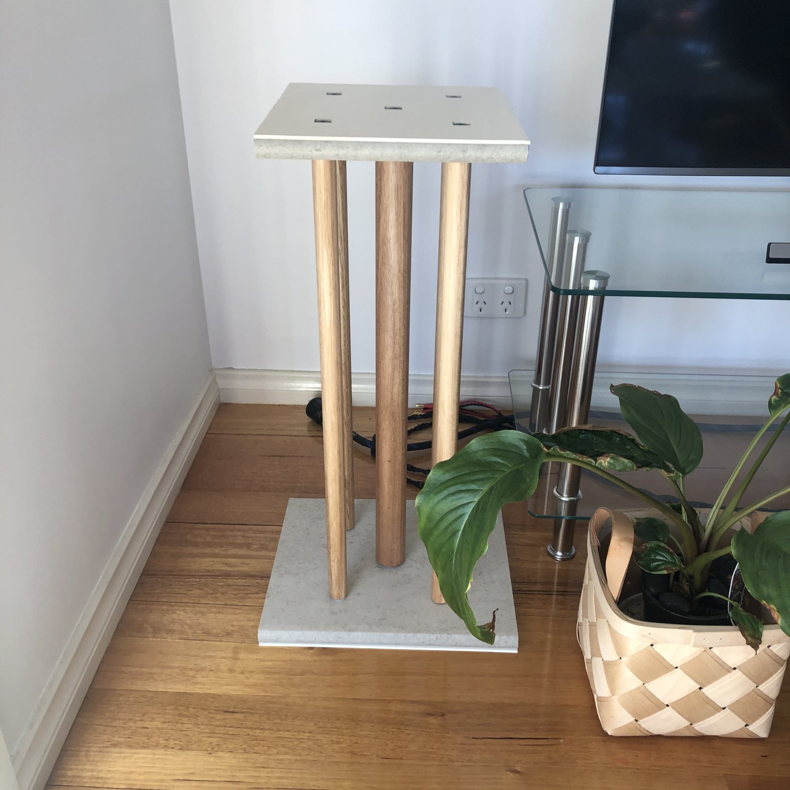

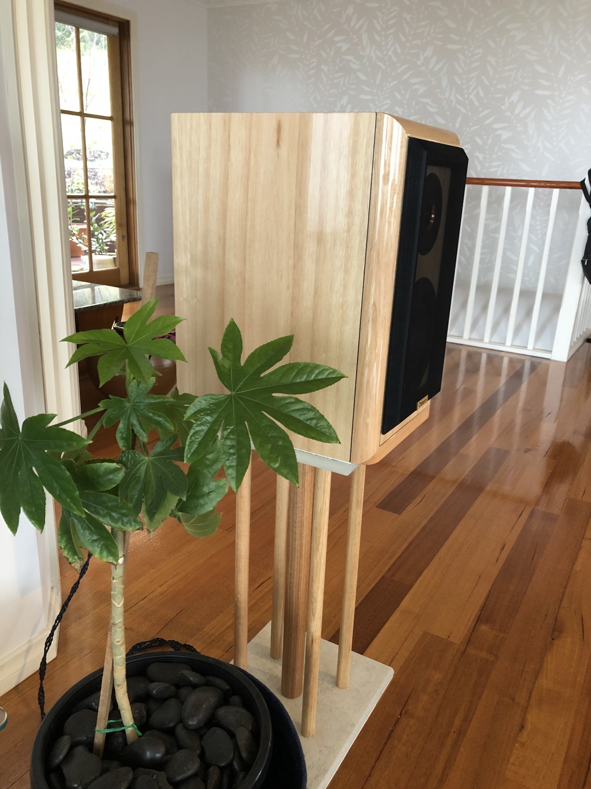

I have also just purchased the Titans and struggled to find a stand (top plate size and not black steel ) so I made my own with 20mm porcelain tile and tassie oak. I then used a white rubber/ neoprene I got from clark rubber - this has not only stopped any slipping but isolated speaker from stand and stand from wood floors.
  • Like 5
Great work, nice design and perfect colouring for the veneer on the Osborns!
Link to post
Share on other sites
They look amazing, as does the finish on your Titans. Not to my taste colour wise, but they fit the style of your home perfectly. They must be some strong stands. The Titans are seriously heavy.
