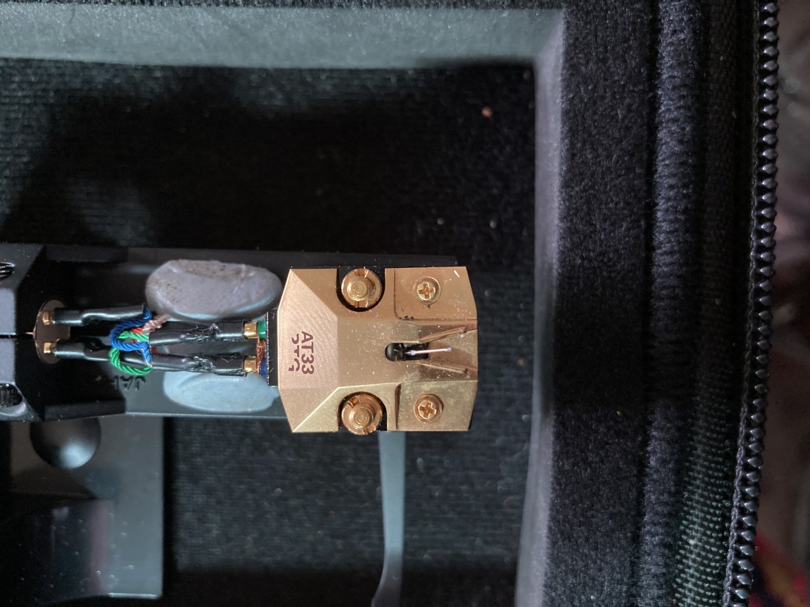

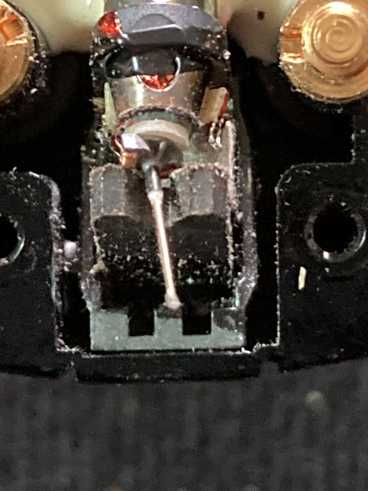

So... I have a retipped AT33-PTG which I have been using strapped for mono. It has been playing well but last week, the cantilever separated during play. On examining it, it is further back from the join of the cantilever and the suspension- just ahead of the rubber suspension donut. I assume there was a cord/string which has broken. I have attached a couple of pics to illustrate. I would appreciate the wisdom of the stereonet denizens.

It is hard to see from the pics, but it loos like the tie wire has broke. On a MC the cantilever is held against the rubber suspension by a retaining wire, if the breaks the cantilever will collapse. This is not the retippers fault. This repair is far from simple, it is doable (I am able) but it is probably not worth it. Basically the coils need to be disconnected and may need rewinding after this. Then cantilever and coils can be removed completely and tie wire fixed then reinstalled and coils resoldered or rewound and reconnected. It it was a 5K carts yes worth it IMO, but there is many hours of work to do this. Dmitry is a friend and he can repair it too ( we talk often as both cart nuts) which I think who is being discussed in Russia, but this is a massive job. I have a cart I am doing this to for myself, but I would not take this on for anyone unless the cart was really worth the trouble as to fix this the retipper is basically making a new cart. If you are asking someone to rewind coils fix tie wire and reinstall coils and stylus it would be nuts not to change stylus too. Then you need to look at how much all this is going to cost and how much is a new cart.
