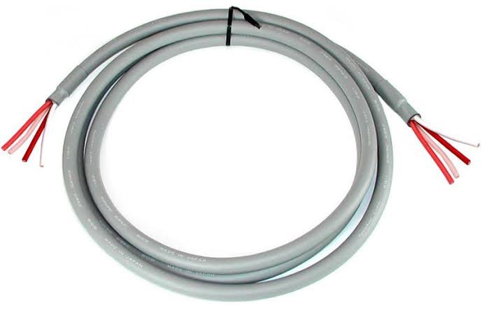

Had fun making these Canare 4S11 cables. Definitely demystified the big brand cable game for me as these kind of blow away my Van Den Hul D-352 and Chord Odyssey, and those two were the best result pr

Hi @dles1972, very nice work on these cables. :thumb: I'm about to make myself a set and was wondering did you strip the outer insulation and twist the pairs on the full length or just the ends?
Cheers,
Russ
Hey Russ thanks. Just the ends. About 15cms approx

Due to the star-quad architecture of all 4 cables, & that they are both reputable manufacturers, the Inductance & Capacitance values across the spectrum are all very similar and very good as I read it.
The Mogami has slightly lower capacitance, but this is the least important of the 4 specs (Rdc, Rac, Ls & Cp) when considering speaker cables.
You have to be careful reading the specs, as some of the R & L specs are given per conductor, some are given as 'loop' values and some are given with the pairs connected in parallel (as you would do when not bi-wiring)  You have to stay on your toes & read the fine print!
I doubt there would be any noticeable difference between the brands when each is compared with it's direct equivalent.
The W3104 (or Canare 4S14F) could offer an advantage driving high powered passive subs or PA speakers, or for longer cable runs.
