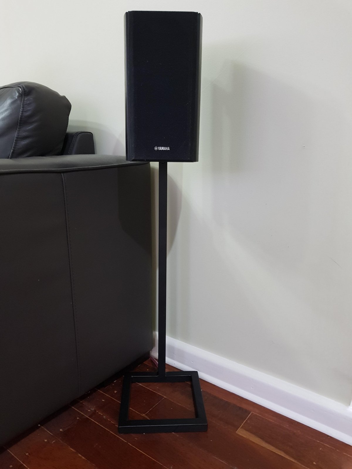

I always wanted to learn to weld so I bought a multiprocess welder and have been having fun.
I thought I'd start with a pair of surround speaker stands.
The cable will be run inside the tube and powder coated.

Great work.  ? I wish I could do that so I can custom make speaker stand for my speakers. They are on too high or too low height stands at present.

Thanks mate. Yeah these are measured to sit at head height..
Fun skill to learn.

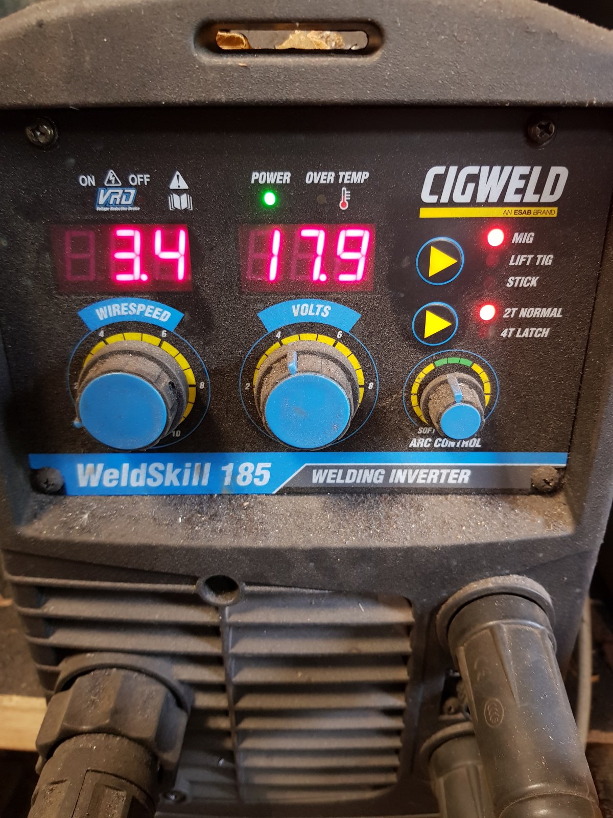

On 25/05/2020 at 7:41 AM, Peter-E said:
Care to share your settings. I'm still learning
Apologies for the delay Peter- here you go.
I hope this helps

Thanks
Your welding stick and MIG.
I've not tried stick yet and MIG only a little. I've been concentrating on TIG for now

The first shot was for TIG by the way.

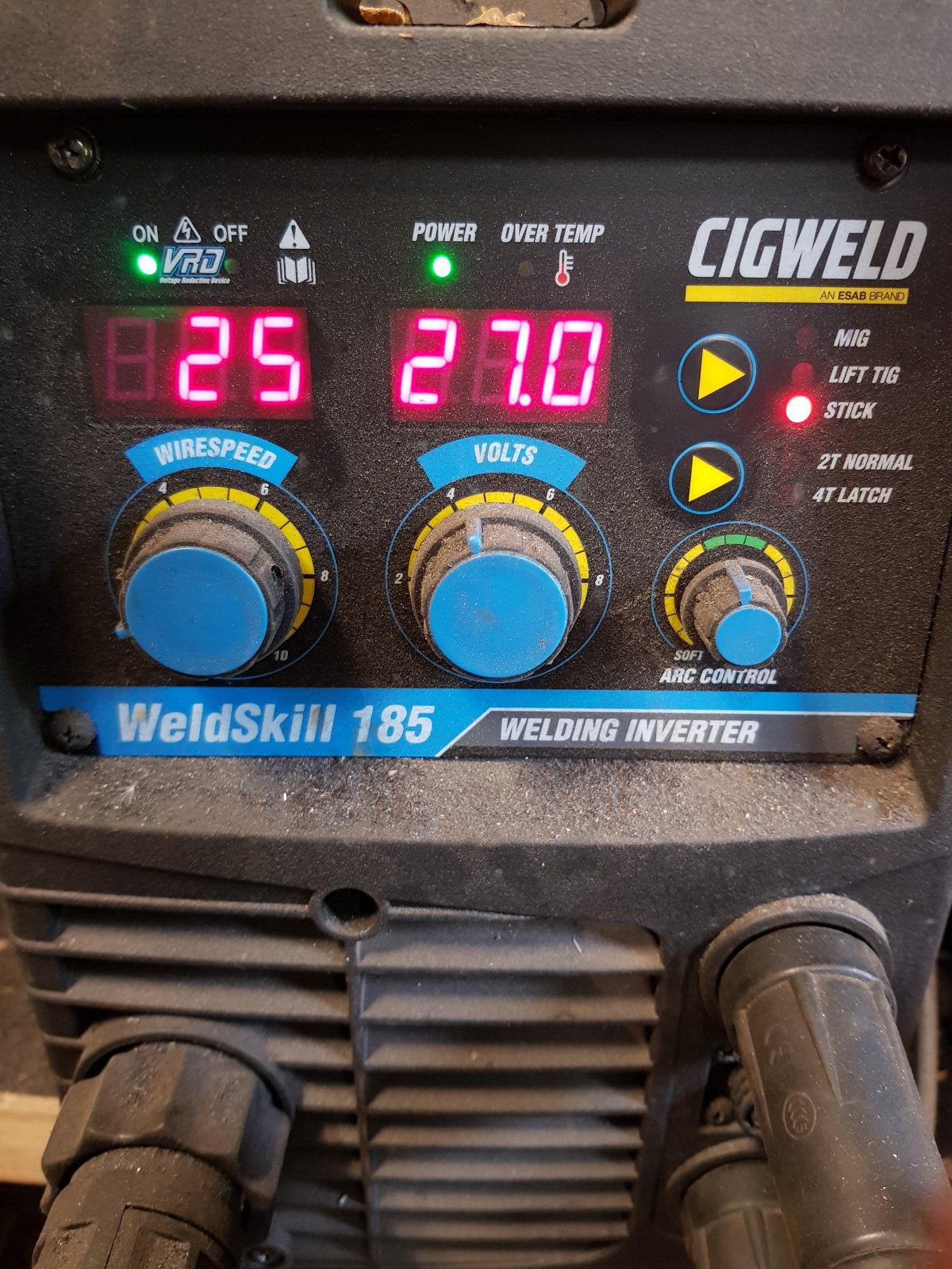

25amps for 1mm?
From what I understand 25A per mm of stainless 30A per mm of mild steel?

Couldn’t find “a bought one” so appreciate your initiative to DIY
20mm porcelain tile, tassie oak and white neoprene
