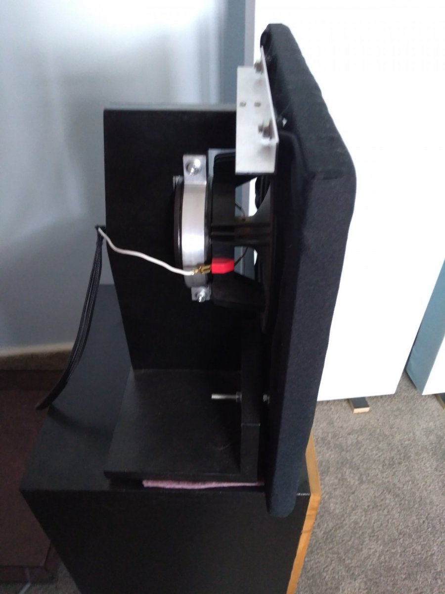

Warren Jones Posted April 18, 2020 Posted April 18, 2020 (edited) Mark Audio 12P in a open baffle with 2x 300mm Visiton woofers in a W frame with XO at 280Hz As they are now. The 12P is magnet mounted to a centre spine and the baffle is mounted to the spine with rubber grommets and a soft seal to seal the 12P I have used 4 different types of FR and the 12P is by far the best. Edited April 18, 2020 by Warren Jones 1
Sub Sonic Posted April 18, 2020 Author Posted April 18, 2020 Thanks @Warren Jones, it looks like a nice setup Would it be possible to post a pic of the 12P mounting arrangement? And what model are the Visaton woofers? Which other wide range drivers have you tried? I’m currently using the 10P which I love. Cheers, SS
Warren Jones Posted April 19, 2020 Posted April 19, 2020 (edited) No worries here is the setup. This is about the 6th iteration and sounds amazing. The baffle is 7mm plywood laminated with 6mm MDF, glue is Sikaflex polyurethane construction adhesive, available at Bunnings. Baffle is held on by bolts but nut are only finger tight enough so it does not rattle. Spine and base is 18mm marine ply same as the woofer enclosure. . Edited April 19, 2020 by Warren Jones 1
Sub Sonic Posted April 19, 2020 Author Posted April 19, 2020 Thanks for posting. It looks very similar to some of my creations, except that due to kids I use flyscreen instead of grille cloth
Warren Jones Posted April 19, 2020 Posted April 19, 2020 (edited) No kids, they have grown up and flown. Previous FR Fostex FE108 Fostex FE206En modified with phase plug and whizzer brace. Dayton Audio PS220 required notch filter to remove terrible peak (SHOUTY) Mark Audio 12P The Mark Audio is by far the best. The system has no correction. Baffle Step was done using the XO point, baffle width and driver placement in the baffle. They have been designed to work in my room so measuring out in the paddock they do not measure well but in room response is good. They are bi-amped with active XO between pre and power amp. Edited April 19, 2020 by Warren Jones 1

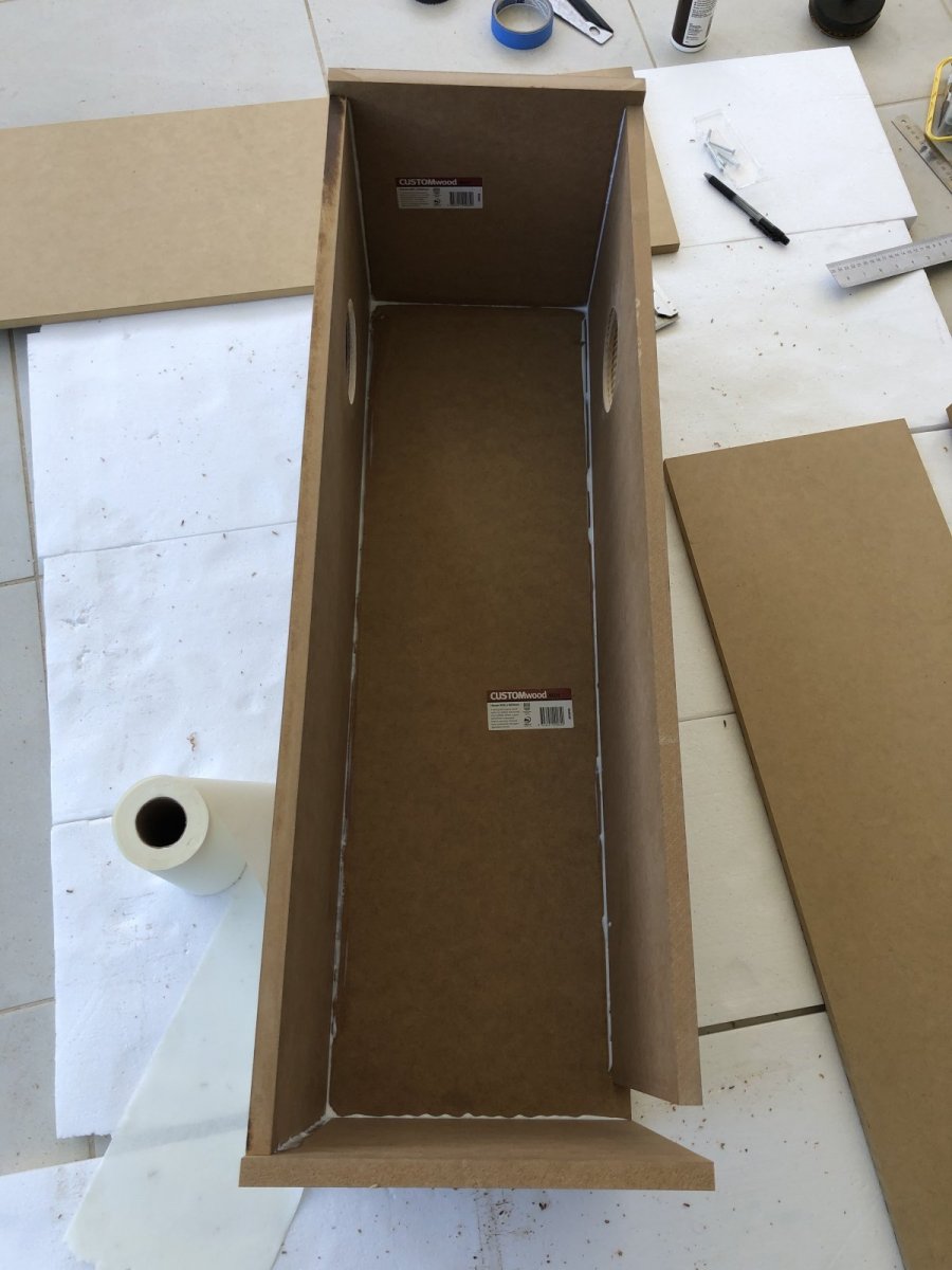

astromo Posted May 8, 2020 Posted May 8, 2020 (edited) I got myself a pair of 12Ps from the guys down in Tassie. The current plan is to mount them in Classic Golden Ratio Mar-Ken12 boxes. Was on track to get learned up to use a CNC router to do the wood work via community resources but my plan got scuppered by the plague. All in good time. I'll get there in the end. Good to read that there a few MA fans out there. Gives me confidence that I'm on the right track. Edited June 23, 2020 by astromo 2
