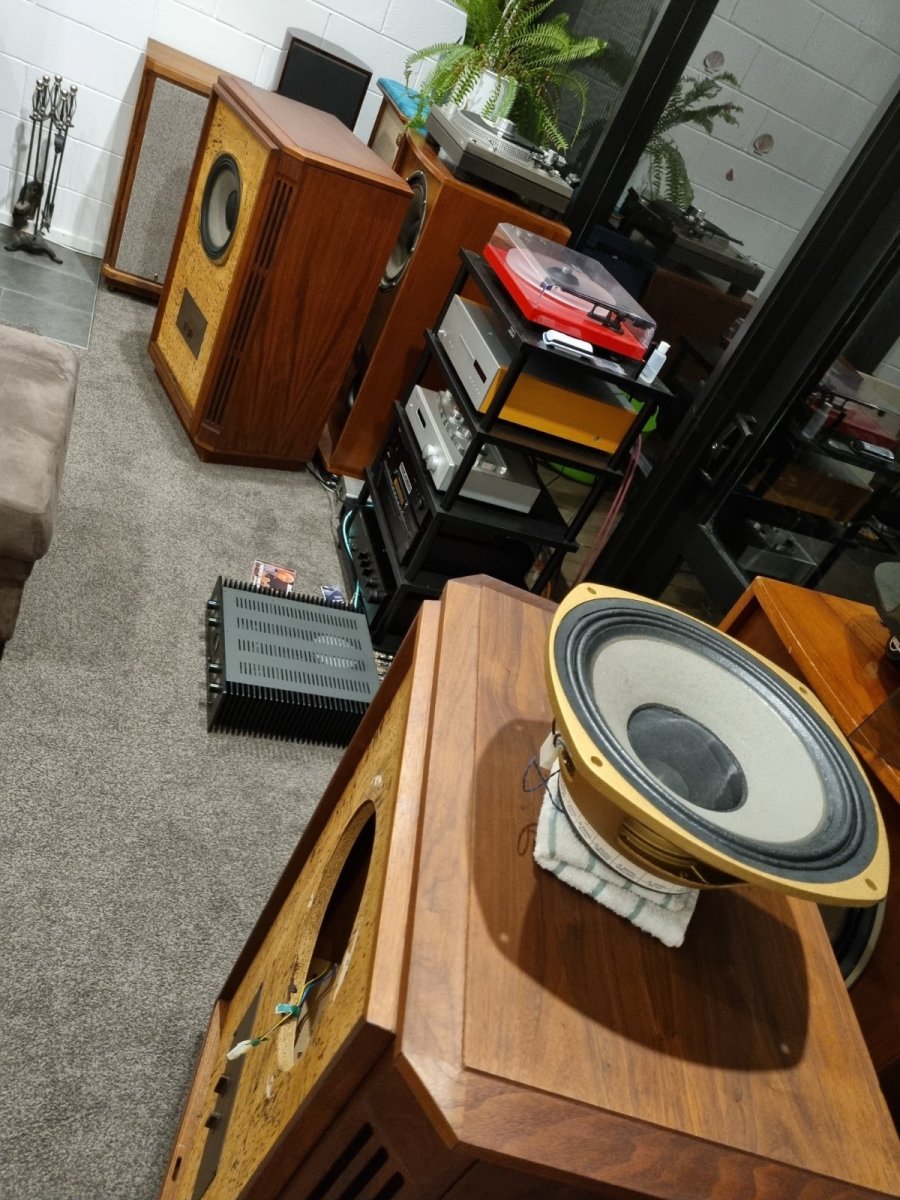

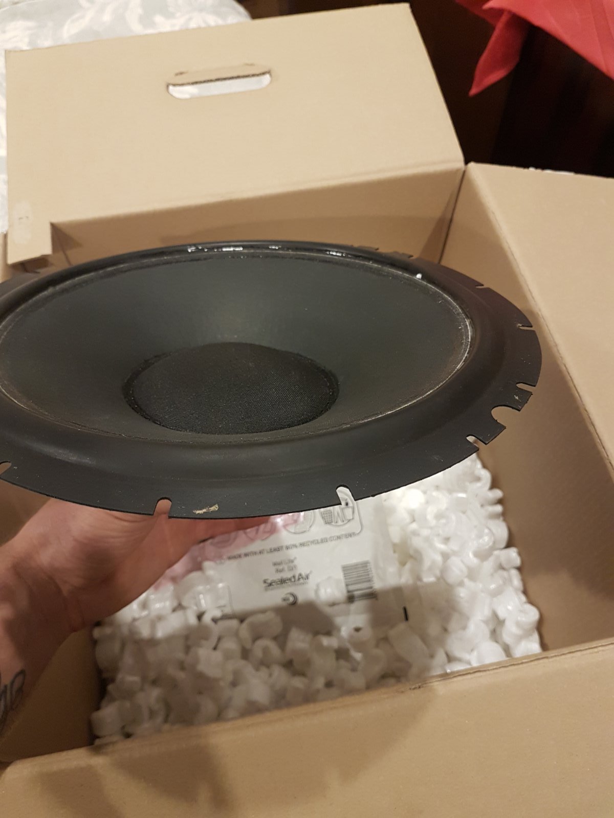

So thought I would post a few pics of these monitor gold 12's I've been rebuilding for @naggots , they were dropped off with me , voice coil rubbing and not working , we sourced the last known nos 12 inch monitor gold cones as I found the original voice coils were absolute toast , I've cleaned the VC gaps and hf gap , re aligned and check shims on hf drivers , fitted and aligned new bass cones and yet to do crossovers and plugs , just got them running and ran a few sweeps and they are ballanced nice and even and testing spot on ! Have them running with brand new 50 year old cones and they sound great ! Cant wait to finish the xovers and hear them once they have some cabs proffesional built ?

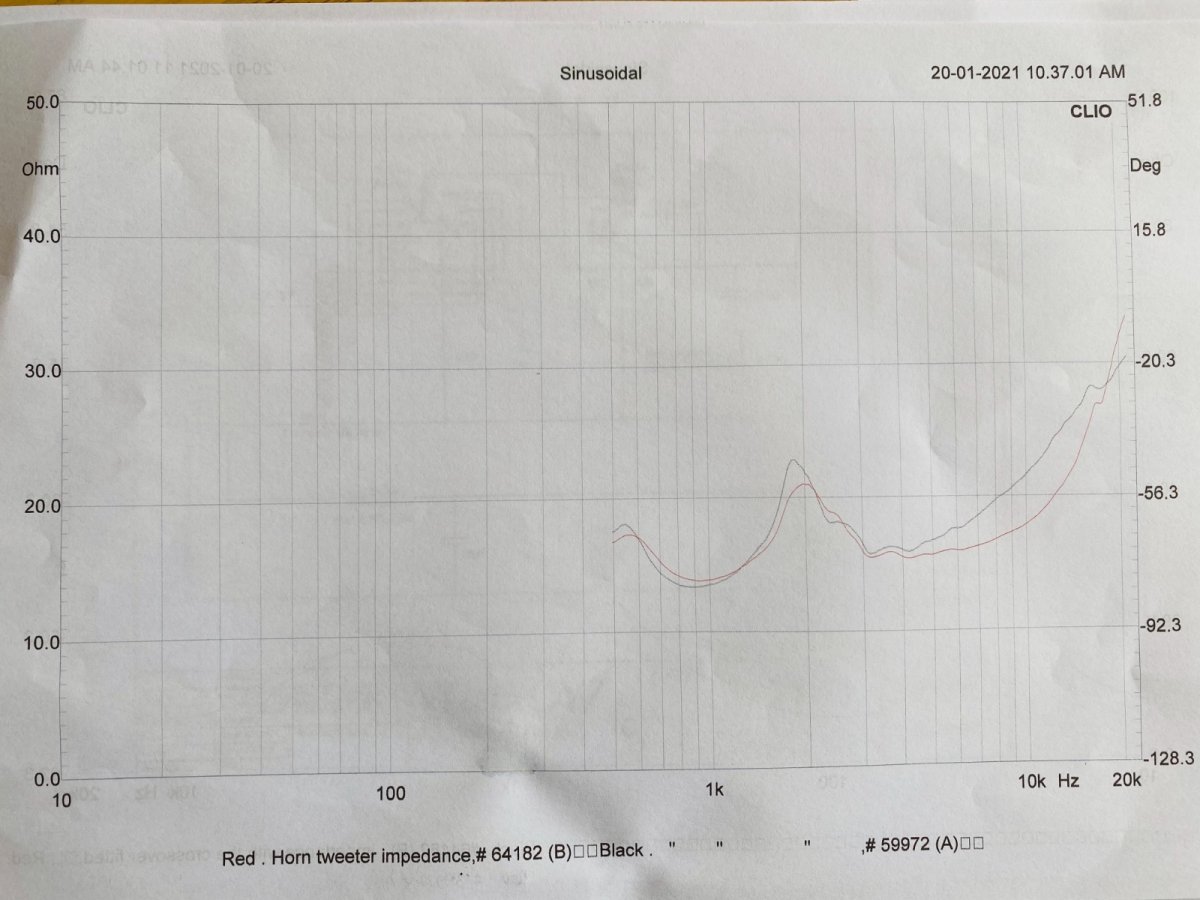

An update for Lx4man a few months later. I ran in these newly coned/crossovered speakers over Christmas and new year, lightly running Spotify 10hrs a day.
John from Aranmar Acoustics suggested I send them to be measured by Barry Arntstein before He can work his magic.
Awaiting the design but looks like Black Sassafras is the Timber of choice........

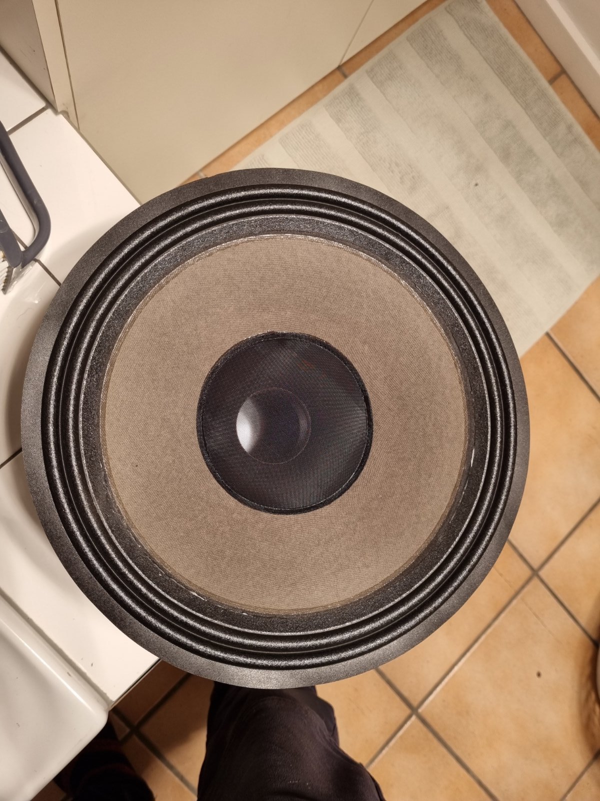

So guys it's been months since I've been active on here due to personal situations,  recently I have got around to servicing the Edinburgh's,  now the Edinburgh's use the tannoy 3149 driver as used in the lrm and dc4000 and others,  allot of people think the cloth surround is forever lasting but this is far from the case , the end result is cracking but even long before that point they harden and this dramatically increases driver fs. My two measured up in the 70hz region when in fact 32hz is spec , I can't imagine a single 3149/3169 driver would be in spec now unless it's been reconed or re suspended , this explains the general consensus about lack of bass from these drivers , the high fs causes an upper bass hump with a sharp roll off ,it also effects the mid range of the driver as well due to added mechanical resistance and loss of damping characteristics as the cloth hardened , with new suspensions first thing is the mid bass hump has gone and the extra output in the bottom end but then you realise how much better the bass mid crosses over with the compression horn making the driver much more cohesive,   so for anyone who thinks these doped cloth suspensions live forever that's unfortunately not the case and I'm sure the majority are well out of spec by now .....20210325_082453.thumb.jpg.e7db833ecee9ac3cad6fb3158e84196a.jpg20210325_191117.thumb.jpg.afd886f742c7d7e120619dbd23b81fc6.jpg20210325_193414.thumb.jpg.847a5d5595d53424c06da8ec00eccd10.jpgIMG_20210329_212005_917.thumb.jpg.8fc9eead2368dedb5ee7408e17e653dc.jpg
