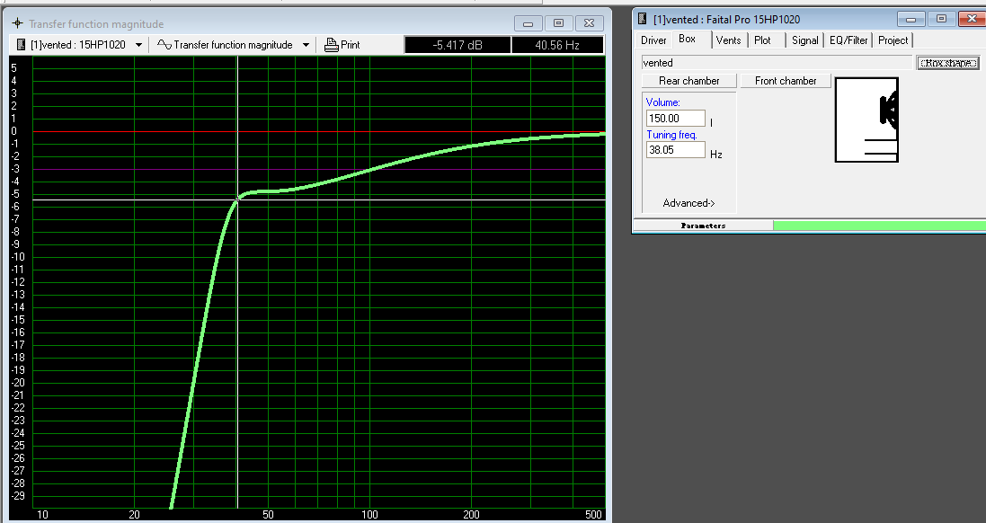

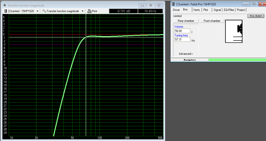

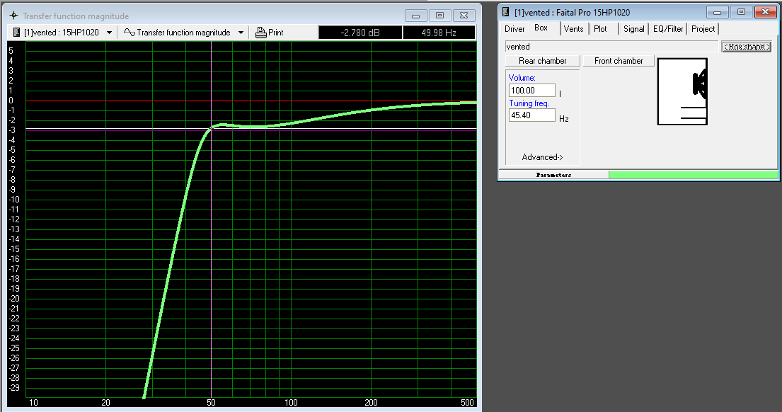

Maz4bz Posted February 28, 2020 Share Posted February 28, 2020 Everything is a compromise. Try using a modelling tool - pop your driver specs in and play with the box size & tuning frequency. I'm in the process of building some nice floor stand two ways. The 15" woofers have the following response in these modelled box size and port tunings.... Link to comment Share on other sites More sharing options...
marten Posted February 29, 2020 Share Posted February 29, 2020 11 hours ago, Maz4bz said: Everything is a compromise. Try using a modelling tool - pop your driver specs in and play with the box size & tuning frequency. I'm in the process of building some nice floor stand two ways. The 15" woofers have the following response in these modelled box size and port tunings.... Don't have a project or drivers at the moment, but plan one in future, so I'm trying to learn from you builders as much as I can. Thanks for the graphs; looks like you have a reputable driver there in the Faital 15", which Paul Spencer may well characterise as a "high sensitivity pro audio driver". Your plots show the variation in LF cut-off for different box volumes, but then, using EQ one could make any of them more usefully flat. Thus the key issue may be one of max SPL available from each option without excessive excursion. Are these four plots normalised to the same SPL for each alignment (e.g. does the 0dB red line represent a common SPL value across all four plots)? Link to comment Share on other sites More sharing options...

Red Spade Audio Posted March 3, 2020 Share Posted March 3, 2020 Just now, marten said: Are these four plots normalised to the same SPL for each alignment (e.g. does the 0dB red line represent a common SPL value across all four plots)? He is looking at the default view in Win ISD which shows the small signal bass extension. You are zooming in on the bass extension you would see with 1w input if you measured the speaker outdoors ground plane or nearfield indoors. Move across to the SPL tab with 1w input and you will see that 0 dB equals the sensitivity of the driver as modelled by Win ISD. Often it will be lower than the spec sheet. Link to comment Share on other sites More sharing options...
marten Posted March 3, 2020 Share Posted March 3, 2020 (edited) Thanks for chipping in, Paul. Given the plots show "small signal" responses, my takeaway is that, if you choose to apply EQ to your finished sub, then these plots do not tell you enough. You need the equivalent of a type of "max practical SPL" plot to know what -3dB point you can achieve for each box volume with EQ added. Edited March 3, 2020 by marten Link to comment Share on other sites More sharing options...
Wozza_Lee Posted March 3, 2020 Share Posted March 3, 2020 Correct, once you eq you can adjust the response. Generally at the cost of sensitivity (ie more power needed to make same spl) Get winISD and have a play, its great software and will help you get your head around different box styles and characteristics Link to comment Share on other sites More sharing options...
