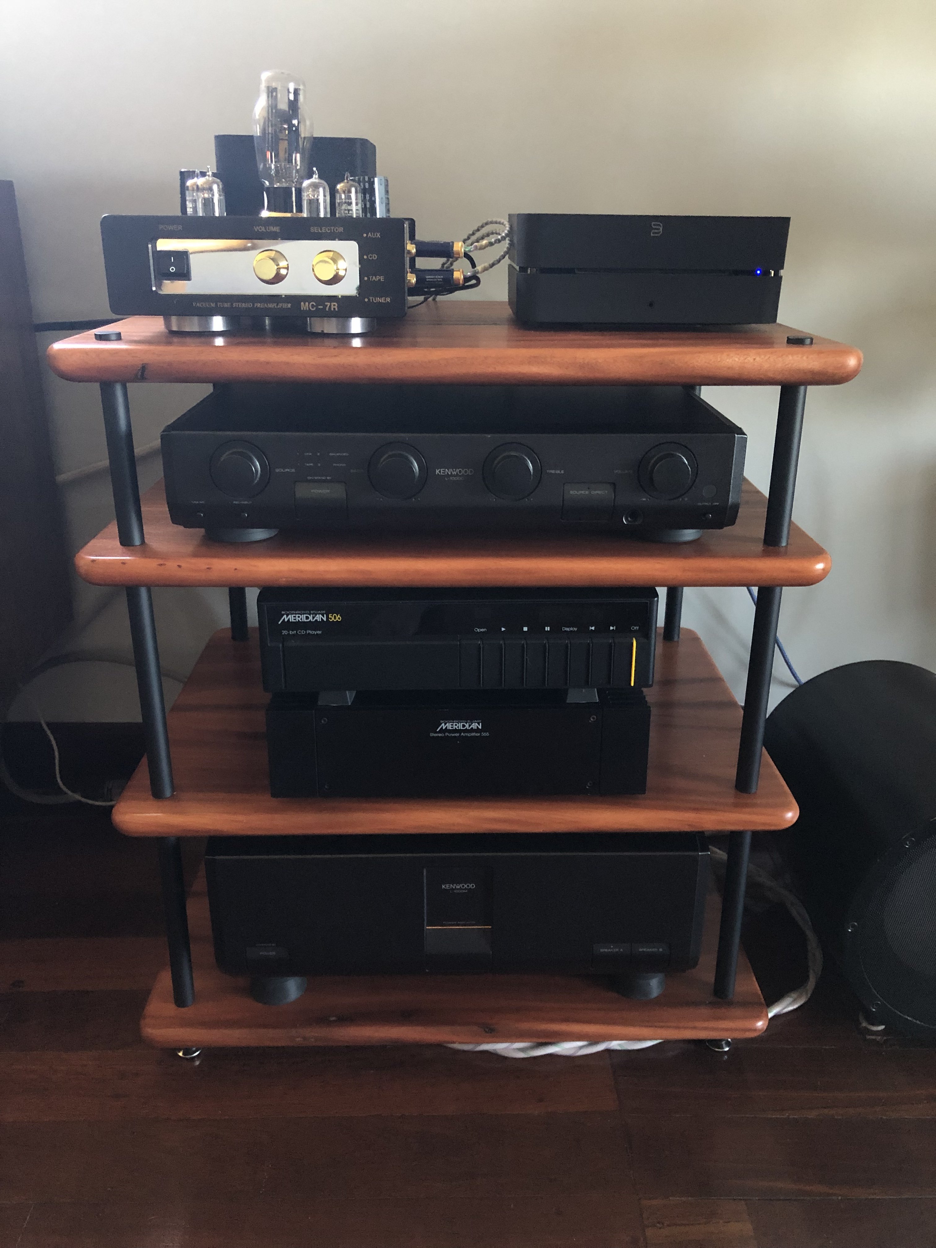

1 minute ago, Assisi said:
@Dacman
As you know I used bamboo and steel rod.  The bamboo was a kitchen bench top from Bunnings cut into four pieces.  Interestingly the cost has gone down in just over 2 years
https://www.bunnings.com.au/kaboodle-2400-x-600-x-35mm-bamboo-benchtop_p2662191
John

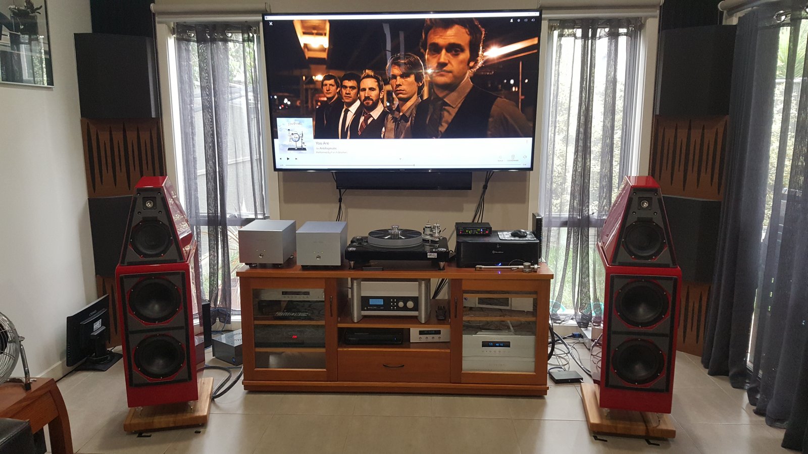

45 minutes ago, 08Boss302 said:
Hi mate, hope your well
I really like how you've placed the speakers on bamboo boards
I'm going to try that...
What have got under the boards?
Looks like spikes, I'd do as @Soundscape suggests and isolate the bamboo boards from the floor.
Edit: although it is hard to see and they might actually be isolating footers? @Dacman ?
Edited by muon*
im good you doin? theyre hardwood on spikes gave me transperancy lost some bass but got it back with positioning
