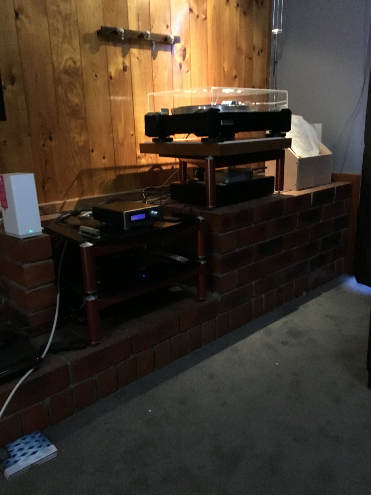

I’m going to build on the brick platform that you see in the picture by topping it with a slab of something with another shelf higher up, about at the height the turntable is now. I’ve been considering some nice timber slabs but am also considering alternatives. I’ll probably render the fascia so I won’t have the exposed brick. Rendering allows colour possibilities, looks neater and will be easier to clean. With regards to the top/ shelf material, are there some cost effective stone or poly solutions that you’d recommend? Quite like the idea of something in a white/ light grey as an alternative to timber. Hit me up with some suggestions. Sorry for the crappy iPad shots.  Cheers, M

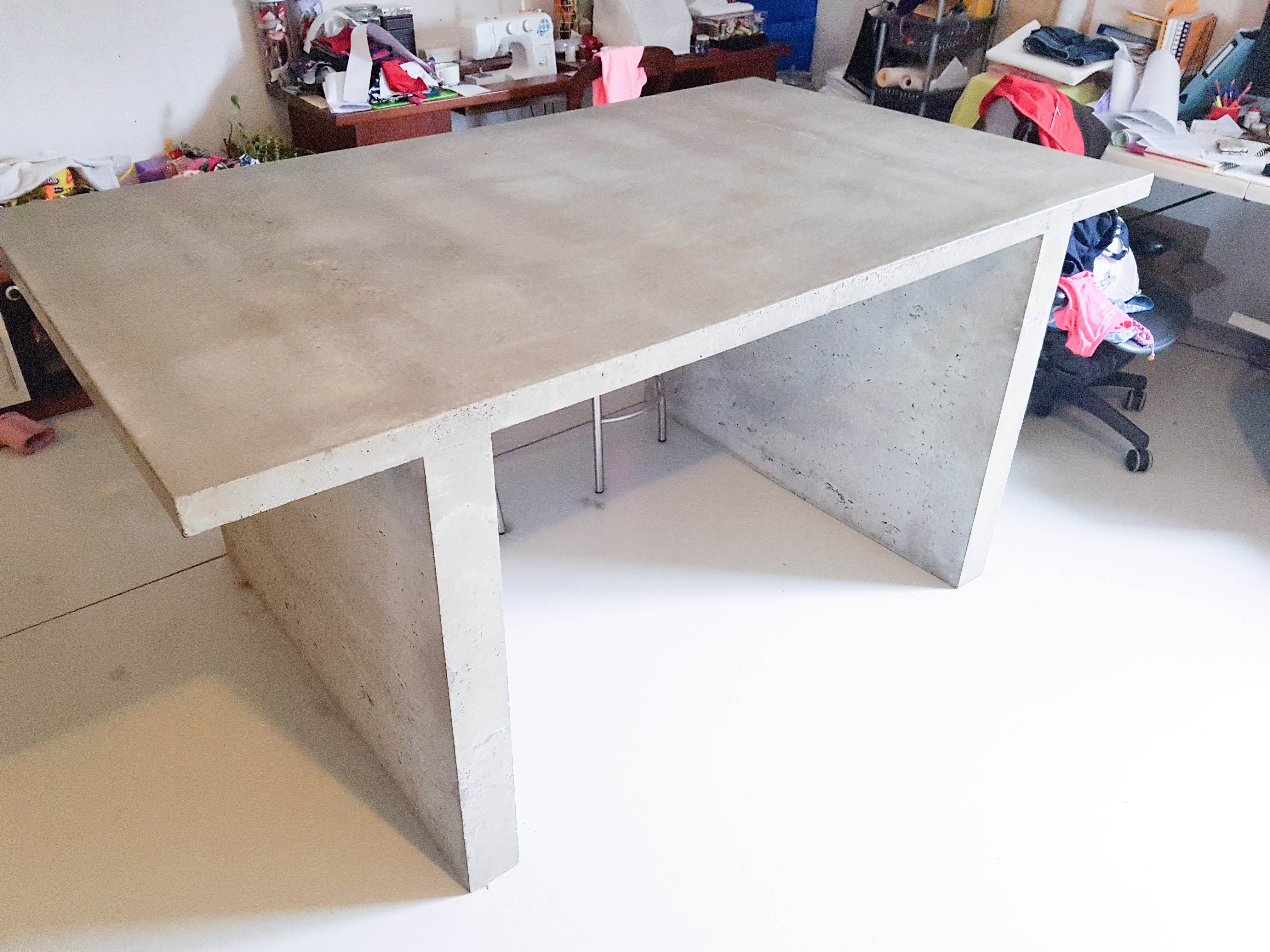

Polished concrete - cast in a form, flip it, ultra smooth with a bit of work. Will look neat with the rendered brick
Here's some we've done
PSX_20181104_082517.thumb.jpg.d76c0a6c9106f8b5b10a12cc63aea167.jpg1298377622_181117Kitchen4.thumb.jpg.c845c6e56063177b23f4da257ff2359a.jpg409990188_181117Bathroom.thumb.jpg.65dfdb6afc3a80d5decc41d1157c281a.jpg
That’s very interesting mate. How much work is involved though? Looks like it’ll be beyond my meagre skills. I like the idea though. The examples in the pics look great.

Honestly for the sizes you're looking for I'd first head down to any stonemasons that deal in engineered stone countertops nearby and see what they've got in offcuts. You might get lucky and for a cash sale end up with just what you need, though you'll pay for the edgework if you want anything finished in >20mm thickness.
I'm a fan of a bit of grain though so my inclination would be towards a hunk of timber or two, limed and sealed two-pack with a satin finish. Very doable at home, @unclemack. Strand-woven bamboo looks effing amazing in this sort of application and it can be had to 40mm thickness. Liming it can get you some very interesting, very beautiful finishes in the colour range you want, and sufficient coating will get you a completely flat surface.
Love the concrete @Peter the Greek.
You could also consider laminates - there are some very decent finishes to be had. Check out goflatpacks.com.au if you want to see options and get samples.
Cheers. Yeah, its quite a bit of work.
I'm with @rmpfyf find some stone off cut. In fact, I'd hunt around for some marble.
If it were me, I'd paint the timber panel, then stone tops, then render, then new flooring. It'd have great textural quality.

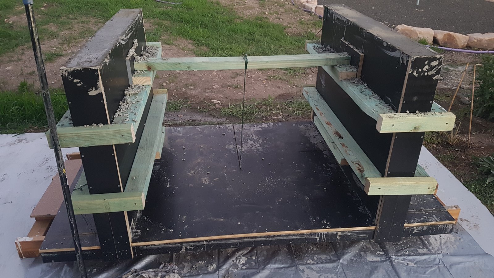

It's semi gloss, well that'swhar I'd call it. I got a wet grinder used for gems - basically a little angle grinder that a hose connects to. That and my festool sander.
I got a cheaper one, but this sort of thing
Used this from bunnings - https://dingocement.com.au/product/hi-strength-concrete-3/
Used a bit of bycol, I cant remember the amount
And when we did that bench, I added a special plasticiser.....I'd need to look that up. Edit: This stuff https://www.abilityproducts.com.au/hm_admixtures07.html
The Dingo concrete has 17% cement in it - FYI for the mixing ratio
Next time we do it, I think I'll add silica fume too

That bench was the most ambitious thing we tried. Its supposed to have joinery, covering the ends and middle....but we've not got the money for it at present
20180311_193240.thumb.jpg.57e47edc097f8956d51e05604eed58ad.jpg20180324_100924.thumb.jpg.647f2f9309e2769fa53a8597b3fd4fa9.jpg

1 hour ago, rmpfyf said:
@Peter the Greek can I ask how you got rid of bubbles? Some of the better places (e.g. ConcreteFX) use a full-on shaker table.
Wife now seeking concrete countertops.
Rubber mallet technique. Plus had it flowing nice with the plasticizer.
Then fill using a mortar mix. I found a bagged product at Bunnings for repairing concrete. Worked pretty well. Comes in 1kg bags. I've got it somewhere.
One of the most time consuming bits was the caulk. Tape and caulk. Needs to be VERY thin, otherwise it creates an indent.
What'd you caulk with? Tape?
