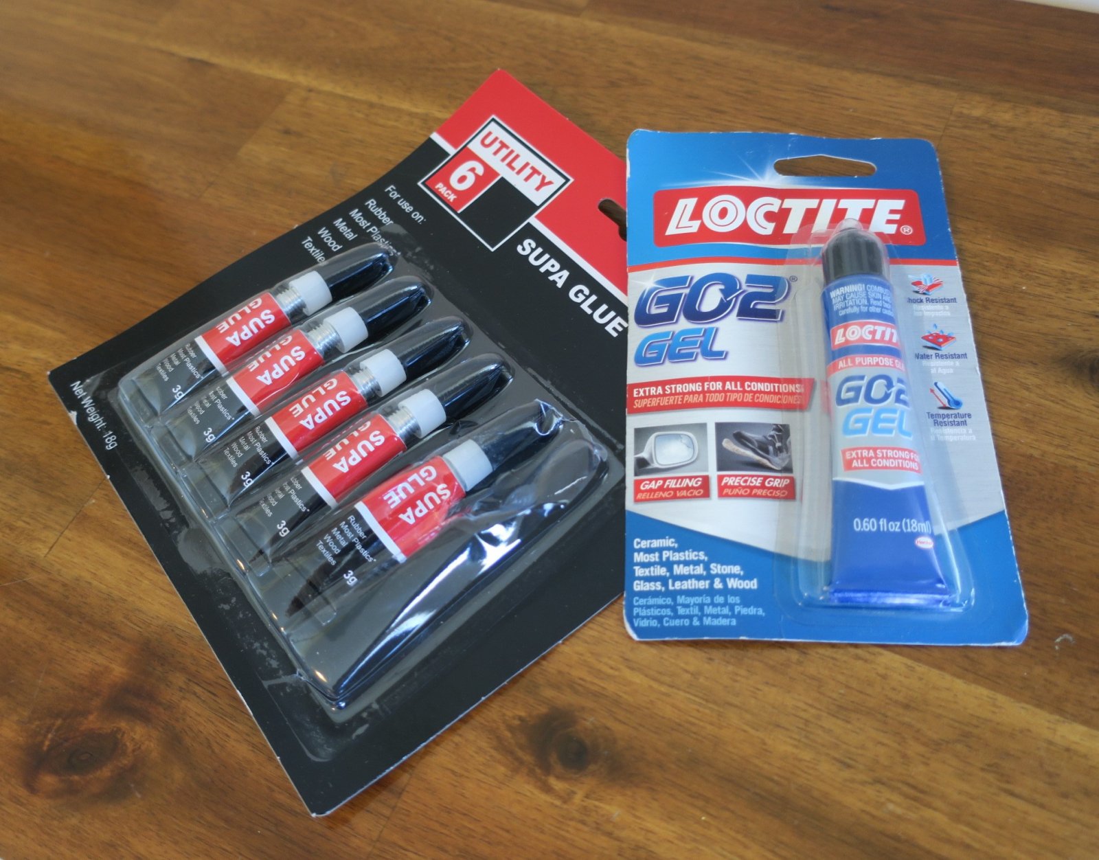

I found ordinary Super glue to be fine but it does help if you can put the repair under pressure with a clamp or weight and leave for 24 hours.
This is the glue, from Bunning's, that I used  It was only a couple of dollars. Being thin it has the advantage that it will flow in to cracks.
Ignore the Loctite GO2728968837_Glue.thumb.JPG.728dcc85f8ed79244fc471f0c804b4d1.JPG
