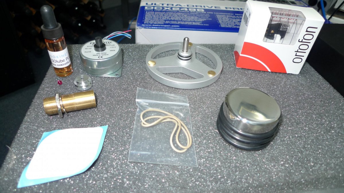

Item: Custom Rega Based Turntable, AudioMods Tonearm, IsoDrive
Location: Tasmania
Price: $3500 Price Drop $3350 & $50 for shipping Australia Wide.
Item Condition: Excellent
Reason for selling: New Project/Build
Extra Info:
This is a complete custom build from the ground up based on a Rega P series design. Raw cost of materials and items was over $6000.
  • Plynth milled from single block of billet alloy on CNC router (around 15kg) Finished in red automotive paint Followed same dimmensions as a Rega P3 plynth.
  • 5x Maglev feet (tried with 3, 4 and 5 configurations and 5 was the best)
  • IsoKinetic IsoDrive Power Supply with 33/45 speed selection
  • IsoKinetic 25mm Acrylic Platter
  • IsoKinetic IsoSub Groovetracer Machined Subplatter
  • IsoKinetic Phosphor Bronze Bearing Sleeve
  • IsoKinetic Ruby Bearing + Spindle Oil (lifetime supply left in bottle)
  • IsoKinetic Puck/Stabiliser
  • IsoKinetic Red Thing Silicone Belt + Spare New One in Packet
  • IsoKinetic MTB-D Motor Thrust Bearing + Motor Isolation Mod for Premotec Motor
  • Premotec 50hz Synchronous Motor
  • Audiomods Series 4 Tonearm with Series 5 bearing, lift and arm hold. Full VTA Adjustment - no VTA adjuster.  All original weights and headshell weights/spacers included to adjust to any cart.
  • Custom Acrylic Dust Cover to accomodate arm height
  • No cart included, but I did have an Ortofon MC25e on it and it was stunning.

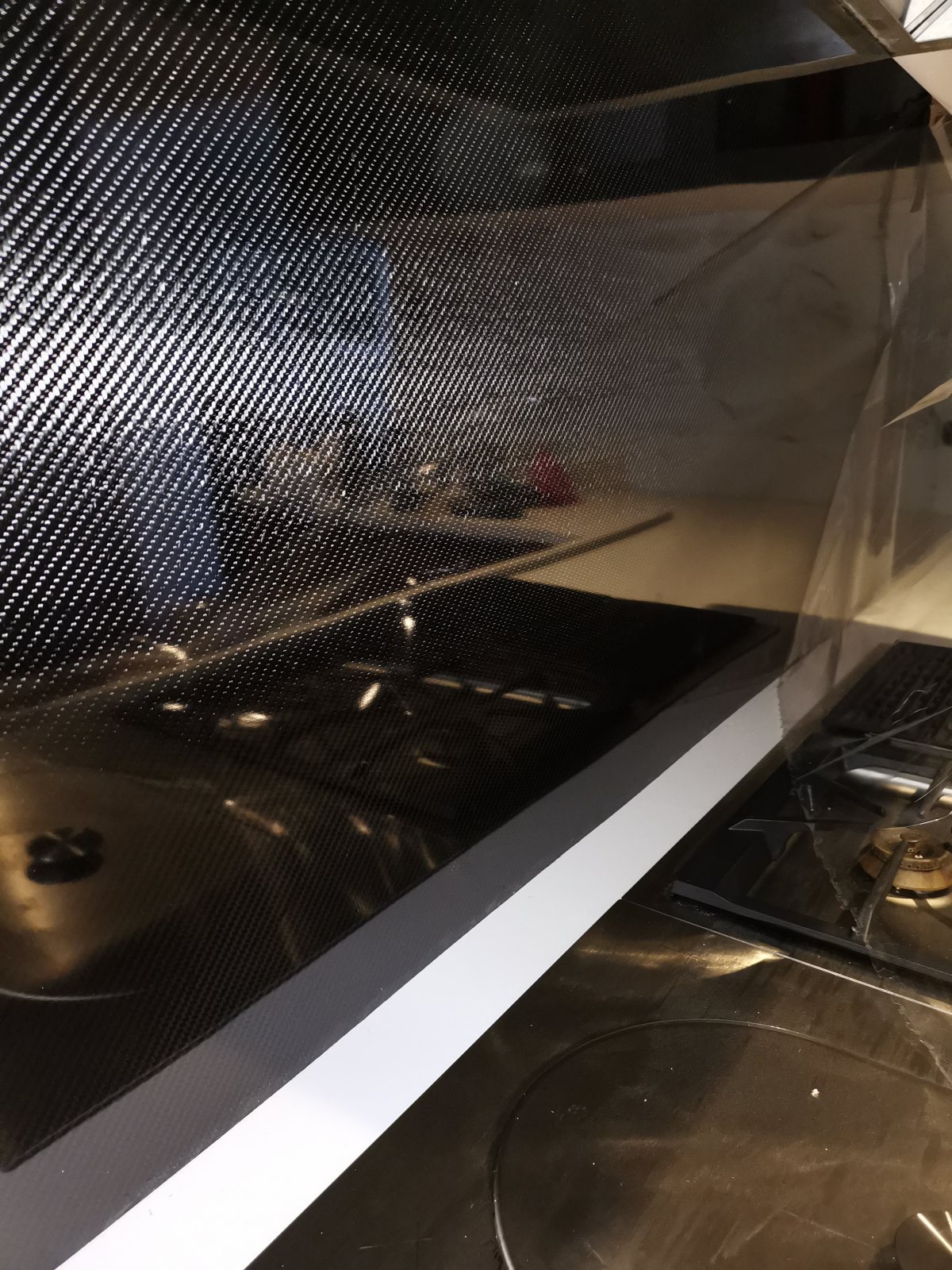

I have played around with composites previously as I love carbon fibre... we made a foam core sandwich with carbon which was super light weight and super strong, but just didnt work for a plynth. Ended up making great kitchen splashbacks though :)
