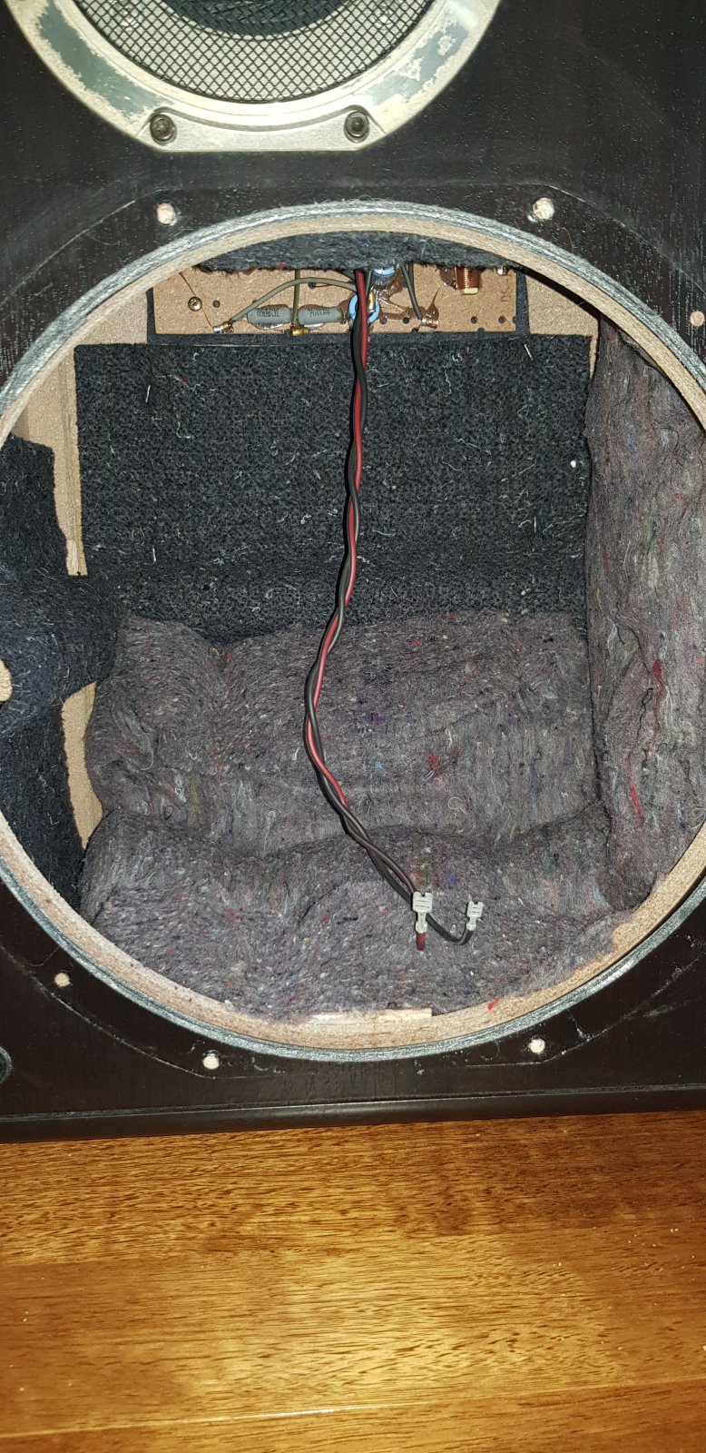

While i was doing some maintenance i thought I'd share some pics of these Japanese speakers.  Would appreciate people's thoughts on opportunities to improve performance etc.
Guest Muon N'
You could replace the iron core inductors with suitable air core inductors, thinker gauge sold copper wire for the mids and bass as appropriate, and replace the electrolytic caps with a poly cap/s metalised poly at least, and rewire with better quality wire. Or just replace the caps for a cheaper option.
Thank you.  I thought the crossover looked less "robust" than i thought it would.
Might look at a custom made cross over design.
Appreciate your ideas.
