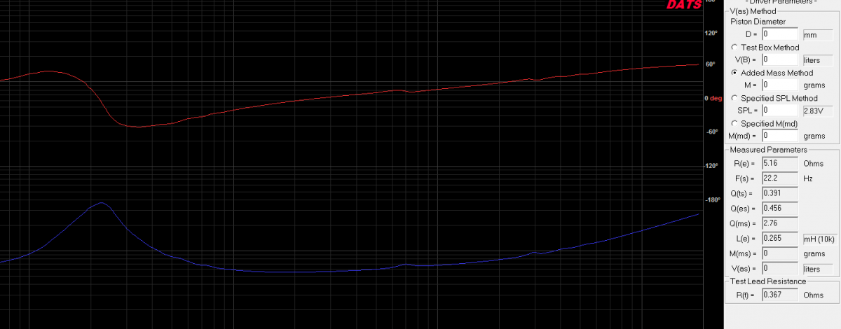

I made some DATS tests and took photos of the drivers.. As I would expect from Scanspeak, they measure very close:
Driver "A"
Driver B:
