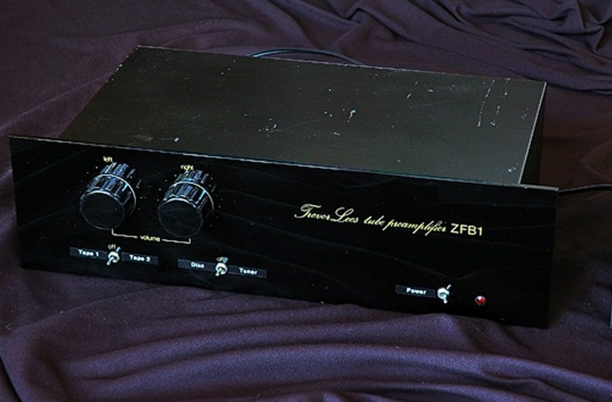

I was searching for a valve preamplifier  to match with my McIntosh 240. Recently found this odd looking unit with someone I know . He was using it only very occasionally and was happy to sell it. Anyway I decided to give it a try. Seller said its a Trevor Lees Audio valve preamplifer. Unfortunately he don't have much detail info about this unit.
- There are only very few switches on the front panel without any labels ( Separate volume controls for left and right channel & two switches with unknown functionality)
- It seems like there are four AUX inputs and one Phono input.
- Caps I could see are Sprague, Seimens, Wonder Cap (Ultima series with Danor).
- Valves from right to left - Zaerix ECC88, Sylvania 6SL7, Zaerix 6DJ8, Zaerix 6DJ8, Zaerix 6DJ8.
- Not sure which make is the volume pot.
- It has got a separate power supply unit ( Power supply unit is a bit noisy when switched on ).
Anyone else here using the same preamplifier (Will be helpful for me to gather more info on this) ?

I owned this model from Trevor Lees for some two decades and was very happy with it. It is his version of a classic 4-tube preamplifier circuit, using 6DJ8/6922/ECC88 tubes (interchangeable); dual-mono construction (2 separate channels); massive power supplies and premium tubes. I had the model with the clear black acrylic top--you could meditate at night on the glowing valves within. Allen Wright had a FVP (Four Valve Preamplifier) preamp too at this time which was popular. Simple circuits, well-executed.
In this era I remember that Trevor L was attempting to duplicate/clone classic pieces of hi-fi gear, such as the Proac Response 2 speakers and ribbon speakers, and some electronics. This preamp was one product of this drive. He certainly had a lot of enthusiasm and flair. I thought of the result as the poor man's high end in Oz. His shop was where the fun was.
The 2 knobs are L and R volume controls. One advantage there is that you can do a little channel balancing if you have a weird room. The phono section accommodated my Sumiko Blue Point (high output MM) and had plenty of gain. I can't recall which switch engaged the phono but there's very few switches to choose from...
The tubes in the photos look original; I ended up using all Telefunken NOS in my model as these were the best sounding ones I had tried up to that point AND in the 1980's were not too expensive! I recall that the Zaerix type came with the preamp--and sounded very good. It's a great platform for tube rolling but that expensive hobby has its limitations and diminishing rewards, as I discovered. Nevertheless you can pick up this tube easily even today (I prefer NOS types myself. Especially Mullard and Brimar).
I recall the sound fondly. It was clear and clean without any gross sins of commission (doing things wrong) and resembled the 'Audio Research house sound' to me (at that time). It did great tone and timbre so I didn't feel like I was missing anything in my system. I forgot about hifi and just listened to the music (remember those days?). It certainly got the best out of my Perreaux 2200B amp running into Celestion 600 speakers. Later I upgraded to the VTL 75/75 running into the Martin Logan CLS. I replaced the preamplifier in due course with a Kebschull 150 model--and that was a real upgrade. Nevertheless, I spent many, many happy musical hours thanks to this Trevor Lees preamp. It was reliable and I ran it for many thousands of hours.
There was one incident when the system was playing and a certain retailer was poking around in the innards of the preamp checking something. He received a nasty electrical shock but I don't think it was a fault of manufacturing. Just noting.
The power supply is not noisy at all--so obviously a service is in order, with attention to the caps (some of which may need replacing by now) and contacts. You *don't* want nasties coursing through your system.
On another occasion I schlepped the massive box containing the power supply and the preamp together to the Mascot airport check-in as I was taking it to Melbourne from Sydney for a service. I didn't want to entrust the delicate innards to the tender mercies of a courier. To give you an idea of the times prior to strict airline security, I actually talked my way onto the flight as there was an empty seat next to me that would hold the box!!  Try that today...now I'm feeling old.
Hope this helps.

I've also had one, I agree with all the above comments. From the look of the knobs, the pictured one is an early production, later ones had larger and more aesthetic knobs
Good ol' Trev was a very smart fellow - with an excellent design pedigree.  :thumb:  (Well, maybe more "an excellent implementation pedigree" - given Dougie says this is his implementation of "a classic 4-tube preamplifier circuit ".)

Thankyou very much for a detailed writing. I really enjoyed reading it.
Seems like I should start with fixing power supply, new valves and checking capacitors. Also,  I'm planning to move both the preamplifier and power supply to a new thick aluminium case with all switches  and input/output marked using laser etching. I think replacing those volume pots with better ones will also benefit the sound.

There are no markings at the rear panel. I guess the input RCA jacks in gold colour near to the ground terminal is the phono input.  Also, at the front panel one switch on top enables all AUX input together and second switch at bottom enables the phono input.  Its confusing as there are no markings for the switches and input/output RCA jacks.
Looking at inside I think two set of RCA jacks on the left side (in above photo) are two different outputs and all other ones are inputs. If so it should be three AUX inputs and one phono input. Correct me if I'm wrong. Anyone of you remember how it is done with those switches and connections at rear?

Unfortunately I'm guessing but my recall is that the inputs I had were labelled. I was a hi-fi newbie and I had few issues. It won't take much to discover the phono input as it would be the only one to produce sound from the turntable output leads. The rest are 'interchangeable' as I recall.
You have correctly designated the back panel as far as I can remember.

Talked to Trevor and finally met Chris from Trevor Lees Audio at their office in Hawthorn,  Melbourne.
- This unit has got 3 high level(AUX) input and one MC phono input.
- Input impedance is set at the terminals with a fixed resistor ( Can be anything from 10 ohms and up to suit the cartridge. .3mv and up is a suitable output for the MC stage)
- Two switches on left are for selecting the input. Centre position is off, up and down positions on each selects different inputs.
- 12AX7 valve can be used instead of 6SL7 valve by using an adaptor.
- Originally there is a front panel and it is missing in the unit I have. They may have the front panel in their storage.
Will get this unit and power supply fully checked and serviced by Trevor Lees Audio :)

Here's a pic of one of Trevor's other preamps (from an SNA ad).  The design of all his amp cases was similar - a bit clunky and never truly reflecting the quality of the electronics.  Even if they can find an original front plate, you might be better designing and making your own.

Thankyou everyone, from your posts I realised the unit is missing the front panel :)
Anyway, I have contacted Trevor. He was happy to give all info about this unit and get the unit checked.
Met his brother Chris in Melbourne....Yes, Trevor Lees Audio office store is still open in Hawthorn near Glenferrie. station.
Chirs helped me to get the unit fully checked and serviced. Also provided a front panel for both the preamplifier and poser supply.
They have got one more same unit sitting in their storage. So if anyone interested do contact Trevor or Chris.
Compared the sound from power supply and found its same on both the units and he said its normal.
At home it was a bit noisy because there was no bushes at the bottom. Chris suggested I can try 12ax7 valve in the place of 6SL7 by using adaptor to get it fitted.
I think it will be good if I'm replacing those two volume pots with good ones. I'm planning to stay with this case for now and plan for a new case slowly in future. Will post photo of the unit here
And it sounds nice.
