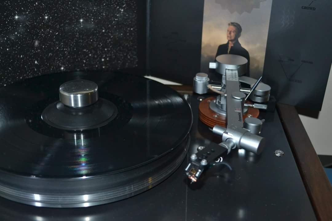

Tweaky Posted November 2, 2019 Posted November 2, 2019 (edited) Yeah, I'd start with a Dynavector cart as well. Depends what your budget is, a DV-17D3 is a great all rounder without being ridiculously expensive, the law of diminishing returns starts hitting hard once you go higher up Dynavectors range. As a different option, you might want to consider a Garrott Bros range topping FGS Ruby, which is almost exactly the same price [would be cheaper to get re-tipped as it would be done by Garrott Bros here in Australia] https://garrottbrothers.com/product/cartridges A few brief reviews of the Garrott. https://www.pressreader.com/australia/australian-hifi/20161101/283639644518286 http://stereotimes.com/cart081402.shtml One thing when you fit the arm, make sure you re-balance the TT, as I know from experience that because the DV-507/5 etc weights so much it can , depending on the TT, lower one side of the rear of the TT. Also fitting a lid over a DV-507 is a, yes you can or no you can't situation, good luck with that. As you probably have found out, it's quite a bit larger than most arms, again depending on the TT usually the rear of the arm protruding over the rear edge of the TT base is the problem.....used to drive me nuts just trying to keep things dust free. Edited November 2, 2019 by Tweaky
