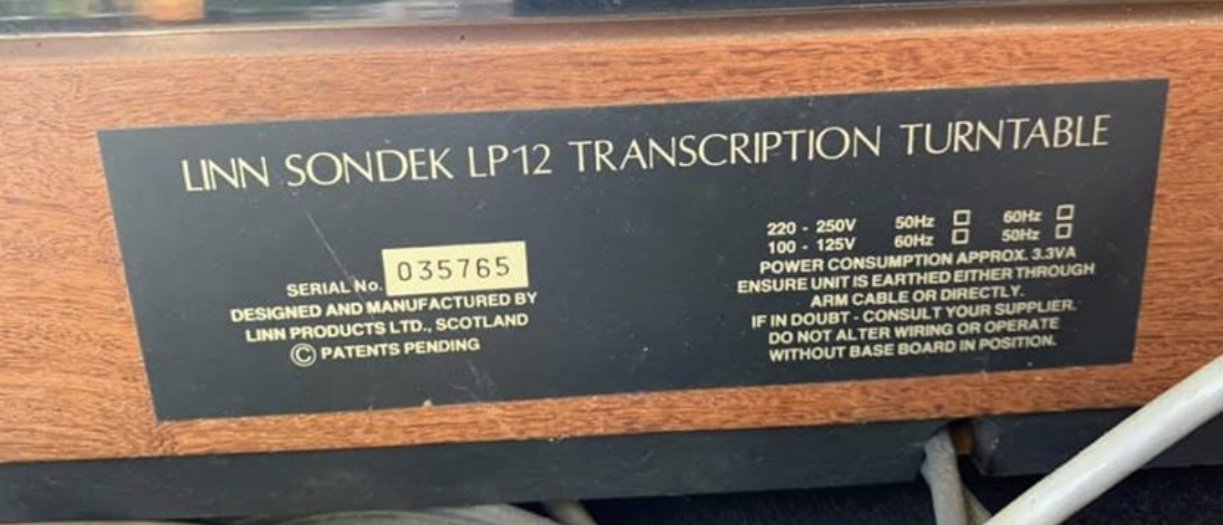

Just bought Linn LP12
I will be picking up this unit this evening. It appears the tonearm is not stock standard. Does anyone know what tonearm is on this LP12?

Going by the serial number looks like it was built between Feb 81 and May 82 - so should have the Nirvana upgrage ( springs bearing) bit not the Valhalla ( thats obvious as it has the red switch) the arm is the original Basik - the less expensive of the two Linn arms at the time
