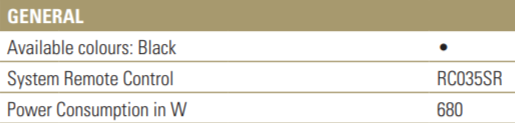

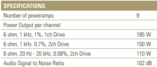

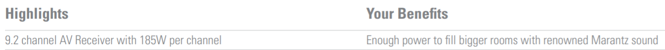

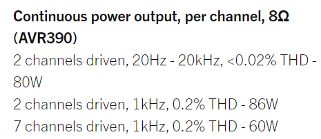

Guest Posted November 6, 2019 Posted November 6, 2019 (edited) On 04/11/2019 at 8:43 PM, MaxPlumage said: It's part of Denon's 70% power guarantee usually reserved for Marantz. Basically they guarantee 70% of watts delivered of 2ch specs, when all 5ch are driven. I am sorry to say that this is marketing spin, designed to make owners feel good. If 70% was real, they would be publishing in the specs for 5 channel driven. Let me use a Marantnz SR6014 as an example of how marketing spins the story and how it compares with an Arcam AVR390, costing twice as much. The Marantnz SR6014 screenshots used were taken from here https://www.qualifi.com.au/media_content/media/product-info-marantz-sr6014.pdf Note the 185W is 6 ohm at 1 kHz, 1%THD 1 Channel driven. The 110W is the most realistic number and for 2 channels only. And they do not publish a 5 channels driven number. If the marketing spin of 70% guarantee was correct, it would be producing 77W for 5 channels at unknown THD. Note that 185W was used as the first line in the highlights. WOW, look how much power it can produce Interestingly, Qualfi used the 110W number on their website page The total power consumption is 680W. With 9 channels at 50% efficiency for a Class A/B amp, this works to 38W per channel. Now IF they are using Class D amps, which they would likely trumpet in their spec sheets (but I did not see it), efficiency would be 80%, making the number 61W. This is still lower than the 70% guarantee of 77W. Let's contrast it with the Arcam AVR 390, their lowest model capable of only 7 channels. Screen shots taken from https://www.arcam.co.uk/products,FMJ,AV-Receiver,avr390.htm#techspecs Note the 7 channels number producing a measly 60W. What a power hog this box is and must cost a lot of money to run. If you divide the 1,500W by 7 channels at 50% it would be 107W. There is a reason why the Arcam cost twice as much as the Marantz and the clue is in the amps and how much power it can produce. Many companies publish misleading power numbers. Use the multiple channels driven if available. Otherwise, use the total power consumption as a better indicator of how much power an AVR can produce. ----------------- I hope this explains what to look for when selecting an AVR. And I am indeed sorry to deflate the various owners... Edited November 6, 2019 by Snoopy8 Typo, messed up formatting
MaxPlumage Posted November 6, 2019 Posted November 6, 2019 I am sorry to say that this is marketing spin, designed to make owners feel good. If 70% was real, they would be publishing in the specs for 5 channel driven. Let me use a Marantnz SR6014 as an example of how marketing spins the story and how it compares with an Arcam AVR390, costing twice as much. The Marantnz SR6014 screenshots used were taken from here https://www.qualifi.com.au/media_content/media/product-info-marantz-sr6014.pdf Note the 185W is 6 ohm at 1 kHz, 1%THD 1 Channel driven. The 110W is the most realistic number and for 2 channels only. And they do not publish a 5 channels driven number. If the marketing spin of 70% guarantee was correct, it would be producing 77W for 5 channels at unknown THD. Note that 185W was used as the first line in the highlights. WOW, look how much power it can produce Interestingly, Qualfi used the 110W number on their website page The total power consumption is 680W. With 9 channels at 50% efficiency for a Class A/B amp, this works to 38W per channel. Now IF they are using Class D amps, which they would likely trumpet in their spec sheets (but I did not see it), efficiency would be 80%, making the number 61W. This is still lower than the 70% guarantee of 77W. Let's contrast it with the Arcam AVR 390, their lowest model capable of only 7 channels. Screen shots taken from https://www.arcam.co.uk/products,FMJ,AV-Receiver,avr390.htm#techspecs Note the 7 channels number producing a measly 60W. What a power hog this box is and must cost a lot of money to run. If you divide the 1,500W by 7 channels at 50% it would be 107W. There is a reason why the Arcam cost twice as much as the Marantz and the clue is in the amps and how much power it can produce. Many companies publish misleading power numbers. Use the multiple channels driven if available. Otherwise, use the total power consumption as a better indicator of how much power an AVR can produce. ----------------- I hope this explains what to look for when selecting an AVR. And I am indeed sorry to deflate the various owners...Thanks snoopy for your insights as always. I am sure there is some level of marketing. I got my information from here, which is very compelling though. Infact I'd highly recommend the op to check the article and video at:https://www.audioholics.com/av-receiver-reviews/denon-avr-x3600hTo quote a particular paragraph of interest:"....In the case of the AVR-X3600H, Denon has it listed as featuring discrete high-current amplifiers on all channels delivering 105W per channel (8 ohms, 20Hz-20kHz, THD: 0.08%, 2 Ch. driven). In fact, Denon claims their latest AVR lineup also meets the 70% power guarantee found on Marantz AV receivers. In this case, the AVR-X3600H is guaranteed to deliver 73.5 watts/ch with 5CH driven. Denon engineering supplied us with their test data for the AVR-X3600H showing it was able to deliver 81.9 watts/ch with 5CH driven into 8 ohm loads. How's that for exceeding ones specs?..."The last few lines really got my attention.In any case for what it's worth, I hope you find it useful
betty boop Posted November 6, 2019 Posted November 6, 2019 6 minutes ago, MaxPlumage said: n the case of the AVR-X3600H, Denon has it listed as featuring discrete high-current amplifiers on all channels delivering 105W per channel (8 ohms, 20Hz-20kHz, THD: 0.08%, 2 Ch. driven). In fact, Denon claims their latest AVR lineup also meets the 70% power guarantee found on Marantz AV receivers. In this case, the AVR-X3600H is guaranteed to deliver 73.5 watts/ch with 5CH driven. Denon engineering supplied us with their test data for the AVR-X3600H showing it was able to deliver 81.9 watts/ch with 5CH driven into 8 ohm loads. How's that for exceeding ones specs?..." The last few lines really got my attention. In any case for what it's worth, I hope you find it useful Makes sense doesn’t it ? 5x 73.5= 367.5w but firstly it’s not a 5ch amp its supposed to be a 9.2 Ch amp 2ndly that 73,5w x 5 is flat out isn’t it likely cranked to max nothing left in reserve. Not even considering other amp ch load ... with av amps you want dynamic range power reserves... which is where power amps come in with much bigger power supplies and better heat sinking and not trying to drive so many channels. Most more honestly specd and drive typically 2-5-7 ch max 2
