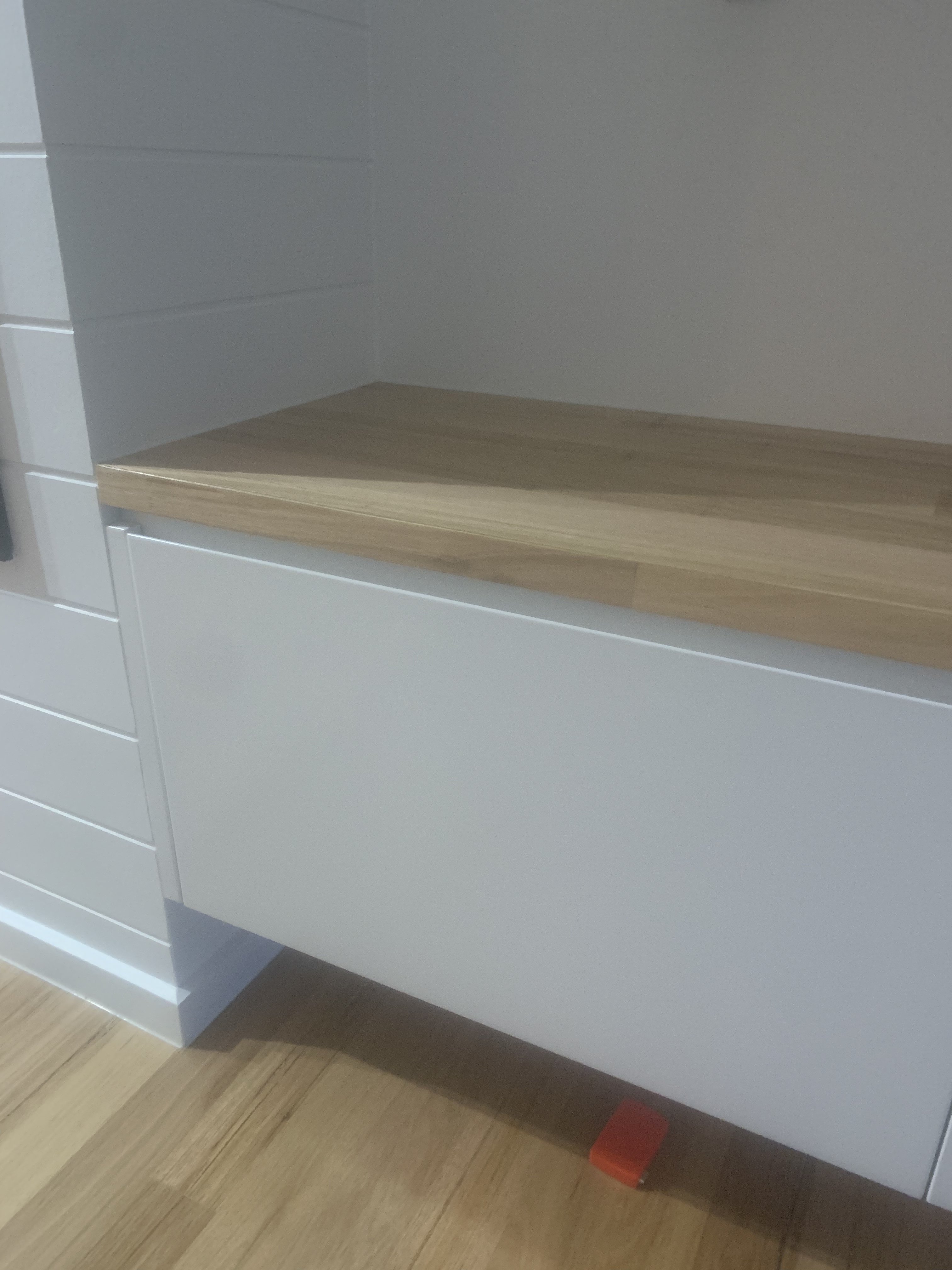

Hi all, ive got a rega rp3 currently with adjustable feet for levelling.
Im building a new wall hung hifi unit and the TT will go on top. See below for plans
it will sit approx 1100mm off the floor to keep out of reach for small kids.
im trying to decide on which option would be better and why, a turntable isolation platform (butchers block on sorbothane pads) or the TT sitting directly on the timber top, followed by some isolating feet.

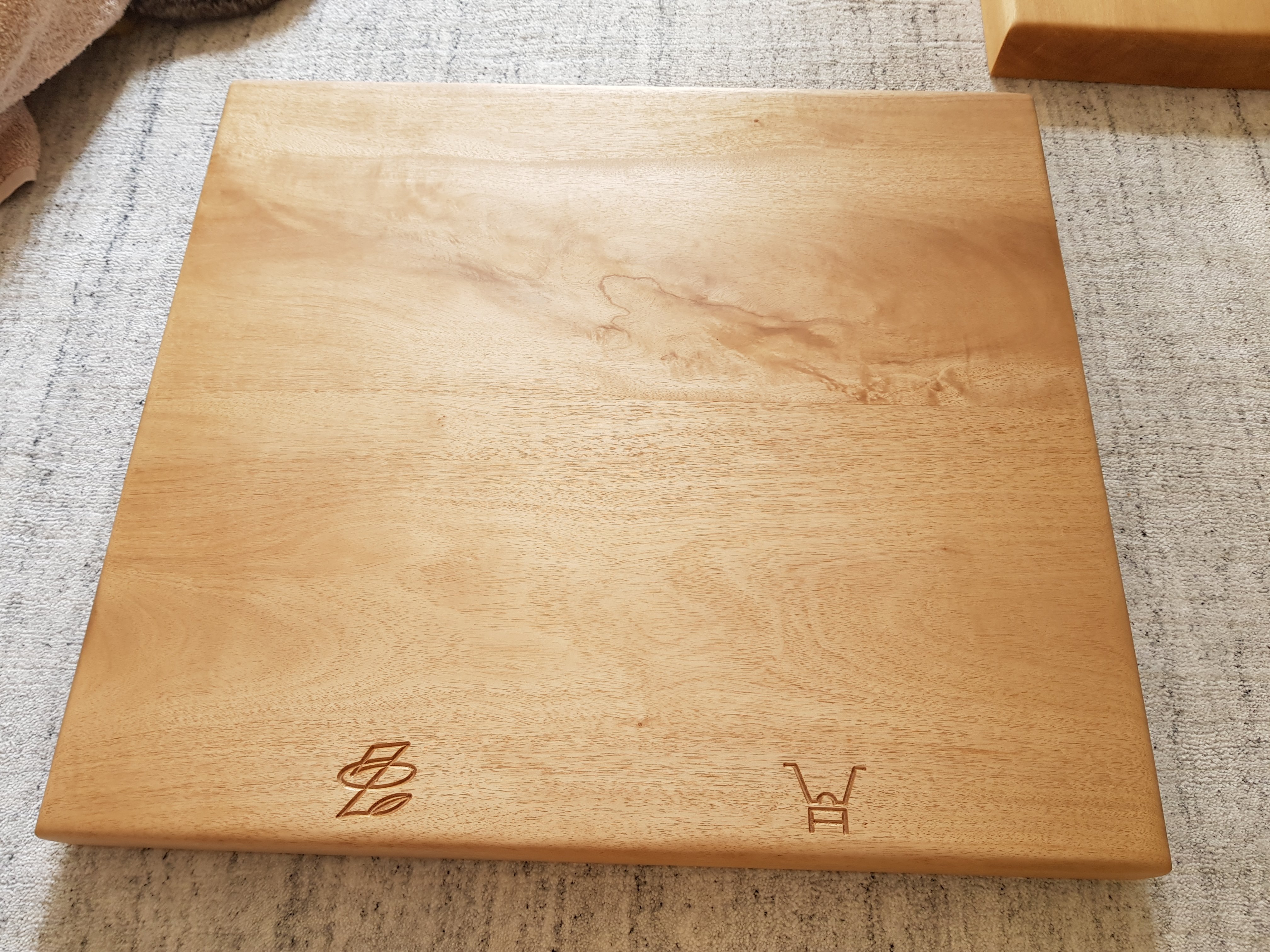

One photo shows another timber top similar to what ill be building, i potentially could try to make this isolated from the hifi unit which will be wall hung anyway.
the tangospinner feet i currently have seem to be isolating but i think i can do better.
Any suggestions are welcome
cheers

@Andrews_melb what “nasties” are you intending to isolate?
If you are hanging the unit on the wall  is the wall timber frame/Gyprock or brick?  If the former and you are fixing to the studs or if brick using dyna-bolts then the unit is pretty well isolated from footfall/human/household interference.  The wooden slab should also provide further natural damping. You might not need any more.
The Windham unit looks nice or perhaps the Ikea chopping block as you mentioned could be compared to simply using the TT as is or with more expensive options.

Cheers @Uglu, i suppose im trying to figure out why one would choose one option over the other, if everything else was equal.
Both options are possible yet id probably only choose one.
my hifi unit will be fixed to the wall, so already doing some isolation.
Link to comment
Share on other sites
@frankn timber studs mate with 240x45 lvl noggs in the wall for this unit.
trying to isolate minor knocks of the hifi unit, say if a kid knocks the hifi unit the TT may get some vibrations running through it. I probably cant completely isolate that, but can try!
also i suppose im not looking at specific ‘nasties’ and your right a but of trial and error will be the go, just wanted to see of people had ideas on iso feet vs butchers block style
cheers

Why are you trying to isolate your system from a solid slab floor....which doesn't have resonance? The slab floor will isolate as good as your cinder brick wall. If you only want to isolate your TT from the rest of your equipment, you should only need a wall shelf for your TT or a decent isolation platform or feet. The rack should be able to sit on the slab floor without issue.....deeming it unnecessary to suspend the entire rack on the wall and leaving only the TT in need of isolation from your other components, ie: a lot less work to achieve the same or similar result.?
Edited by stevoz
Link to comment
To explain further.....I have a slab floor. My TT is isolated from the rest of the system by being on a separate coffee table next to the main system. The (home made) isolation platform it sits on is to isolate it from airborne vibrations from the right channel speaker which sits next to the TT ....not from the floor. Being a slab floor, no vibrations enter the system or TT from the floor.....your situation should be the same. You want your TT to be isolated from your rack, ie: the other components......but the rack doesn't need isolating from your slab floor.?
Edited by stevoz

11 minutes ago, Andrews_melb said:
@stevoz
brilliant thanks, thats what i was after, if isolation not required then no real need for anything too extreme. Was trying to figure out why/if a butchers block set up would help me and appears not.
thanks for that
So now you are only left with the task of isolating your TT from the rest of your components, so a TT wall shelf is probably the best way to go for total isolation.....or.....a butchers block on isolation feet (or sorbothane hemispheres like what's under my iso-platform) under your TT (but still on the rack) for 'not quite' total isolation but better than you have now.....?

Cheers @Juzbear hifi unit is wall mounted and TT is a long way from speakers so should be all cool.
From what @stevoz said and im on the same page, theres not really much to isolate from.
i suppose i should have asked a broad question like: what does every prefer/have tried out of a butchers block style isolation platform (stock TT feet) vs specific isolating TT feet like those funk firm boings
ill just do the wall mount like i planned and see what it comes up like
  • Like 1
