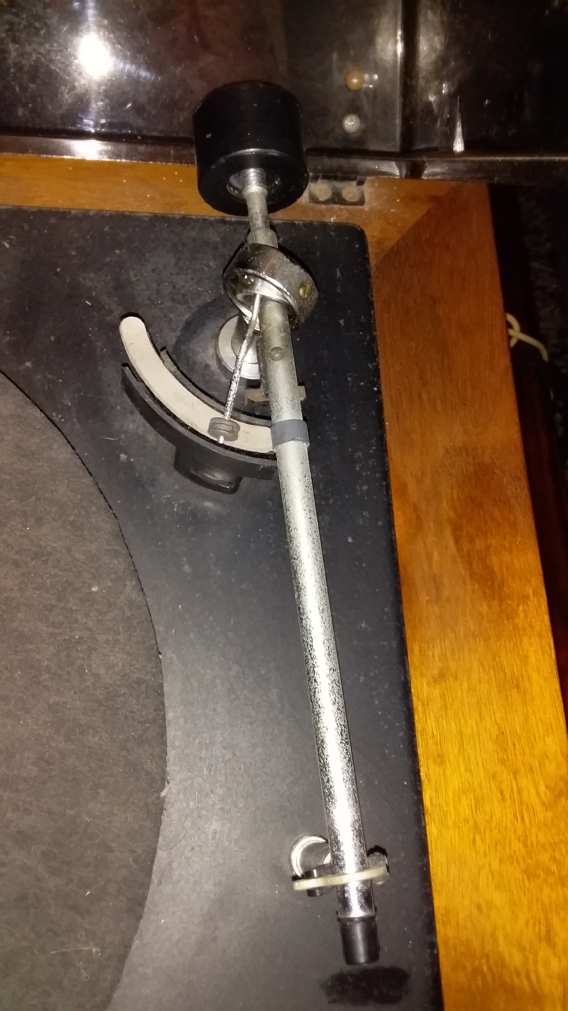

So we've been given a Connoisseur BD2A Turntable by my father in law, and intend to use it for financial and nostalgic reasons.
It however has a little fault where the motor sometimes starts up backwards. It's also missing the head shell, but are these a standard sizing? Other tonearms I've had were all straight through with the head shell as part of the arm...
Does anyone know who would be able to get this going in the south east QLD area?
I don't want to spend a fortune, but also want to see it running again.
Does anyone also have experience changing arms on these tables? It's not a separate arm board like the LP12's, so I assume options are more limited, and I guess permanent once the hole is made bigger..
Cheers for any help/advice
Dan

What arm is on it? Pictures? Is it the the model with suspension? is it the one bolted on a plinth?
Edited by mloutfie
Link to post
Share on other sites
There is a mechanical thing in the motor that stops it starting backwards
It sometimes gets noisey so it's taken out
If you flick the platter clockwise on start it will not go backwards
The start lever does this but it doesn't always work
The headshell is not replaceable with another type
A Grace 707 will be a good alternative

Sorry, Been to busy to get to pictures haha. Its the original tonearm I believe to be a connoisseur piece but you guys would probably have a better idea. The head shell may not be lost, but if it is I take it your suggesting replacing the whole tonearm with a 707? What other arms would fit? SME3009 seem readily available, or would a Rega suit?20190531_194111.thumb.jpg.b223ba6d181932eccc4d90944a14c855.jpg20190531_194005.thumb.jpg.5dce98e394885e119bba1be60258dba9.jpg
Link to post
I think my father in law said the little plastic thing is broken, but he couldn't fix it, but to be honest I hadn't thought about just starting it manually, Being a DC motor I understand they run as freely both directions, so if it's an electrical fault would the manual start of the platter give enough momentum/force to override the motor issue?
You might have to put it outside the plinth for other tonearm. That original  tonearm has quite short spindle to pivot distance. If I'm not wrong it was under 210mm it's definitely a short arm. You can verify this by measuring the distance. A grace 707 would be 222mm pivot to spindle distance
Edited by mloutfie

Hey,
My measurement comes in around 200mm, is there any better arm that can drop in without mutilating the plinth? I found another one cheap with the bits I need, so that could work, but is this table with its original arm comparable to say a rega Planar 3/6 ? I want to get/keep it running properly for nostalgic reasons but also want it to sound good. Would plan to put a DL103 or Ortofon jubilee, would either of these options pose problems for the bd2a in it's standard form?
Link to post
2 hours ago, Gremrock said:
Hey,
The Connie tonearm doesn't keep the headshell parallel to the record by design (automatic anti skating)
So DL103 with spherical stylus will be OK.
Don't use a fine line stylus.
Link to post
Some Japanese (usually CEC) tonearms from 1980's cheaper turntables have short tonearms that would fit, but I couldn't tell you which ones sorry.
The platter bearing is very quiet on the Connie, and the platter is nice 'n heavy so in this regard, it's excellent. The original tonearm is ok, but nothing fantastic, but does sound dynamic (from memory)
Link to post
13 hours ago, Gremrock said:
Hey,
This table is not the same level as planar 3 let alone 6. I have both 3 and bd2(suspended) in the past. I didn't like the small platter for one there is an inch of record end just hang without support. It's a decent starting table but that's about it.
Now back to tonearm project lower end model I think has 200mm pivot to spindle distance (8.6 inch arm) https://www.henleyaudio.co.uk/products/Replacement-Tonearm . You might need to do a bit of work with the chassis to fit the mount but doable.
For cartridge I suggest go to a more basic cartridge like om10 it at95e. Dl103 would be to low compliance and ortofon jubilee would be way overkill for this table not to mention it's really expensive
Edited by mloutfie
