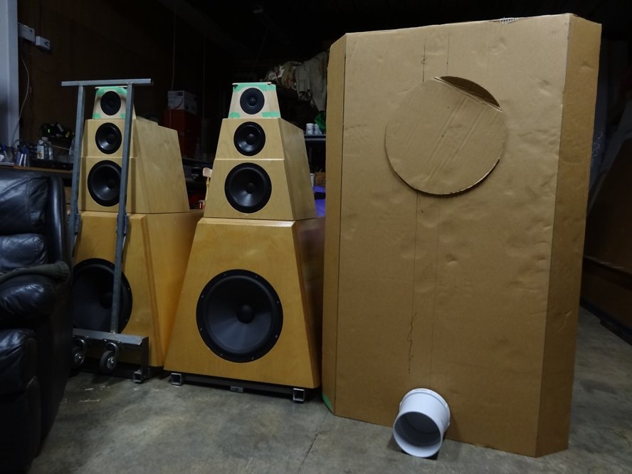

Just a quick announcement that twins were painlessly born today, to a badly-presented but relieved BioBrian and his wonderful StereoNetter cohorts. I'd really like to gratuitously thank all staff, but
It's an odd experience when I find someone referring to something I wrote that I can't remember.   When you compare different kinds of subs, there are two experiences. The first is the easy
Both boxes now all trimmed, ready for final sand and varnish. Don't think I'll need DuraTex after all...   Worst problem has been lack of handles to move them.   110 kg each, so wi
