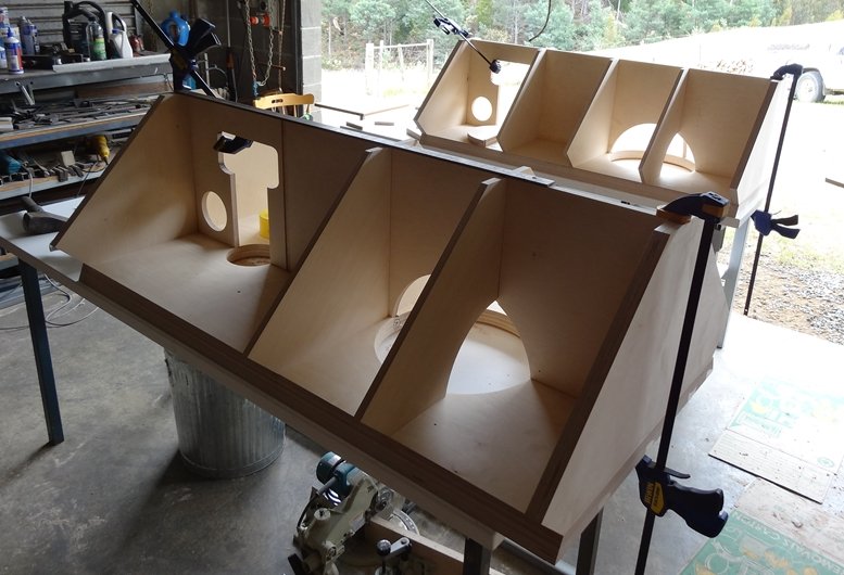

Both boxes now all trimmed, ready for final sand and varnish. Don't think I'll need DuraTex after all...   Worst problem has been lack of handles to move them.   110 kg each, so wi
