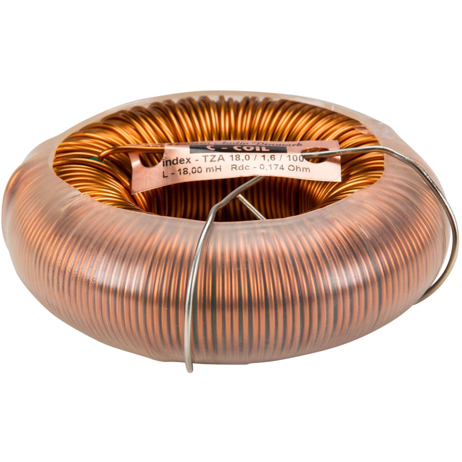

I'm now using power amps of equal gain: driving the 4-ways, and these Subs, from the same preamp. The balance is OK, with all four 15" drivers getting equal oomph. Even Dead Can Dance! ?
The Low Pass filter for these subs is still a birds-nest of coils etc on the bench, at the amplifier end of the speaker cables. It works fine - not much intelligible music gets past them. They just fill in the bottom octave nicely, eg making me aware for the first time that one particular track actually has an organ, which I hadn't realized before. Subtle, as it should be.
So I'm still looking at options regarding LP filters. I read the other day Rod Elliot's  article about PLLXOs, in which he basically said that the concept runs out of usefulness when expecting steeper slopes. Something to do with pushing the impedance limitation - we need to bring in opamps to make passive filters work at 24 dB/octave and above.
So I was pleased to come across the Xkitz site. I don't know why this hasn't been mentioned before, but it would seem just what I've been looking for. Made in California...
https://www.xkitz.com/collections/active-crossovers-and-bi-amplifiers-1/products/linkwitz-riley-2-way-active-crossover-fully-balanced-xover-2b
I could get 2 of these, use only half of each (the LP part), add his LPS in a tidy box, and bingo. No more passive horror stories between amp and drivers! Woohoo!
I know there are some who think it's a waste of time, no EQ, won't integrate properly with 4-ways, etc, and the only way is DSPeaker or miniDSP etc, but I'm still trying to stay anal-ogue for now, and realize the properties of the driver/box design I've chosen.
If anyone can offer helpful comment or experience about the Xkitz gear, I'd love to hear.

Sorry Sam, I never got back to this one. I'll paste the graph from March 6 again here:
1121114901_Box2filtermedleyvent12mH-150uF-1R.thumb.JPG.a982df7d8253ea3cdd697ba0777e943e.JPG
What bothers me with this passive filter thing is the area between 16 and 30 Hz. You'll notice that the Black line (which bears scarce resemblance to the nice WinISD ones, but doesn't include blending with the vent curve) gives the best 20 Hz response. Only by 1 or 2 dB, but why? As I increase the series induction value from zilch to 22 mH, this area suffers more and more. It also increases the difference in volume between 20 and 50 Hz, which is not what I want from all this effort.
Maybe a line-level filter won't do this. Dunno. It may be the reason that I chose 4th order for the 4-way 15" woofers (coil, cap, coil, cap), which kept the mH down for each one, avoiding some of this??
I wouldn't say "waste of time" .....  the subwoofer should be quite flat through the part of the passband where you'll want the low pass to operate .... so that will work (filters like this weren't suggested due to opamps).
Check the speaker impedance ;)
Edited by davewantsmoore
Link to post
Share on other sites
1 hour ago, davewantsmoore said:
Looks almost exactly 12dB/octave to me
I mean the bit that the filter alters: above 50 Hz. 12 dB from 50 to 200 Hz is over 2 octaves, or 6 dB per octave.
The part below 50 Hz should be averaged with the vent output (green line) to be more meaningful. I'll do that when time allows - curious.
Yes, it won't make a 12dB/octave filter here, because of the interraction with the rising/falling speaker impedance.
When the speaker imedance calms down, (eg. >> 200Hz) you can see that it settles into a 12dB slope.

4 hours ago, davewantsmoore said:
adding a decent low pass filter, will be better than what you have now, so it's worth a go.
There have been about 250 views of this thread since I asked the question, and this is all I have to go on.
Are you suggesting the Xkitz crossover would be significantly better than continuing on with my good old passive beasties? (At a few hundred bucks and another bout of nail-biting waiting, it's worth asking the question out straight).
(Anyone else in, for last words? No obligations, no blame, any comment welcome; PM is fine too, if you're shy).
