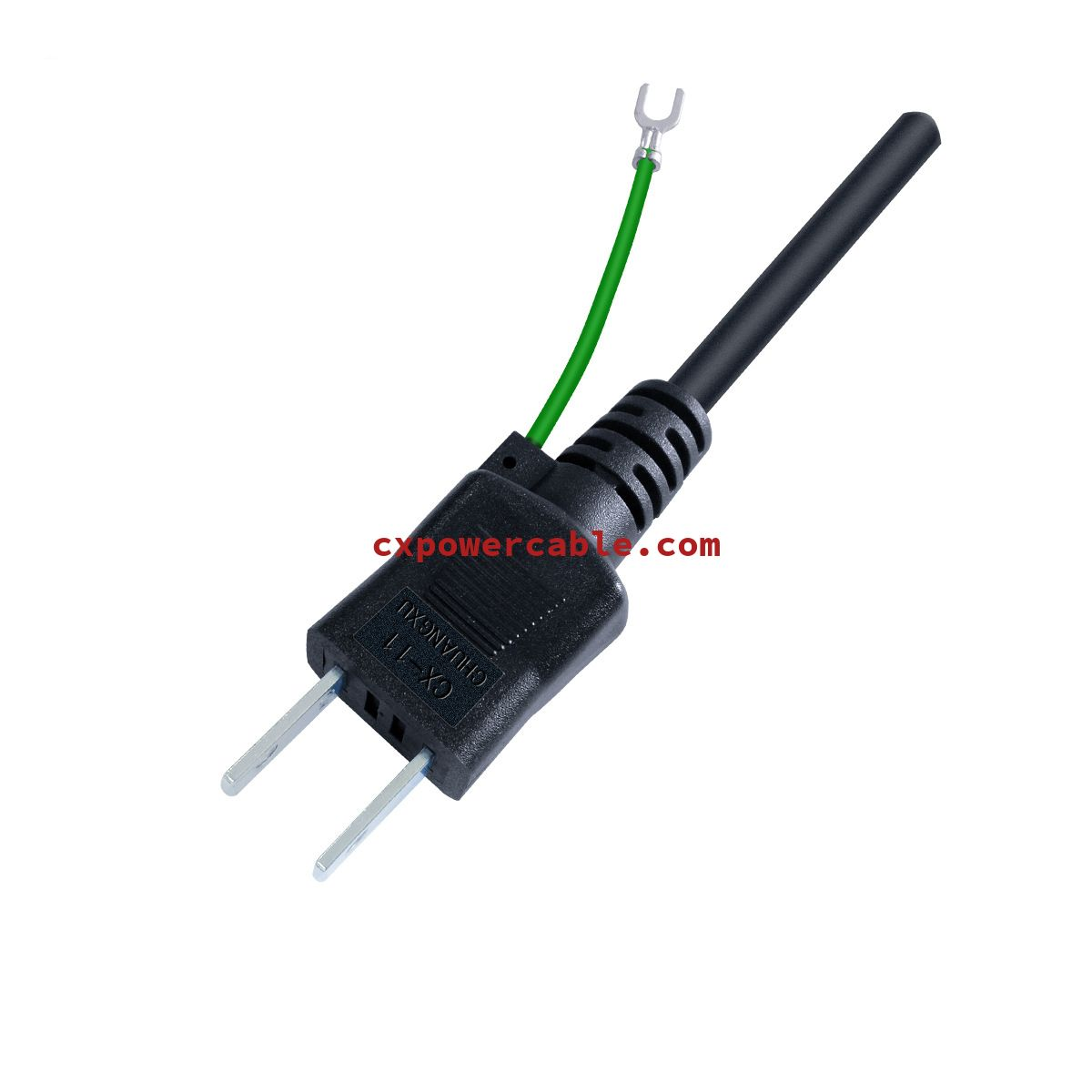

Posted (edited)
Seeking a word of advice.....I have set up my new Japan sourced 100V Technics TT and am about to plug the supplied power lead into the step down transformer but have noticed that there is a small, I assume, ground wire coming out of the 'plug in' end (similar to the example in the photo below) and was wondering if I have to attach that to anything (likely on the transformer) before powering up the TT or if it can be just left as is?
NB: The connector on the end of the wire on my plug has a removable protective plastic cover on it.
Also NB: I also can't see anything on the transformer that I could connect this wire to.....so I am assuming it can be just left as is.🤔
Given that's a 2-pin US mains plug ... it's hard to imagine what that green wire can be connected to, inside the plug!!  :shocked:
Posted (edited)
Well, imagine that it's a Japanese two pin mains plug (which looks totally similar) as is on my new TT, with that wire.....can said ground/earth wire just be left unattached to anything. I'm just not a power expert.😉
Also, my 100V Luxman amps power lead doesn't have one of these wires, I just plugged it straight into the transformer and away I went, so I am assuming that this earth wire can just be left 'dormant'., ie: that the new TT doesn't need to be earthed.
Edited by stevoz
It's hard to say!  Being a wire poking out of the plug ... it really shouldn't be connected to either of the prongs - as you could electrocute yourself!
Your new TT may well need to be earthed - but that green cable won't perfom that task!  :shocked:
Just part of the joy of using US/Japanese gear in Oz!  :smile:
Read the instructions the GR and the G have a switch mode power supply it says,so in the instructions so you don't need a step down transformer as thry work 100v or 240v 50 or 60 Hz.

Posted (edited)
Chris
But I bought it from Japan, so it's a 100V only model....I see no switch.
All I need to know is do I have to use that green earthing lead for anything?
Japan has plug outlets that look similar to this (see below.....ignore the 125V rating on it🙂), where the green wire is attached to the bottom bit to ground it, otherwise most of their appliances have two pin plugs and no green earth wire. I have read that because Japan's voltage is so low at 100V.....most things do not need to be earthed?
Edited by stevoz
Yes - that is the million $$$ question!   (Or should I say ... the life or death question!  :shocked: )
You can prove - or disprove - this by grabbing the end of that green wire, when the TT is plugged into your step-down traffo!  Are you a man ... or a mouse!  :lol:

Posted (edited)
39 minutes ago, cafe latte said:
The turntable does not have a transformer psu it is a switch mode psu. There is no switch you can plug it in to 100v or 240v 50 or 60 Hz the psu deals with it no actual switch.
Google switch mode psus it is automatic.
Chris
The sticker on the back of the unit only mentions 100V, not 240V so I think I'll use the transformer @ 100V to be safe.....so I just not worry about the green wire then? That's still the crux of my inquiry.🙂
Edited by stevoz
The green wire probably goes to the centre terminal of the IEC connector on the power lead, you can test it for continuity with a multimeter set to ohms with the power lead not connected to anything
