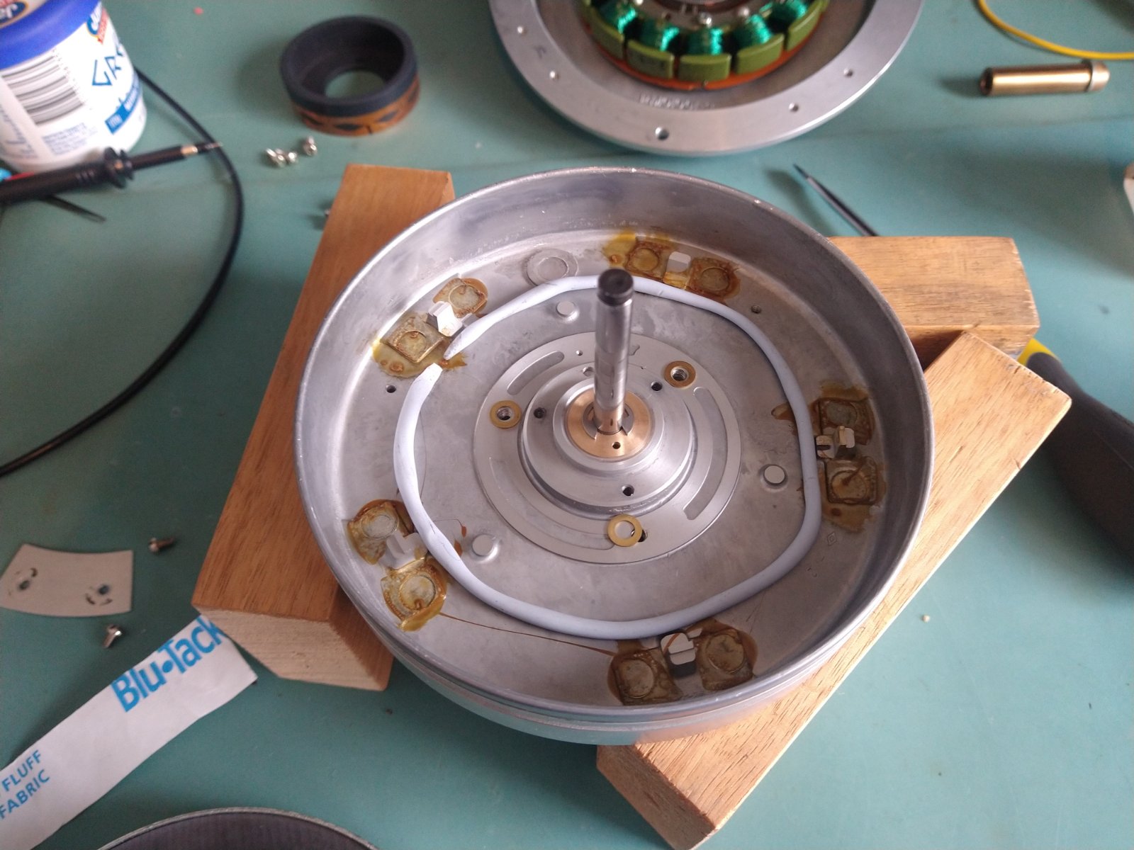

Warren Jones Posted May 31, 2021 Posted May 31, 2021 When I rebuilt one motor I removed the spindle from the rotor. The spindle from the factory is glued into the rotor. To rectify this I made a brass insert, both the insert and spindle are now a press fit. Damping was also added in the form of Blu Tack to both the rotor and motor housing. Next mod is a new 10mm spindle and PTFE bush in place of the bronze. The main reason for this mod is to delete the C clip which reduces spindle diameter and will allow the spindle to flex just above the bearing sleeve.
