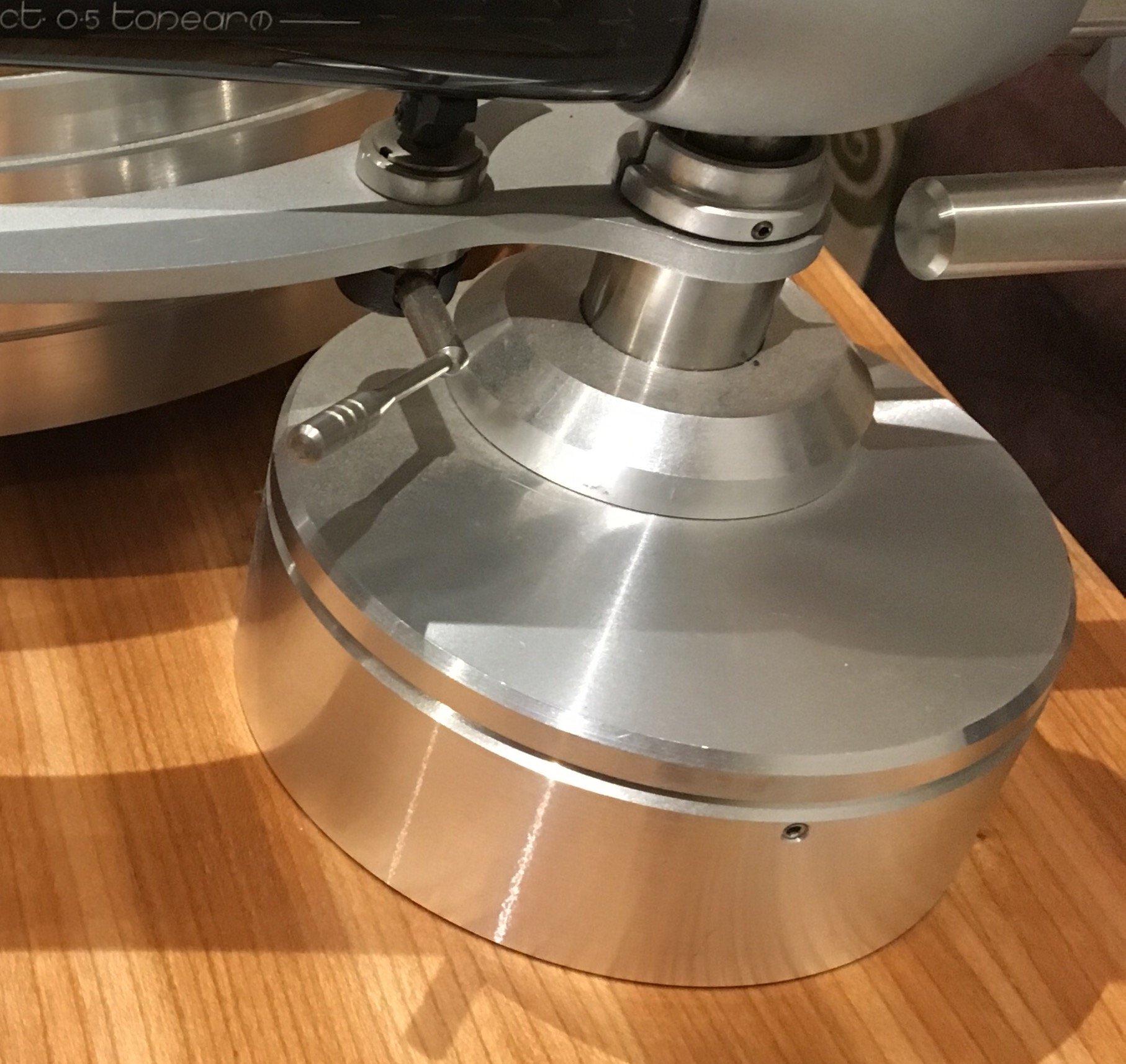

I also need to work out the best way to attach the tonearm to the "puck" as the existing mounting hole is 30mm or so, whilst the Zephyr needs to be much closer to 23-24mm. Sound-wise I am interested to know if I should have a new arm board (puck) crafted from Alu or Acrylic, or if an acrylic 'washer' is an option... or even a metal washer from bunnings??? really unsure what the best sounding way might be. Heck, someone may even be able to create a better threaded VTA widgit for me.... I just dont know???

I’m not familiar with the model of turntable you have, but when it comes to the sonics, the only way you will know which material to use as an arm mounting base is to try and see. The combo of turntable, arm, cartridge, phono stage, cables, etc, and your preference in the sound, will determine whether, alu, acrylic, or whatever is the choice. If you are inclined to experiment, that’s the best way by trying different materials. Origin Live arms are generally very good, so with the right cartridge you should be able to get a great result.

I previously owned an AS turntable.  To deal with the arm mount you could get an internal collar made to reduce the diameter of the hole , made up from a local engineering shop. There should already be a grub screw and this will then need to be a bit longer to insert through the collar to hold the arm in place.

Here is a picture showing the arm mount collar that was created for me.
