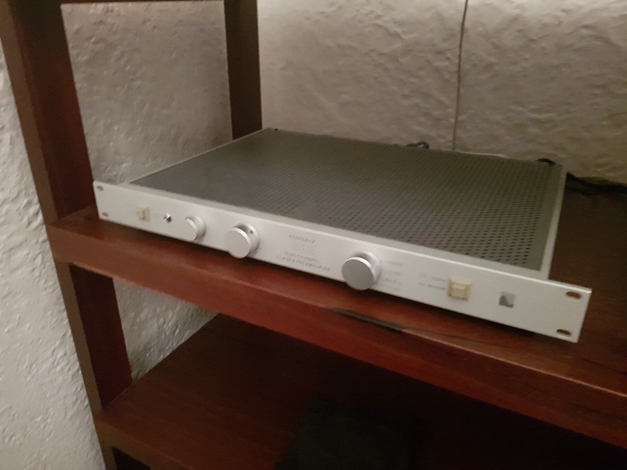

I'm thinking about purchasing a Manley Chinook phono pre but would like some advice on what type of line level preamp to pair it with.
My current system is a Perreaux SM3 pre, Pearreaux 5150b power, Yamaha NS1000's and a Kenwood KD650 TT.
Thanks for your time.

As the SM3 preamp has a vg phono section (even with adjustable resistor loading), are you changing preamp just because you wish to update a few years, or is something the matter?
Hey :)
I've been saving for quite some time for a good seperate phono section. I'm just not too sure the SM3 as a stand alone line level pre would do a phono stage like the Chinook justice.
So yeah just seeking some opinions on that.
Your
Manley Chinook has a massive 60db of gain!.
Your Perreaux PMF5150B only needs 1.5v in to give 500w out!.
The NS1000 need only a few watts to be loud!.
 Can you see where I'm going with this? and there's no preamp in this at all, and you'll have all the gain you need without any preamp.
So what you need is a preamp that has unity gain or very little gain, there is the $699usd Schitt Freya preamp which is three preamps in one so you can change your sound as you please, unity gain solid/state,  low 2.5 x gain Tube, or unity gain passive. The passive "may" and I stress "may", sound a little dynamically flat, as it's not suited to drive into the 5150B's  lousy low 10kohm input impedance.
This is what I would suggest you use. It has everything remote control 5 x inputs 2 x outputs, balanced or single ended, and the best mechanical volume control there is, 128 stepped relay controlled.   https://www.schiit.com/products/freya
