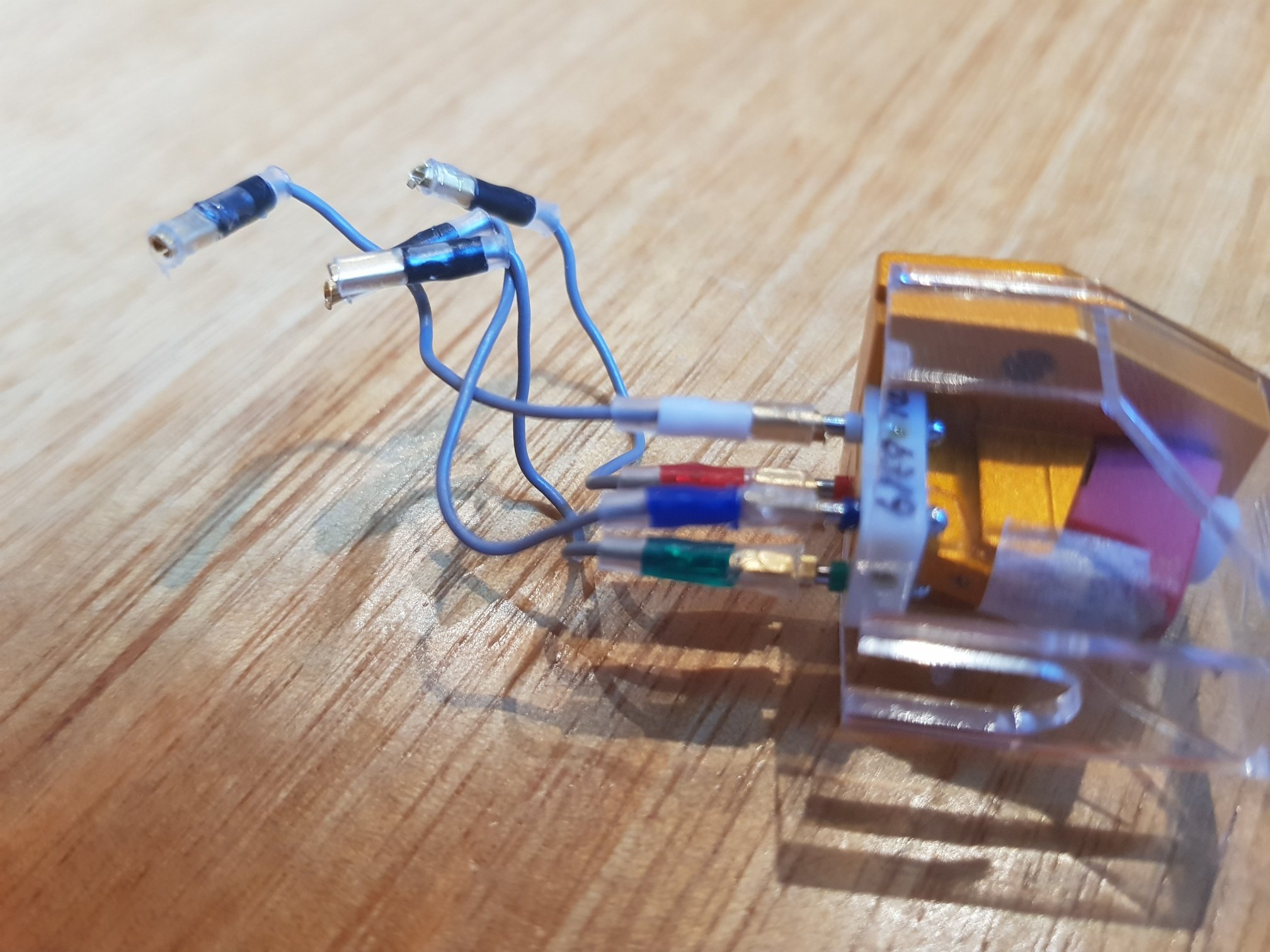

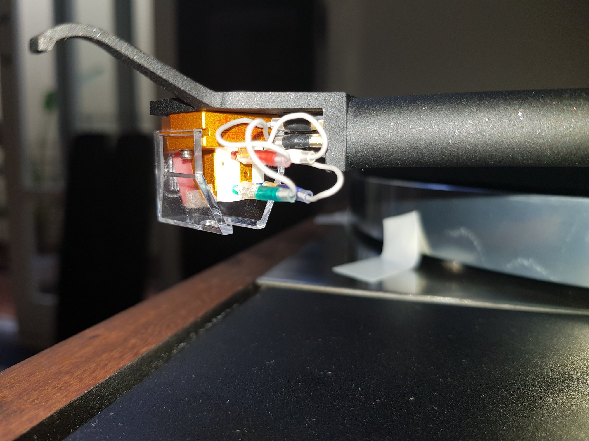

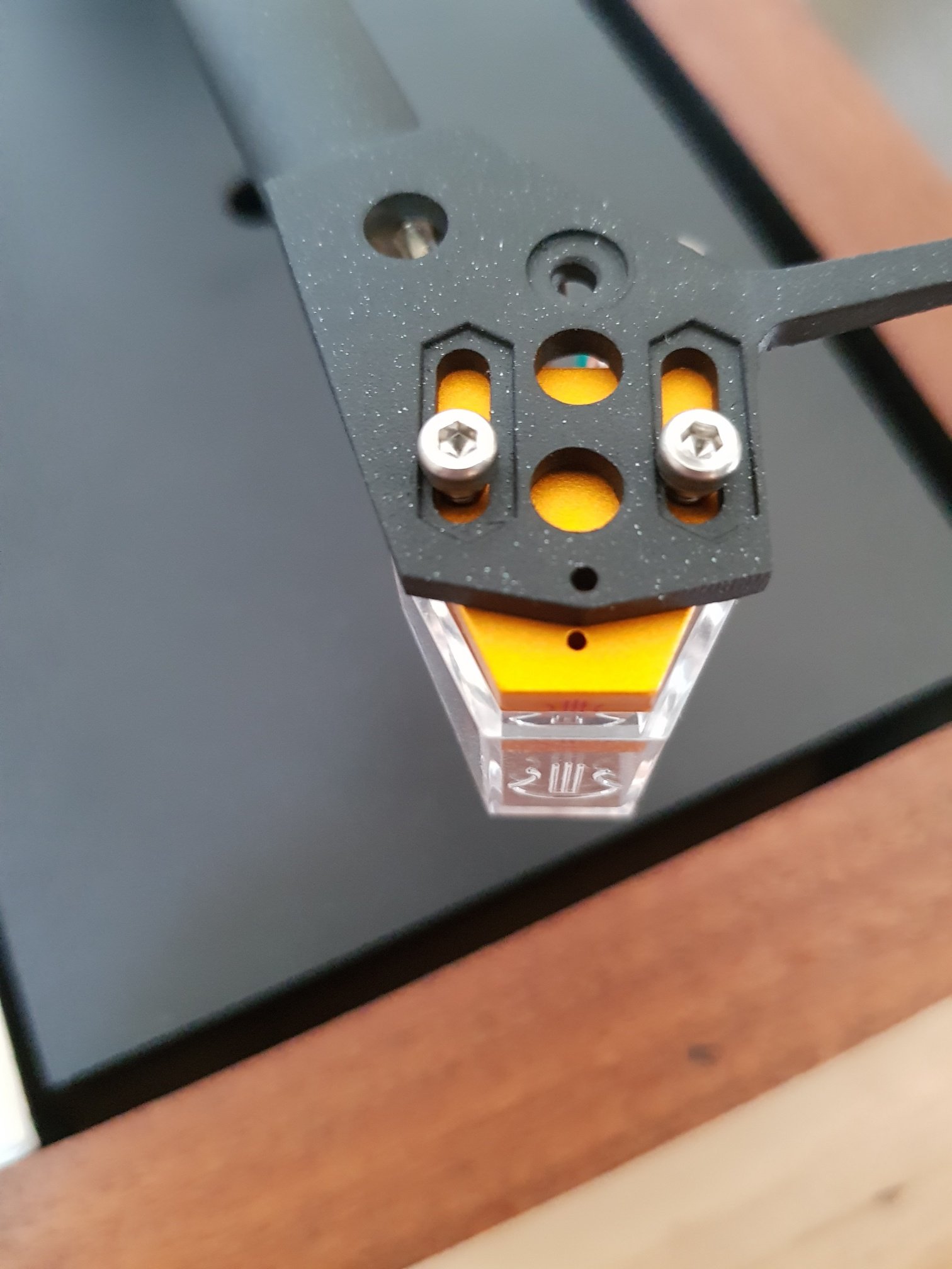

Got the Delos. Trying to fit to Akito tonearm. Tonearm has a little hole at front that apparently lines up with little hole on delos according to info sheet. Apparently makes life easier.
I can see on the Dr F protractor it is clear the cart has to go back so the hole thingy is probably pretty close. Only one problem - the bloody cart cannot go back any further!
It is hitting the wiring of the tonearm. I am sure I have done something wrong but have no idea what.
Help!

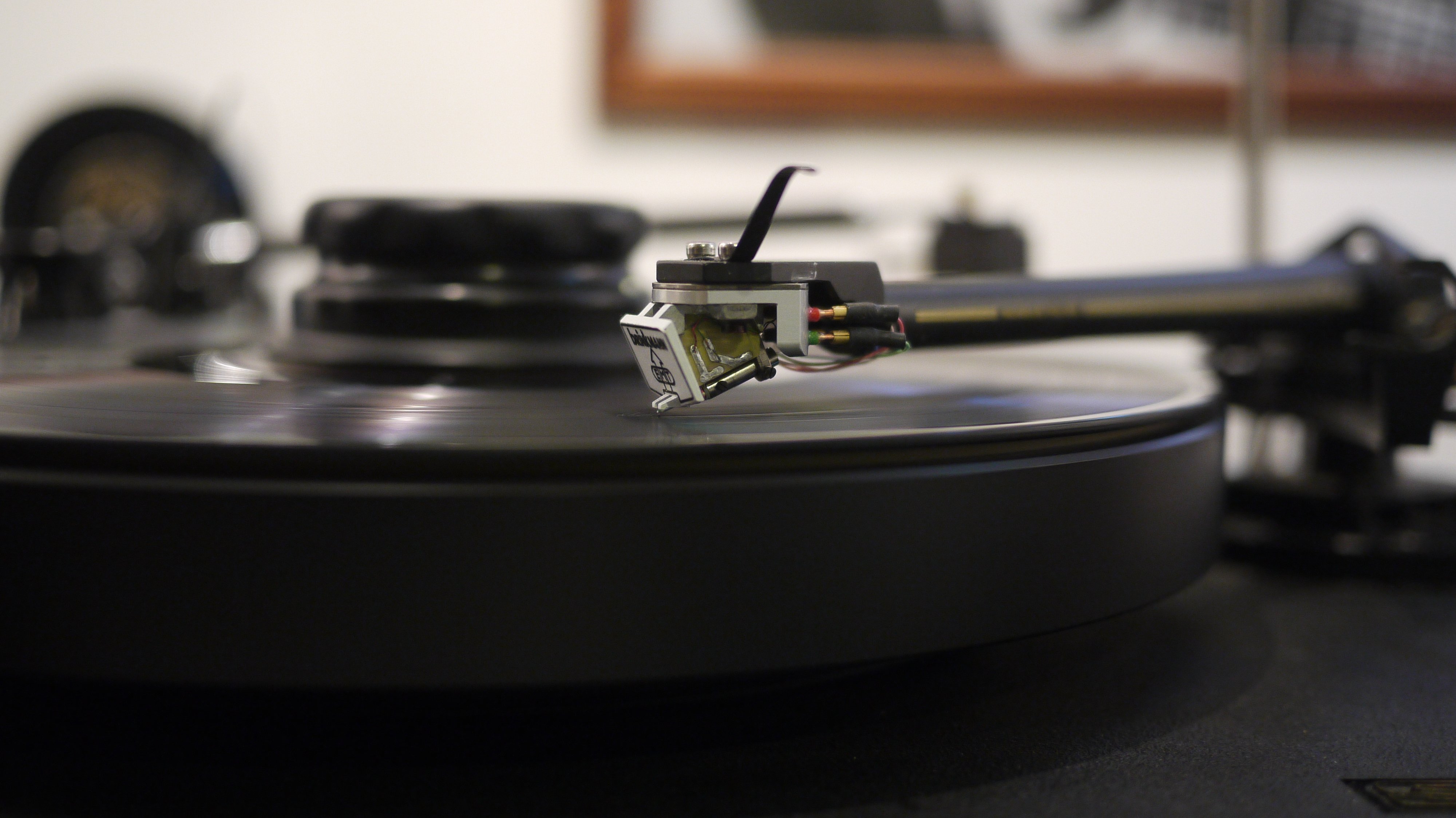

Here's an old pic of a set up I had using an SME arm and you'll note that the terminal jacks are pretty long. Because of the offset angle of the headshell, very similar to your tonearm, you can see that the cartridge really can't impact with the tonearm wiring. Is your P2S distance correct?
Cheers,
Keith

Looking at that pic you've posted, it looks like there are jacks at the end of the tonearm too and they are impacting the cartridge. Perhaps a new set of cartridge wires with smaller terminal jacks, especially at the tonearm side. Sorry I can't offer any better solution.

Appreciate everything Keith. I am thinking same as you though. Cheers, Rod
