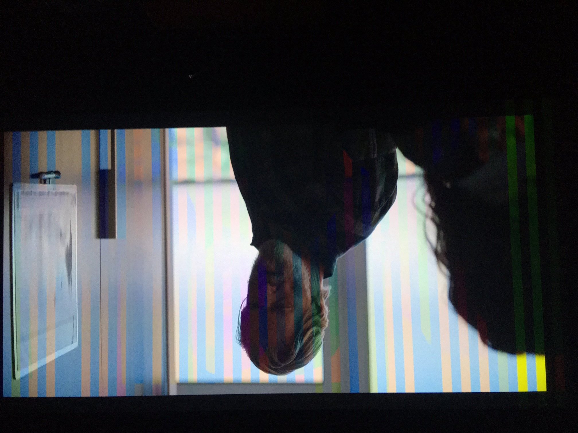

How is everyone’s NX7 going. It’s been a while and mine is going good. Still on my same bulb and only done 400 odd hours. I can remember getting the dreaded pin stripe lines when I first purchased it some years ago. They went away and have never come back. Thinking of doing a JVC auto cal on mine. Not that I see a problem as I am half blind these days. Just wondering how the current state of the NX line is going these days. It’s a good thing to keep tabs on.
My N5/NX5 developed the vertical lines intermittently after about 8 months of ownership. The issue was always fixed with a reboot but became more frequent and I booked it in for repair just before the 3 year warranty expired. Was referred to Pro Hi Tech Services by another repairer and they were great to deal with. DD board replaced under warranty - took a couple of weeks for parts to arrive but only had to drop off for a few days for the actual repair. Can't recommend them strongly enough.
