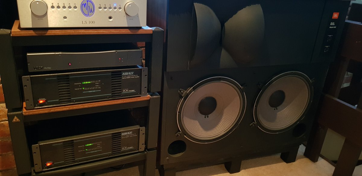

tubularbells Posted January 24, 2019 Posted January 24, 2019 (edited) 49 minutes ago, Pops110 said: @Tubularbells. Runs some I believe. After running a plethora of high end amps (both tube & solid state) i've settled on some 1990's vintage studio amps (Ashly), one for each channel and seriously couldn't be happier. Cheap as chips as pro audio guys no longer want them cos' there too heavy and audiophiles don't know of their existence (yet). Some say pro audio gear was build for survival rather than sound quality but not these. My FET2001 Series 3 were the last of a dying breed where sound quality mattered as much as longevity. Massively overly built and super easily accessible for servicing (none of this remove 100 screws to replace 1 cap crap) these are IMO giant killers. Have a chat with the Ashly guru @knight2001dts and he'll set you straight. Edited January 24, 2019 by Tubularbells 4
anewmission Posted January 24, 2019 Posted January 24, 2019 After running a plethora of high end amps (both tube & solid state) i've settled on some 1990's vintage studio amps (Ashly), one for each channel and seriously couldn't be happier. Cheap as chips as pro audio guys no longer want them cos' there too heavy and audiophiles don't know of their existence (yet). Some say pro audio gear was build for survival rather than sound quality but not these. My FET2001 Series 3 were the last of a dying breed where sound quality mattered as much as longevity. Massively overly built and super easily accessible for servicing (none of this remove 100 screws to replace 1 cap crap) these are IMO giant killers. Have a chat with the Ashly guru [mention=141054]knight2001dts[/mention] and he'll set you straight. These rarely come up in australia. Did you get them here or posted from the US?
tubularbells Posted January 24, 2019 Posted January 24, 2019 Got them from the US with each amp costing under $500. Shippings a killer though due to their weight but still good vale when you see/hear what's on offer. @knight2001dts owns dozens of Ashly's and has done for many years so that's where I heard them first.

anewmission Posted January 24, 2019 Posted January 24, 2019 Got them from the US with each amp costing under $500. Shippings a killer though due to their weight but still good vale when you see/hear what's on offer. [mention=141054]knight2001dts[/mention] owns dozens of Ashly's and has done for many years so that's where I heard them first.I did some research last night ans noticed how similar the internals of this amp are to yamaha pc2002m and the p2200. Which are usually between 1k aud and 2k aud.Which is interesting becausw i love those amps. What transformers are you using? I noticed your model is not switchable from 110v to 230v
knight2001dts Posted January 24, 2019 Posted January 24, 2019 (edited) Hi! thought I would chime in since @Tubularbells mentioned my addiction for these amps in an earlier post That’s one of the good things about these amps - they are easily converted from 120 -> 240v just by moving some spade connectors for the transformer windings around on the internal terminal strip. Even the original 120v fan can run on half the winding..... I have a mixture of the old-school FET series amps which used the 2SJ50 and 2SK135 combo for the output stage.... which comes with the bonus of a negative temperature co-efficient meaning that as they warm up, they won’t thermally run-away - the complete opposite occurs! It is a kind of self-protect (which is why these particular amps didn’t blow output stages often). The later ashly’s use different output devices and also had some protection circuits added, so became a little more complex in design. I have been running my original FET-2000m amps since 1993 without issue - only ever having to use some contact cleaner on the input attention pots and replacing a fan or two. I am going to be re-capping them soon too - caps at the ready!! Great amps for the $ and buckets of power from the massive transformer and cap (2x15000uF) combination...... cheers! Edited January 24, 2019 by knight2001dts Typos on stupid phone 1
anewmission Posted January 24, 2019 Posted January 24, 2019 Hi! thought I would chime in since [mention=122789]Tubularbells[/mention] mentioned my addiction for these amps in an earlier post [emoji14] That’s one of the good things about these amps - they are easily converted from 120 -> 240v just by moving some spade connectors for the transformer windings around on the internal terminal strip. Even the original 120v fan can run on half the winding..... I have a mixture of the old-school FET series amps which used the 2SJ50 and 2SK135 combo for the output stage.... which comes with the bonus of a negative temperature co-efficient meaning that as they warm up, they won’t thermally run-away - the complete opposite occurs! It is a kind of self-protect (which is why these particular amps didn’t blow output stages often). The later ashly’s use different output devices and also had some protection circuits added, so became a little more complex in design. I have been running my original FET-2000m amps since 1993 without issue - only ever having to use some contact cleaner on the input attention pots and replacing a fan or two. I am going to be re-capping them soon too - caps at the ready!! Great amps for the $ and buckets of power from the massive transformer and cap (2x15000uF) combination...... cheers!Wherw abouts in australia are you? Im considering buying a few
knight2001dts Posted January 24, 2019 Posted January 24, 2019 I’m in Melbourne..... if you’re considering buying some to try, you are probably better to try and get your hands on something like the later FTX series amps as parts are easier to find if needed (especially output devices). They show up quite frequently on EBay and some of the pro-audio marketplace sites in the USA... shipping is again the real killer and can often be more than double what you pay for the amp itself. Don’t fuss too much about physical condition as they can be sprayed up easily and also will probably get a bit bent when shipped. As long as it is all there, and working - maybe ask for a photo or two with the lid off to see if the output devices are all original and not aftermarket subs. cheers!
anewmission Posted January 25, 2019 Posted January 25, 2019 I’m in Melbourne..... if you’re considering buying some to try, you are probably better to try and get your hands on something like the later FTX series amps as parts are easier to find if needed (especially output devices). They show up quite frequently on EBay and some of the pro-audio marketplace sites in the USA... shipping is again the real killer and can often be more than double what you pay for the amp itself. Don’t fuss too much about physical condition as they can be sprayed up easily and also will probably get a bit bent when shipped. As long as it is all there, and working - maybe ask for a photo or two with the lid off to see if the output devices are all original and not aftermarket subs. cheers!Just out of curiosity have you ever heard a yamaha p2200 or pc2002m? If so how would you compare the ftx series?There is a guy with 4 series iii amps on ebay usa.Led vu metres definitely dont look as nice as analogue ones. But still having any vu metres is better than none.
knight2001dts Posted January 25, 2019 Posted January 25, 2019 Sorry I haven’t heard the Yamaha’s you mention, but AFAIK they are transistor output stages? The difference in audio between a MOSFET output stage and a transistor output stage is quite significant.... To my ears at least, the MOSFET output stage has a more valve like sound where a transistor output stage has a much brighter (and when using my jbl horns) and harsher top end. Probably best to have a listen to a mosfet amp first to see if it is the sound you’re after? cheers
anewmission Posted January 25, 2019 Posted January 25, 2019 Sorry I haven’t heard the Yamaha’s you mention, but AFAIK they are transistor output stages? The difference in audio between a MOSFET output stage and a transistor output stage is quite significant.... To my ears at least, the MOSFET output stage has a more valve like sound where a transistor output stage has a much brighter (and when using my jbl horns) and harsher top end. Probably best to have a listen to a mosfet amp first to see if it is the sound you’re after? cheersYeh the yamahas have amazing mids. I like to listen to rock sometimes and it really makes distorted guitars sound chunky and how they should be. Just like mesa boogie guitar amps, its all about the mids with heavy rock.I do see the ashlys are 0.1%thd and the yammies 0.05%. Whether there is actually much of a difference in hearing this im not sure.You should also check out either the p2200 or pc2002m. Id be interested to hear what you think considering both the yammies and ashlys are used in studios.If the ashlys werent so ugly i would have ordered them allready haha. I wonder how difficult it would be to replace the front plate with some noce big vu meters
knight2001dts Posted January 25, 2019 Posted January 25, 2019 I quite like the VU meters on the Ashly but that’s just me There isn’t a lot of space behind the front plate to put meters as the modules run nearly full length and in front of the transformer is about the only space left. You would have to have the panel laser cut to put meters in but you could possibly get away with some smaller ones. I see that one of those 4 FTX sIII amps has now sold - did you take the plunge? They have been sitting there for a while - the shipping on those is extremely high. cheers!
anewmission Posted January 26, 2019 Posted January 26, 2019 I quite like the VU meters on the Ashly but that’s just me [emoji4] There isn’t a lot of space behind the front plate to put meters as the modules run nearly full length and in front of the transformer is about the only space left. You would have to have the panel laser cut to put meters in but you could possibly get away with some smaller ones. I see that one of those 4 FTX sIII amps has now sold - did you take the plunge? They have been sitting there for a while - the shipping on those is extremely high. cheers!No i havent jumped on one yet. The seller would not give me a definitive answer on shipping prices. There are a few for sale in japan also. I wonder if the shipping from japan would be any cheaper. These amps seem to come up alot in multiple units. I guess they are being used in concert halls and cinemas
