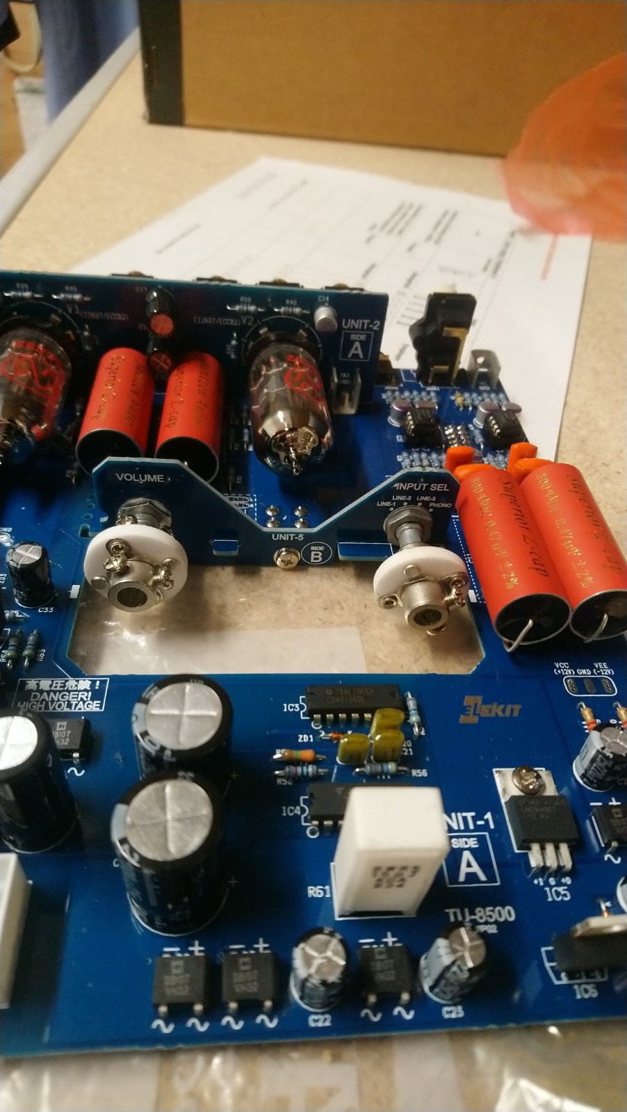

mach1 Posted February 19, 2021 Share Posted February 19, 2021 (edited) Don‘t know who told you the T7 was a low mu version of the U7, but it actually has about 3 x the gain. It is a totally different animal, a lot more like a 5965, and not a direct sub for a U7. Due to this characteristic, T7’s were more often assigned to phono duties while U7’s looked after the line. I saw another review of this pre where a guy subbed in a T7 simply stating it was a lower noise version of a U7. This is utter nonsense. Moreover, it is highly unlikely that this tube’s bias points would have been optimised after simply plugging it in. Output impedance would also have increased (which may or may not be significant). Both these issues lead me to seriously question his credibility as a reviewer. All 12A variants would work in that socket, but....... . Personally, i would stick to U7’s from a reputable source. Your Psvane's sound like a really good option. Hope this helps. Edited February 19, 2021 by mach1 more info 1 Link to comment Share on other sites More sharing options...

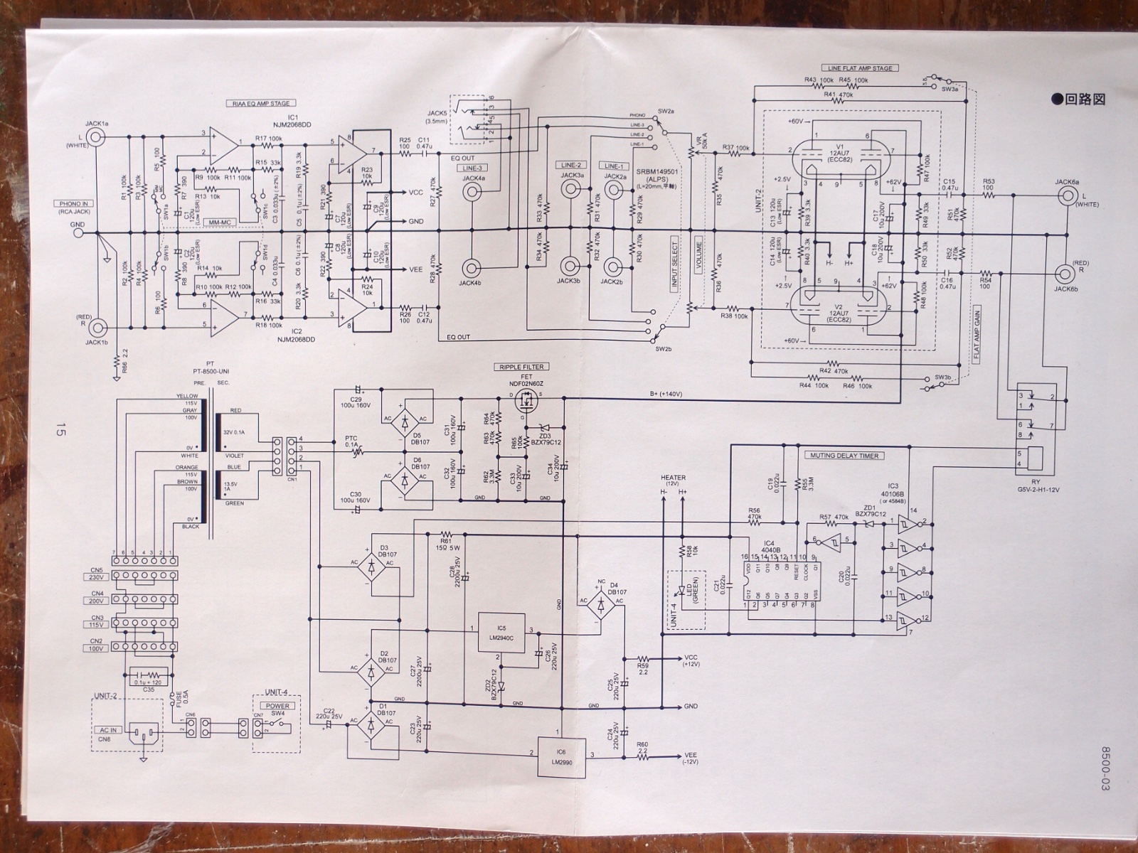

Lightstream Posted April 25, 2021 Author Share Posted April 25, 2021 (edited) On 19/02/2021 at 11:51 PM, mach1 said: Hi thejt, I have a very strong suspicion there is a low impedance mosfet follower output stage on the right hand board (the signal would go through just this when gain = zero), otherwise you are looking at an unbuffered 7K anode follower output impedance, which I don’t think is possible (ie it’s a hybrid linestage). This would drive just about any amp with contemptuous ease. Here is the circuit diagram, the only FET is in the power supply as a ripple filter, no other buffering. This pre-amp still runs as quiet as the day I put it together, the Psvane 12AU7-Ts as well; they've had several years of use now, 2 1/4 yrs in this pre-amp and another 3 or so in my TRI TRV-88SE integrated amp. It hasn't been a constant thrashing, as such, but no doubt a good couple of thousand hours + all up. I may consider upgrading a few parts yet, possibly the power supply caps for Nichicon KG Gold Tune versions, or similar (they have been stunning in my restored 1977 Perreaux SP100 pre-amp, dropping the noise floor to so low it's not worth even listening for it at full volume and allowing for a new level of bass depth and impact, as well as a more 3D sound stage and dimensional vocals with a new silence around them). In the Elekit TU8500, I have Mundorf polypropylene caps in the Line stage and good quality polyester caps from from output of the phono stage, so I may move the line stage caps to the phono output and replace them with higher level Mundorfs. Just a thought at this stage. As a pre-amp to the hotrodded Silicon Chip headphone amp - with other mods in-between - the results are superb with the venerable Sennheiser HD540 Reference 600 ohm headphones, which have their own upgrades in Mogami cable and pleather pads. Edited April 25, 2021 by Lightstream Link to comment Share on other sites More sharing options...
Addicted to music Posted April 25, 2021 Share Posted April 25, 2021 From the diagram, the FET is used as a constant current source for regulation on that supply line for 140V Like the way it uses OP amps for MC/MM 1 Link to comment Share on other sites More sharing options...
Jason Påstorål Posted August 6, 2021 Share Posted August 6, 2021 PSA: I emailed Elekit directly to inquire about the output impedance of the Elekit TU-8500 and this was the response from EK Japan Co LTD: Regarding your question, the output impedance of TU-8500 is approximately 200ohm when with 12AU7. It can slot right in to any chain with ease. Link to comment Share on other sites More sharing options...
RoHo Posted August 6, 2021 Share Posted August 6, 2021 Cathode follower final stage = lower output impedance Link to comment Share on other sites More sharing options...

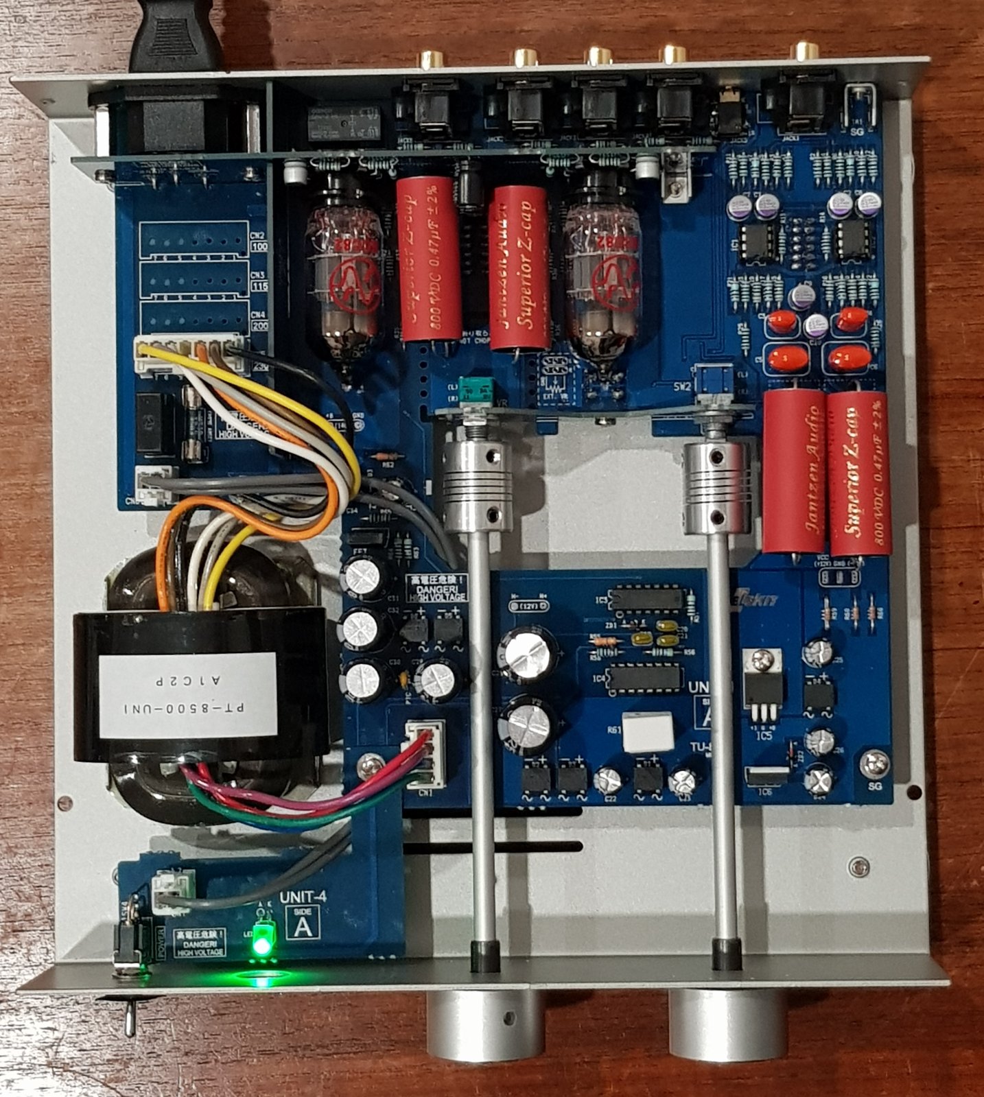

PauliD Posted September 21, 2021 Share Posted September 21, 2021 if anyone needs a refresher on what the stock kit looks like. My dad put it together for me. This thread has me thinking now 2 Link to comment Share on other sites More sharing options...

ICUToo Posted September 22, 2021 Share Posted September 22, 2021 23 hours ago, PauliD said: if anyone needs a refresher on what the stock kit looks like. My dad put it together for me. This thread has me thinking now Wow! Shows what a stretch it was to get the Z-caps in there! Link to comment Share on other sites More sharing options...

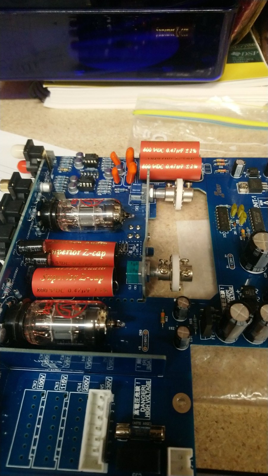

Batty Posted September 30, 2021 Share Posted September 30, 2021 (edited) I replaced the original 0.47uF caps for Z-Caps this morning, pics later when I get home from work. It is a bit of a squeeze. Edit: Just took a couple of cheeky pics with my phone. Edited September 30, 2021 by Batty 2 Link to comment Share on other sites More sharing options...
Claudio IL Benna Posted September 30, 2021 Share Posted September 30, 2021 2 hours ago, Batty said: I replaced the original 0.47uF caps for Z-Caps this morning, pics later when I get home from work. It is a bit of a squeeze. Edit: Just took a couple of cheeky pics with my phone. Great!! Looks good, now, if you have not done it yet, please change the plastic sleeves which hold the pots' shafts and replace it with rubber grommets from jaycar. Then, grease it, much, much better feel when turning volume knob and selector, feels more "pro".. easy and very cheap upgrade. 1 Link to comment Share on other sites More sharing options...

Batty Posted October 1, 2021 Share Posted October 1, 2021 (edited) 4 minutes ago, Claudiones De Bologna said: Great!! Looks good, now, if you have not done it yet, please change the plastic sleeves which hold the pots' shafts and replace it with rubber grommets from jaycar. Then, grease it, much, much better feel when turning volume knob and selector, feels more "pro".. easy and very cheap upgrade. Done that too. Thinking of a pair of Burson V5i op amps for the phono stage as I have them lying around somewhere. Fitted JJ valves too. Edited October 1, 2021 by Batty 2 Link to comment Share on other sites More sharing options...
