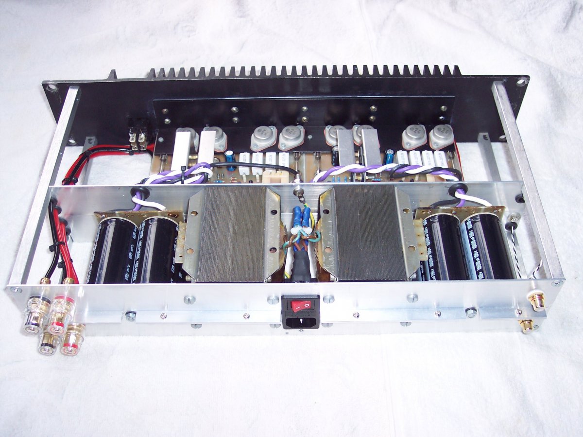

The pictures below were taken around this time after the first upgrades. (1995 ish)
100_0665.thumb.JPG.3c5824387fae48bff0721ad387372735.JPG100_0674.thumb.JPG.aa8884d21c07dbe078be8236de1f33b8.JPG100_0680.thumb.JPG.800156190a309af4e9a6ecdda61d3dd0.JPG100_0682.thumb.JPG.8e0d347cd10de5bc444ea4fcffedff75.JPG
I accepted these issues for some time and then it was decided that one day I may have to rebuild or redesign the general layout of this amplifier, maybe two mono block channels in a single case perhaps.
This then led to the first major power supply up grade using bigger power supply electrolytics, individual bridge rectifiers and Toroidal transformers to hopefully get rid of the transformer hum as well.
To do this I had to re-fabricate the rear panel out of steel (not the best material) but had to be strong to hold the extra weight and stresses associated with a cantilever application.
100_1467.thumb.JPG.fc230c5540b624d3e1dbf9635372d3fb.JPG100_1472.thumb.JPG.10a264e84d73ee98c703a701e9ad6c22.JPG100_1475.thumb.JPG.a766b21605cab4a76438594571b7f2d5.JPG
From the above pictures it can be seen there were some design issues that were also overlooked such as the routing of the input wiring being too close to the Toroidal transformers.
Input and output wiring was also too close together for my liking and mains wiring was still a problem.
The main problem that led to a total failed attempt was that the Toroidal transformers were now noisier than the old EI type transformers that were initially supplied in the kit.
So I then placed each of the EI type transformers on the bench with power applied via an isolation transformer and RCD (only do this if you are a qualified technician as it can be extremely dangerous) and then proceeded to place wedges made from cable tie stubs strategically in between the iron core and the copper hum strap around the transformer winding.
This actually worked and the transformers no longer make any hum or noise even when the off-peak hot water heater signals are injected into the mains late in the evenings. Transformer problem fixed!

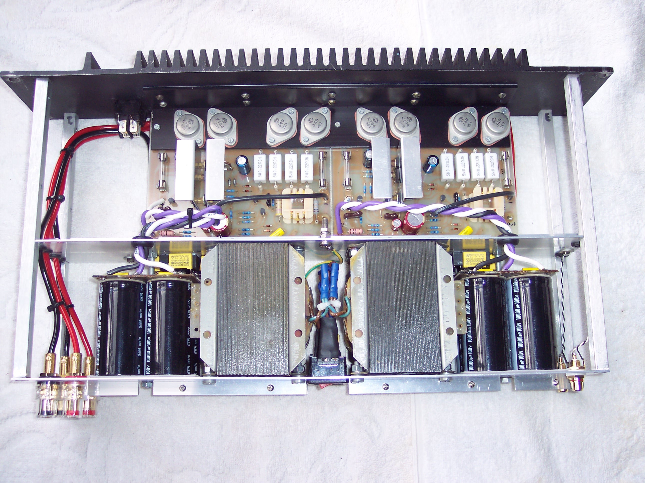

Now with this sorted it made sense to do a second power supply upgrade and keep as much as the original kit as this is what the Series 5000 was all about.
The lovely front heatsink and easy to work on case, Hitachi power mosfets, EI core transformers and not to forget the good specifications and circuit design.
It all then led to the final upgrade and layout decisions.

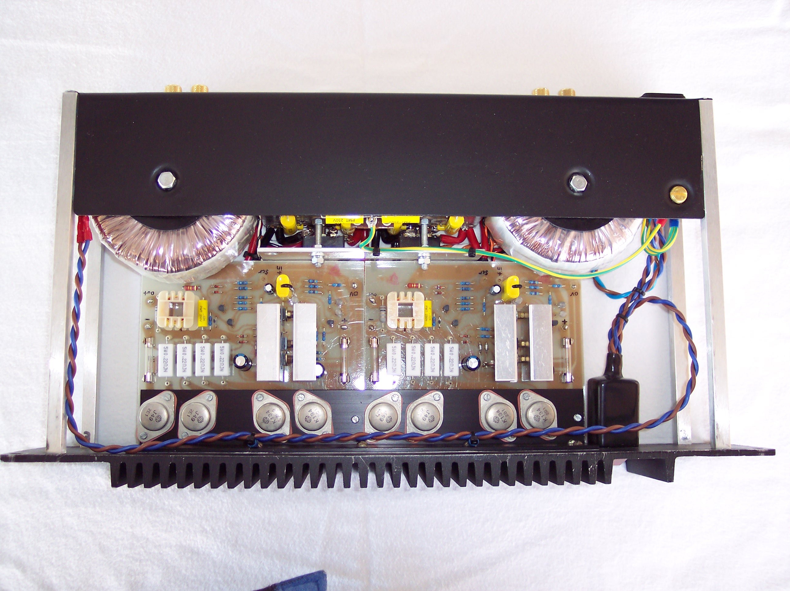

100_3733.thumb.JPG.541626cd7a831f1dd33494e21df7d83d.JPG100_3734.thumb.JPG.6c7269adff7196c04ccf61dae267e768.JPG100_3735.thumb.JPG.6cafa36829802dea87720df693a5cd7a.JPG100_3736.thumb.JPG.99d6c3d292098197f6839122e4706b6e.JPG100_3737.thumb.JPG.5fb0bdfb3837780fa08b133240057cdf.JPG100_3738.thumb.JPG.bfb74933508adf5d954f88b75146c98e.JPG100_3739.thumb.JPG.eca1fe86c37b2d404648000c2387e246.JPG100_3741.thumb.JPG.149533a6c79308bba8ad94521ff5195b.JPG
Some of the main considerations that were made:
Segregation to the mains power supply wiring between the power transformers.
Aluminium segregation between the power supply and the amplifier modules.
Total separation between input and output wiring.
Twisted pair for all AC wiring.
Snubber capacitors across each rectifier diode.
Bypass capacitors across the main electrolytic capacitors.
Added mains suppression capacitor to the IEC connector with fuse and power switch.
ELNA Cerafine electrolytic capacitors for coupling.
Low ESR electrolytic capacitors for power supply applications on the amplifier modules.
Globes fitted to the old mains power rocker switch for good looks.
At the end of all of these upgrades it was well worth the effort as the hiss, hum and noise has completely gone.
The original looks of the Series 5000 was maintained from all sides except for the rear panel.
However the power supply was split into two separate supplies like two mono blocks in the same case.
The main thing is that the amplifier sounds excellent and has not missed a Hz since.
PS: The silvered mica capacitors seen in some pictures were replaced with polystyrene types as these sounded the best IMO.
