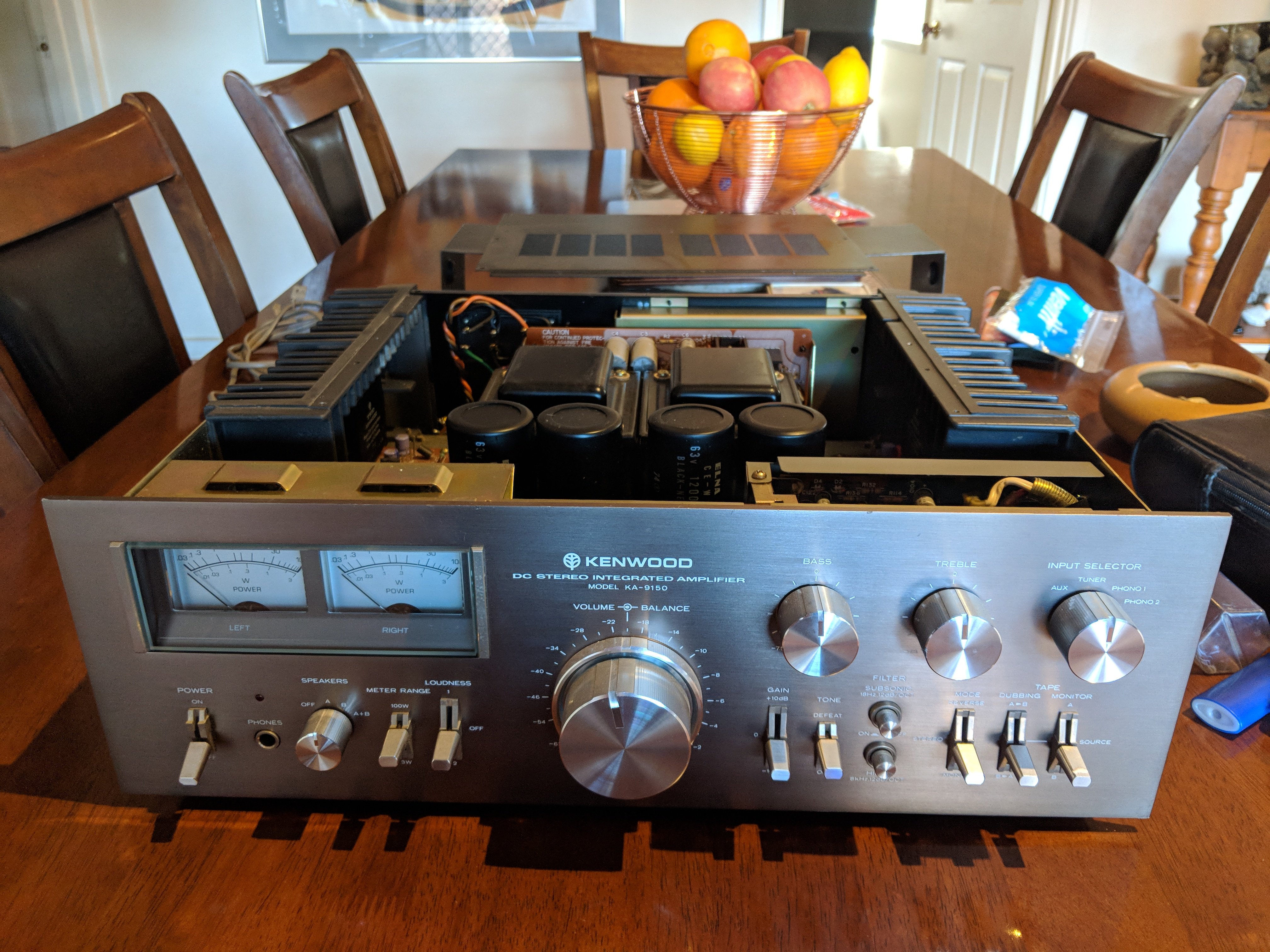

G'day fellas!
So I have had this integrated with me for a fairly lengthy period!
I recall using it with some JBLl100's some years ago and I remember one evening the left channel from memory just stopped, no weird noises, crackles or pops etc.. it just went mute.
Anyways, I have just pulled it out of the cupboard in which it has sat for the last few years and thought it deserves a bit of a birthday!
My questions are, who is the right man for the job, and secondly what do we think these are these worth on the current market?
I would imagine being as rare as it is, that spending some money on it would surely be worth the exercise!?

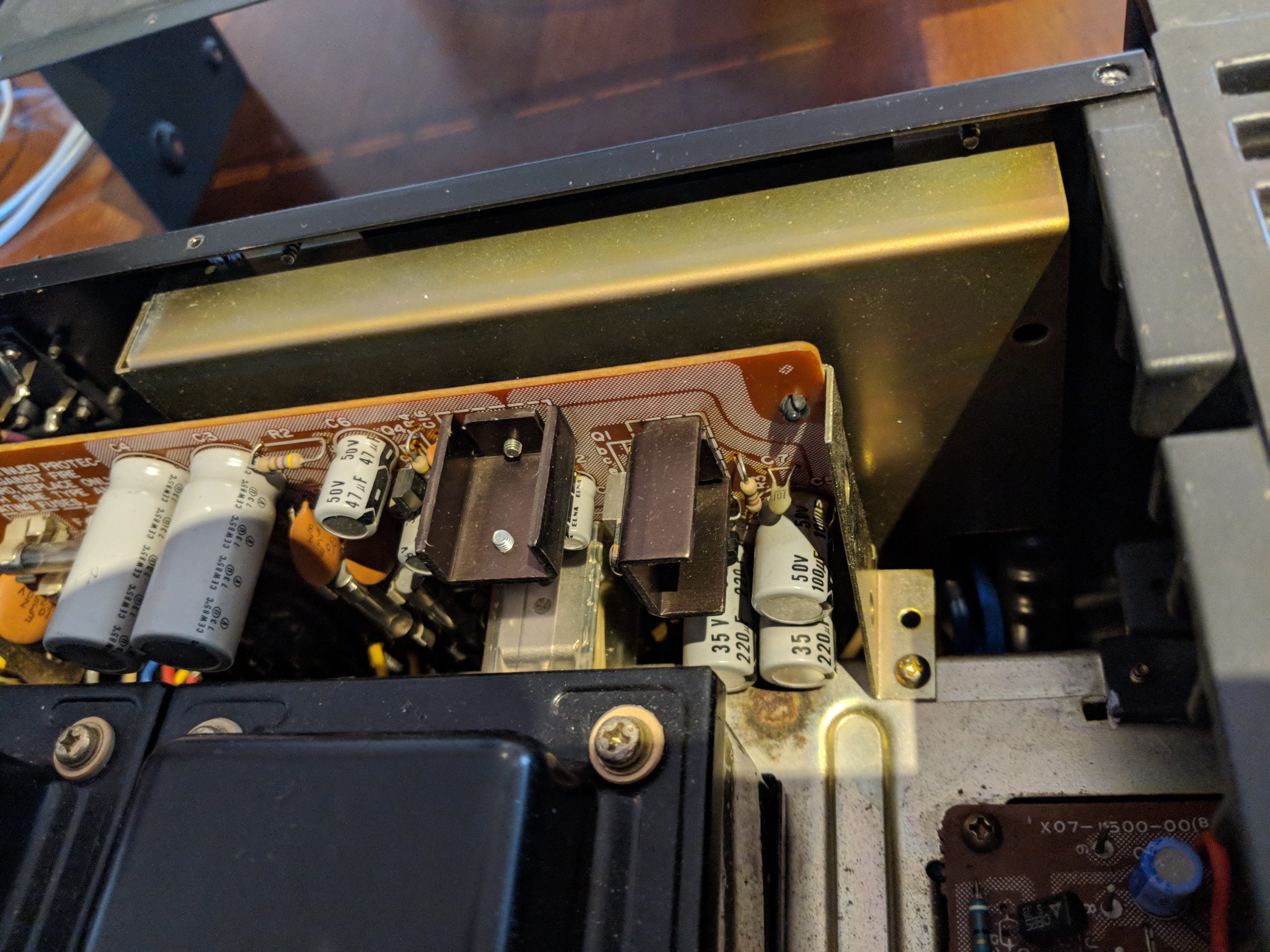

I remember hearing that the TA-100WA are near impossible to get, is there a way to test to see if the output stage has gone?
Fellas, any info that could point me in the right direction would be fantastic!

Beautiful looking amp. I think that the 9100 has some sort of amp module in them that are now not available. Hopefully there isn’t an issue with this and is a simple fix. Sorry I can’t help with recommending a repairer.

Hey Dave, yeah they're identical mate.. that output module I was talking about..

Very nice vintage piece, and quite rare I think. Real late 70's high-end heavy weight Japanese integrated by Trio. This amp would have typically been going up against amps such as the Rotel RA-1412, Yamaha CA-1010, Sansui AU-10000 etc...Certainly get it going again, too good to be sitting in the cupboard....

Depends. If one of the output ICs is toast, then probably not.
Quote
Yep. You will need to put some test equipment directly on the output of the IC and measure. And yes, those ICs are impossible to obtain.

Good luck, but don't get your hopes up. Designers who used those ICs should be lined up against the wall. It's just lazy, cheap design and you have no chance of obtaining spare parts (in many cases) 20 years down the line. OTOH, I can still maintain my 1969 vintage Marantz Model 18 in almost perfect operational order (except for the CRO), because the parts used have modern equivalents and, in some cases, those parts are still being made. I advise people to avoid buying those old amps where IC output stages were used (they're not used any longer).
