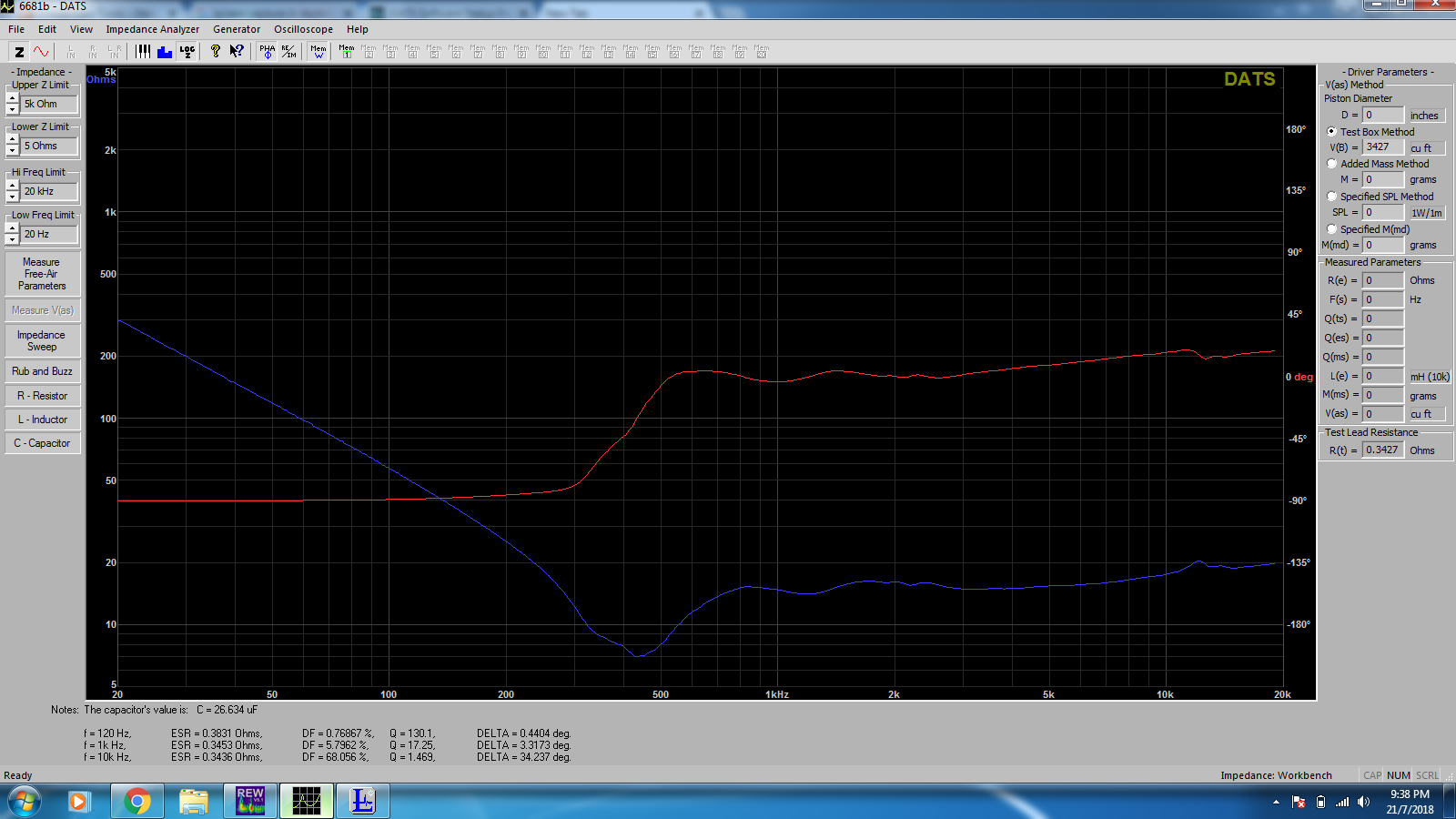

Cheers, I just thought about what the amp was driving but as you say hi impedance is better than low. Some of the other impedance graphs I've seen have some really hi levels at various points. The xovers I had for the BMS coaxials had some really hi levels right through the main listening frequency, this is the response for my Yamaha 6681b drivers and 2nd order xover. No tweeter at this stage but they do sound so sweet...... Don't know why I'd revisit these earlier. But, the coaxial was so easy to mount.
