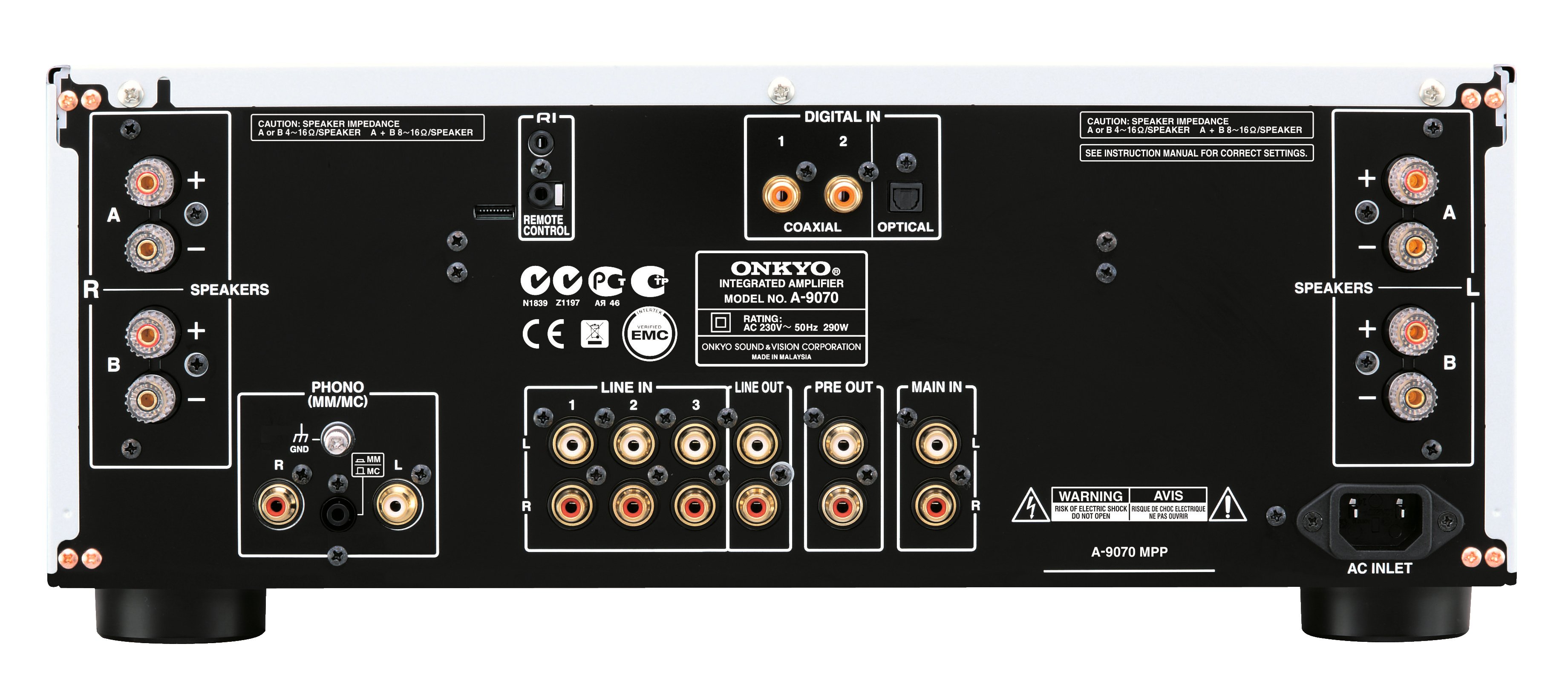

Was at my father in-laws yesterday, installed JRiver on a new laptop for him. Currently running the HDMI into his TV and the headphone output into his Onkyo A-9070. Now , the Onkyo has digital inputs on the back and I'm assuming the DAC would have to be better than the laptop.
The question, is there a cable that can go from USB, directly into the optical or digital coax input on the amp amp?
I'm searched with no success and don't want to add an external DAC, just see if the one in the amp makes a noticeable difference.
Cheers.

So, plugged in the magic box, using a new USB cable and new optical cable. Laptop seemed to recognise straight away (Win 10) and installed drivers.
Tried to play music through JRiver and it wouldn't work. Best I can explain it, sounded like playing on an old computer with no memory. There were quick, (maybe 1/10 sec) bursts where noise came out, but these were only every 20 seconds apart. Seemed to also cause an issue with laptop as when you pushed stop, it took upto a minute to work.
Switch the audio output back to the laptop speakers and works perfect.
Went on Youtube to test with something other than Jriver, same result (without having issues stopping the video) as I switch between audio outputs, the laptop speakers are fine, but the magic box just makes very brief, sporadic bursts every now and then.
At this point, I'm hoping it's the cheap USB cable I got from Officeworks, or the optical cable.
I'm going to go back tonight with a coax and one of my USB's from home and see if that works.
Anything else obvious stand out to anyone?
Thoughts please @scumbag ?
Thanks.

Believe it or not, brand new USB cable was the issue. Now all working fine, thanks again.
