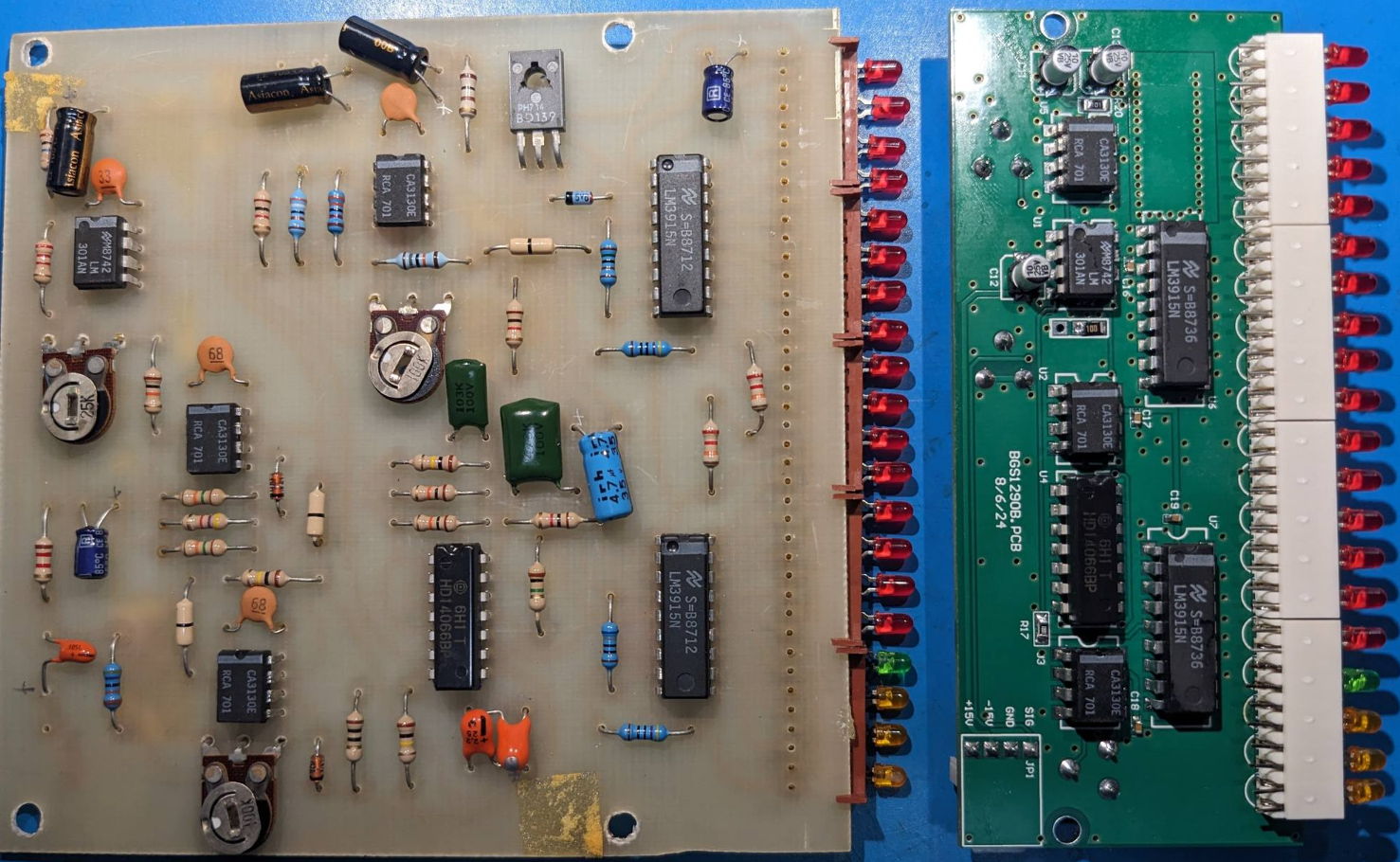

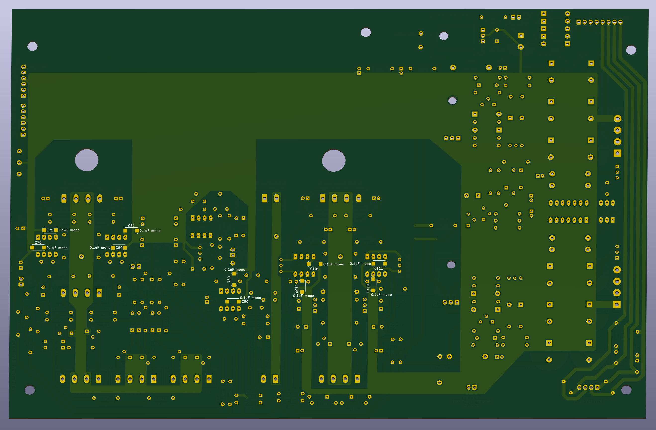

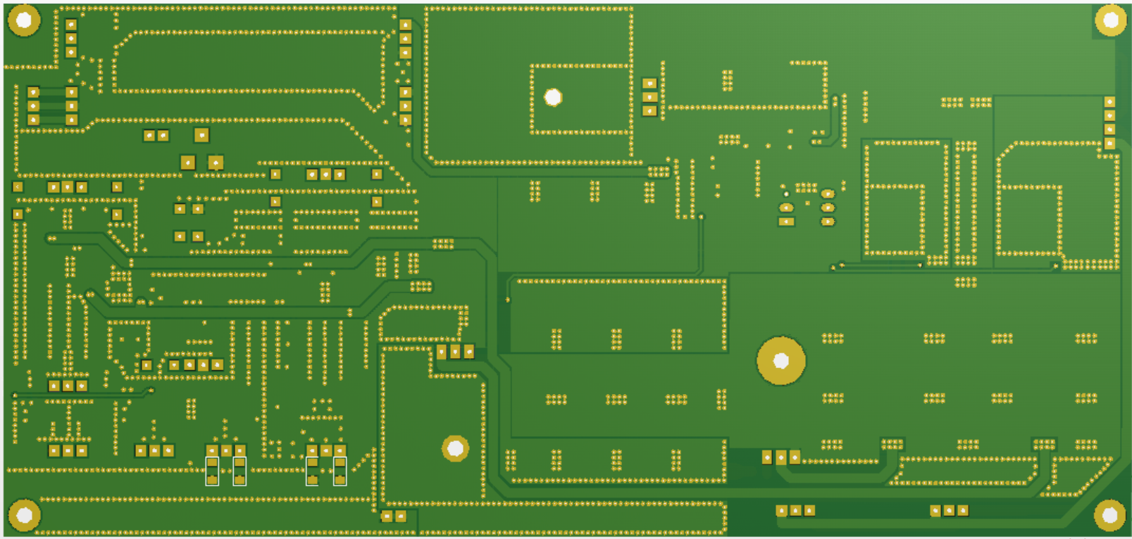

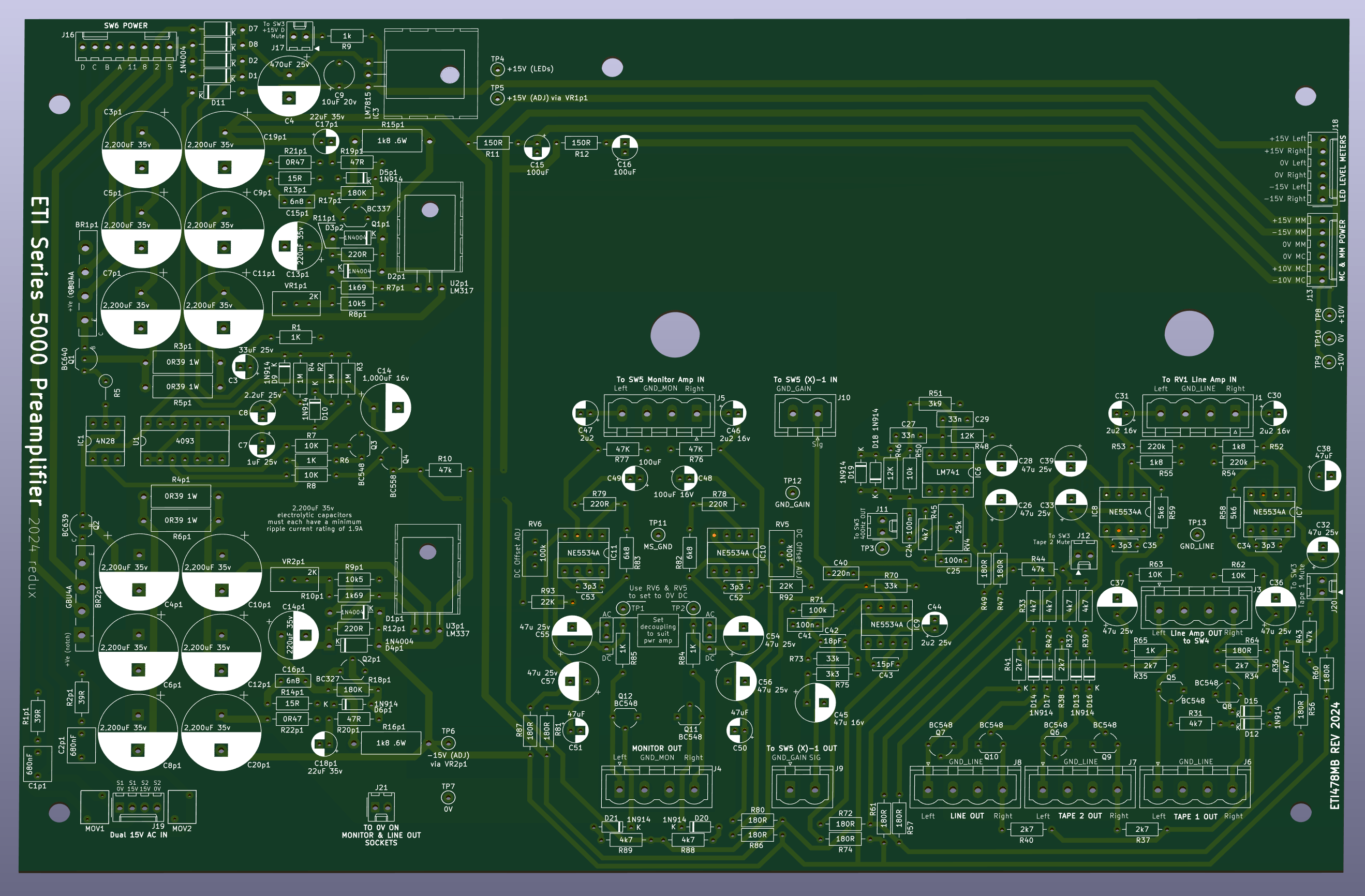

Hi Tim, this is the boards side by side....all ics are still through hole.....but the rest is SMD. Its over 30 years difference....image.png.5a2fa78d1fcd7b00379b19e50af37086.png

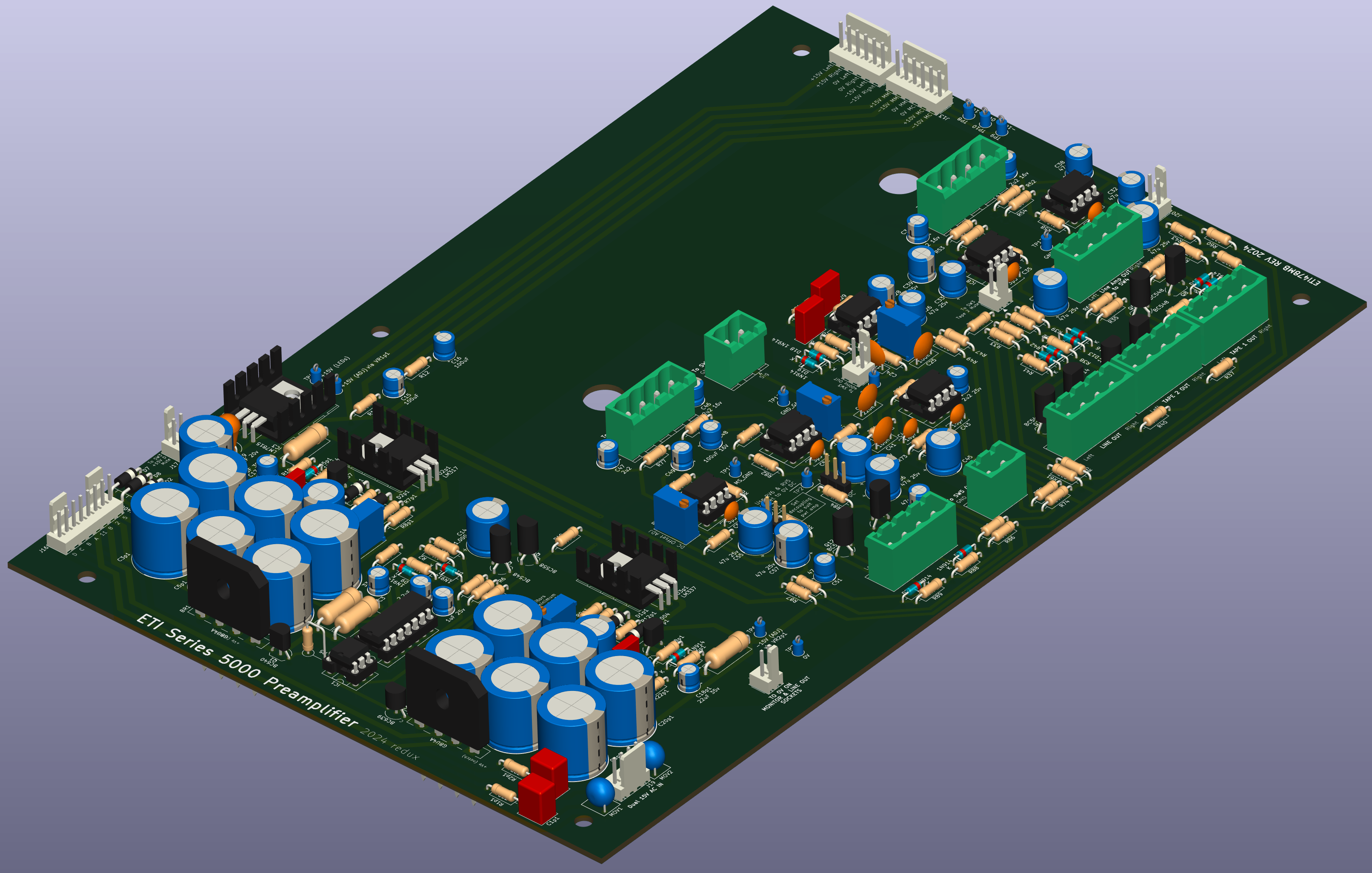

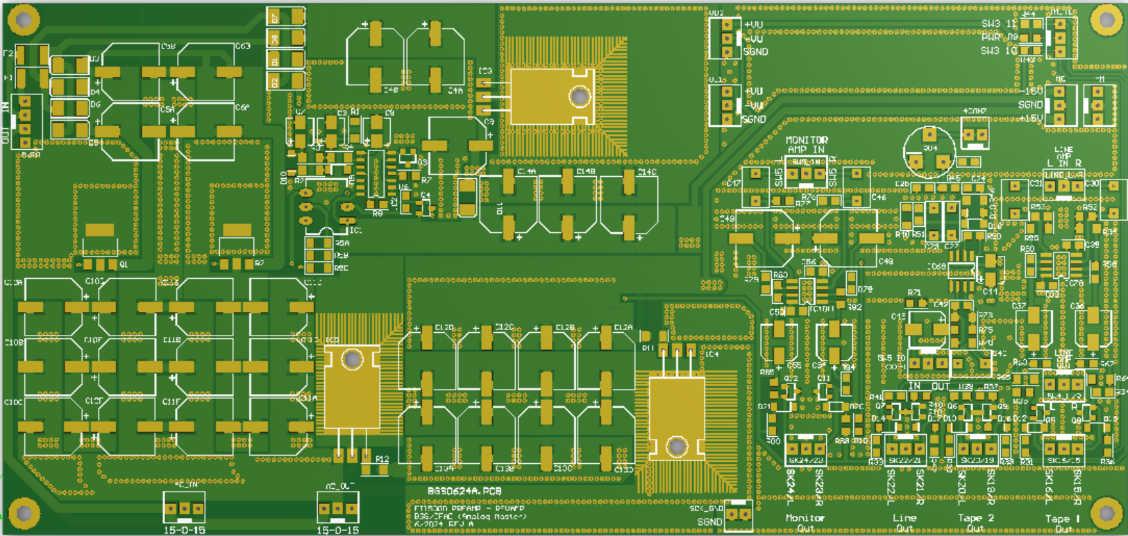

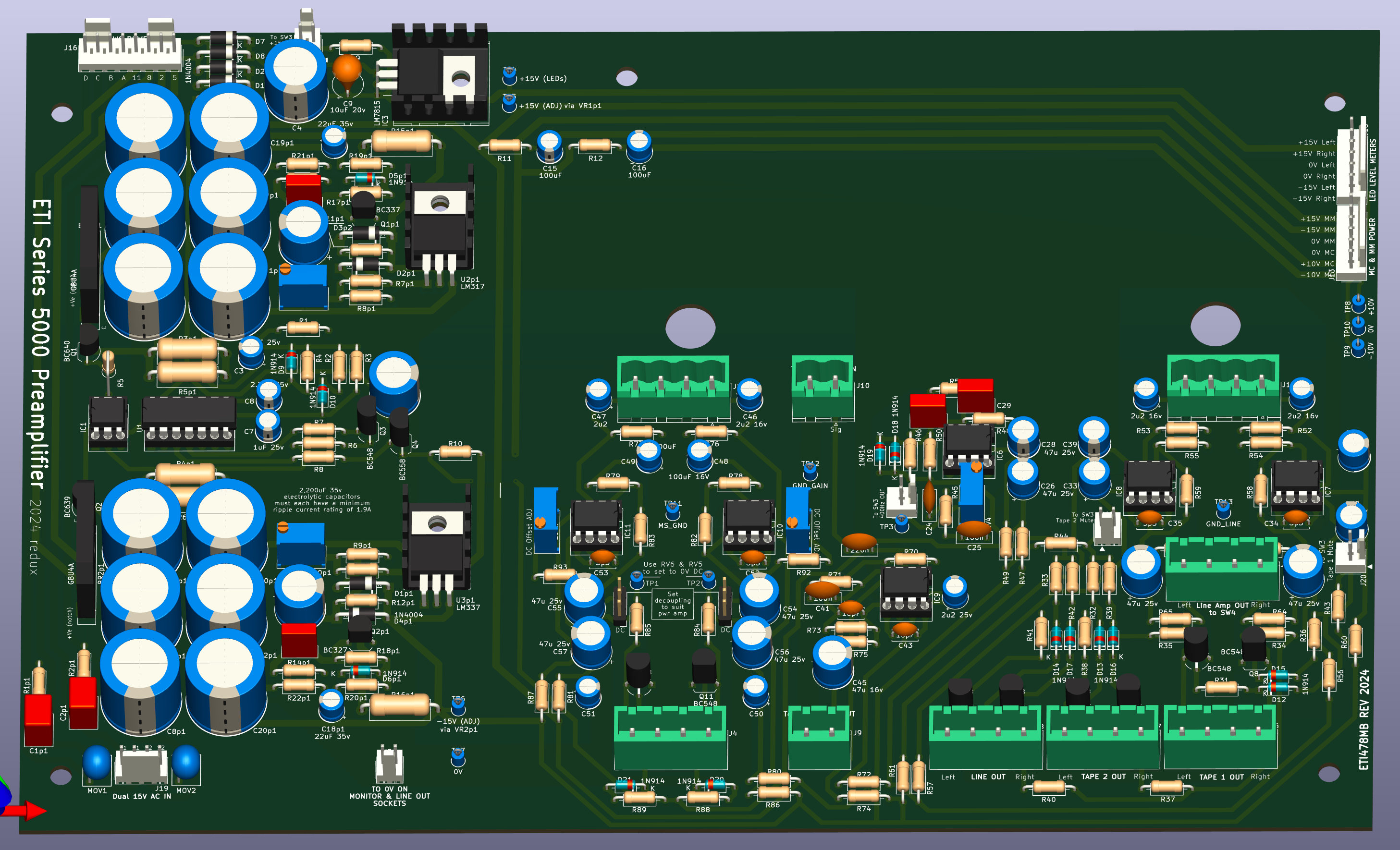

this is my preamp, had an analog master put a few points in...the original design was ok, but it was done with tape, and single sided. i changed all the op amps to the dual package as well. Caps will all be wurth electros. Im using the moelx 3 pin sockets, with centre GND.
image.png.ca0c91fe016f48adacaf7a8e72b0c3df.pngimage.png.e261722f0800795217c1d85f0c4689d9.png
Tim, i noticed that you put big heatsinks on the regs, but you left out the heatsink on the crucial one, IC3, this is the one that supplies the most current.....it runs the VU meters.....also noticed that your AC is 25V, your starting to push over the limits of the caps. 25VAC = 35.35v, you get a volt drop on the diodes....your very close to upsetting the caps. Ive used 24vac in PSU circuits with 35v caps, and they have run for years, but 25VAC ....thats a bit much. maybe drop it to 15VAC, which still gives you enough regulation for the LM3xx. They should be happy with 20VDC on the input.

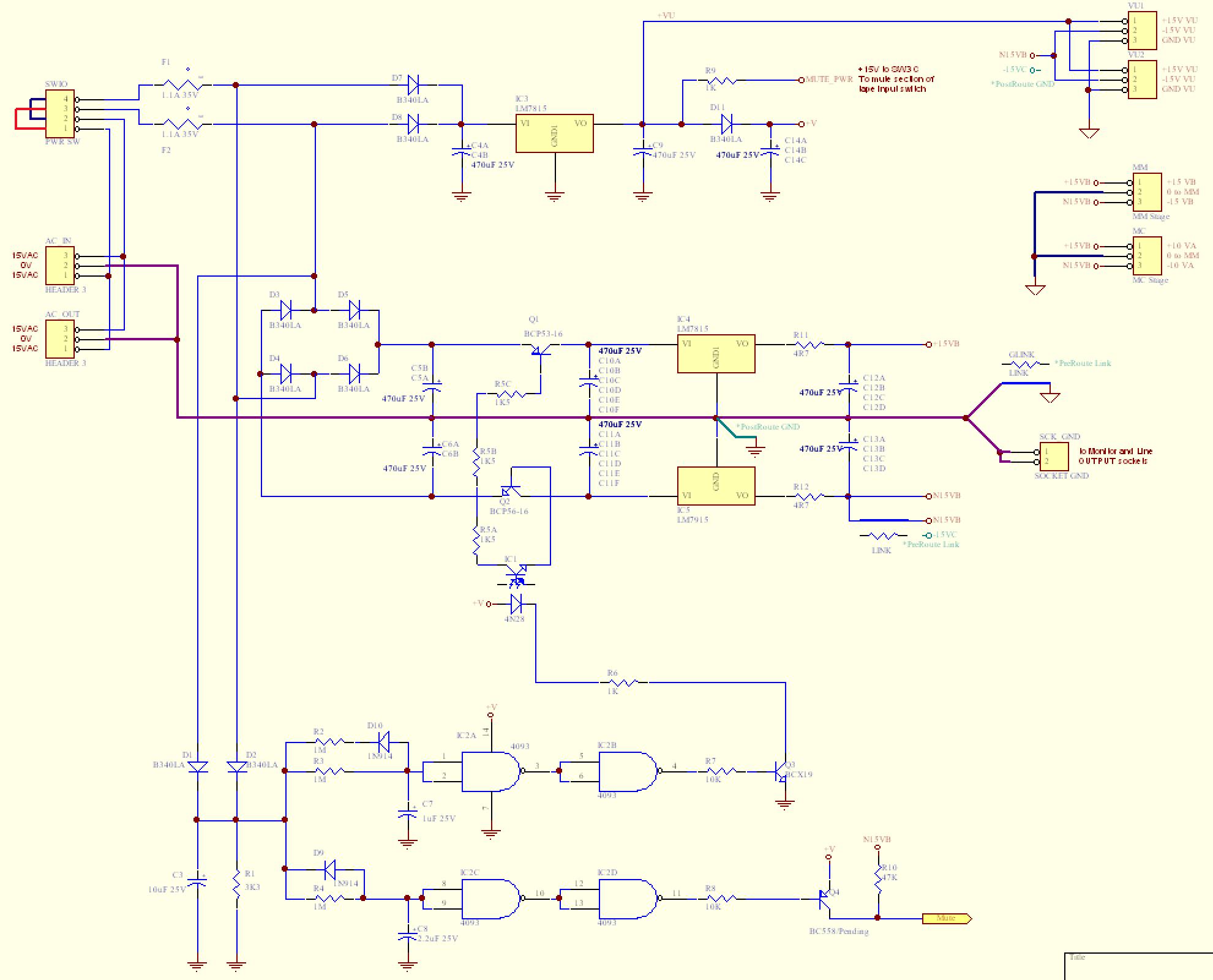

This is the PSU section for the Preamp

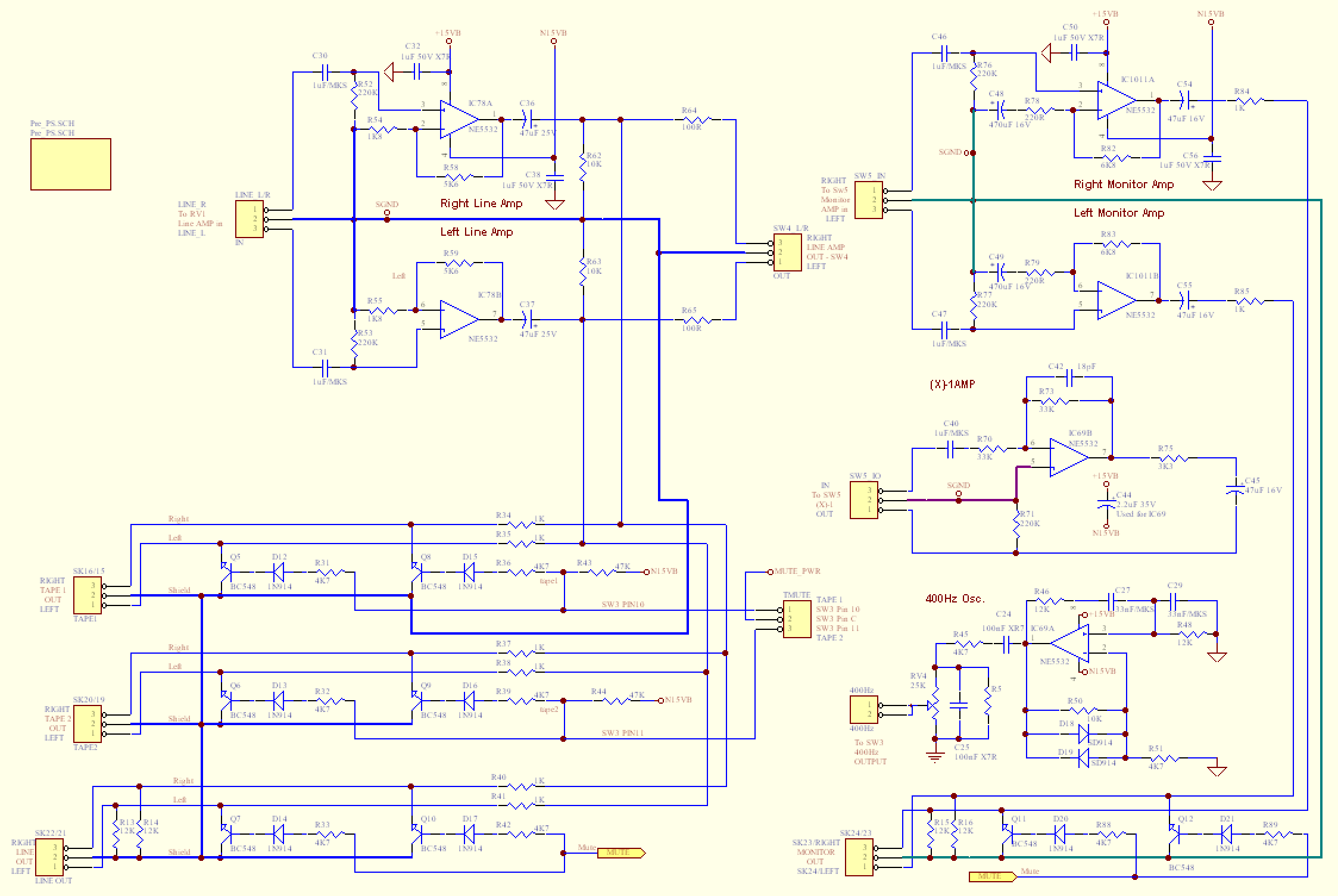

this is the opamp section... we left the mute section alone as well. Ic are numbered in combined numbers..... ie, IC10 and IC11 are now one IC1011

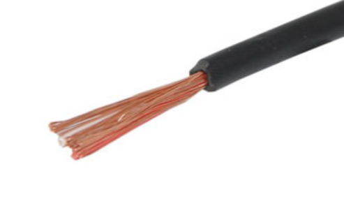

Im going to use the twin shield cable from altronics, (W3020), each wire is separately shielded, but the shields touch. so im trying to have the shield soldered up the top of the switch, and the L/R just below, which will take some work as the L and R are far apart on the PCB. These cables are good for the 3 way molex/oupiin connectors (Altronics P5473)image.png.b66e748119abf7a659c78b33b2bae7d3.png

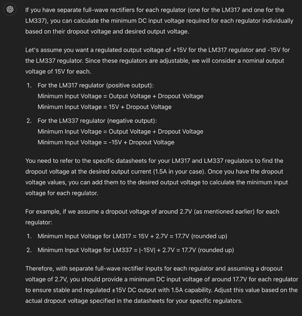

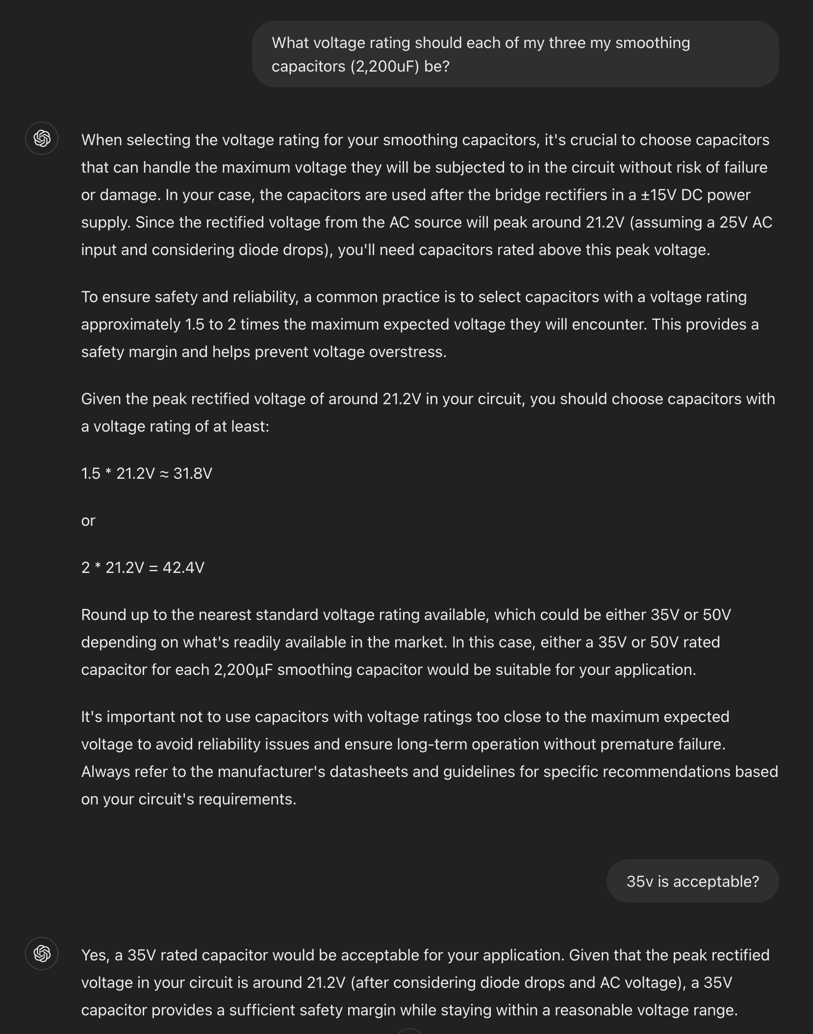

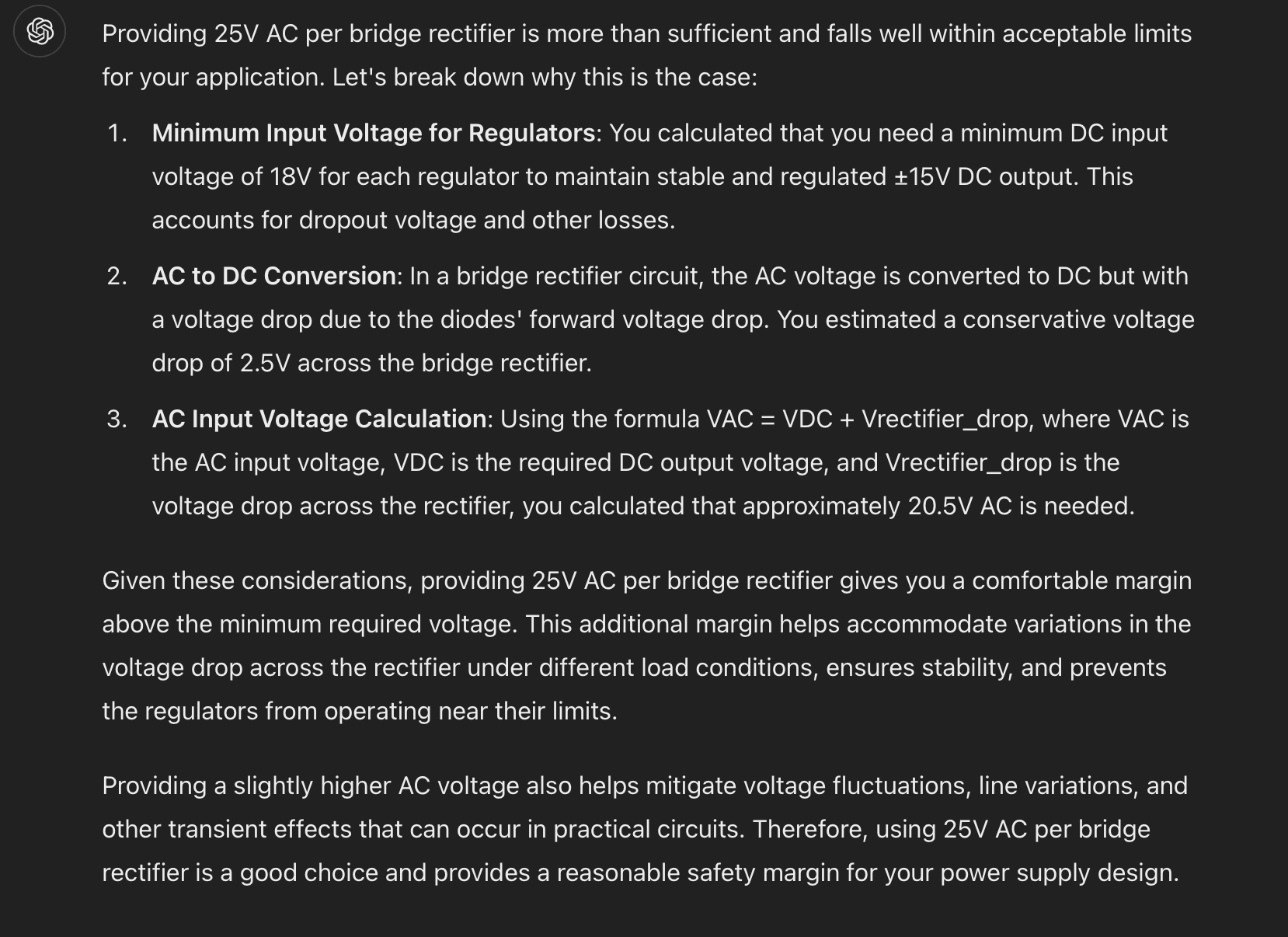

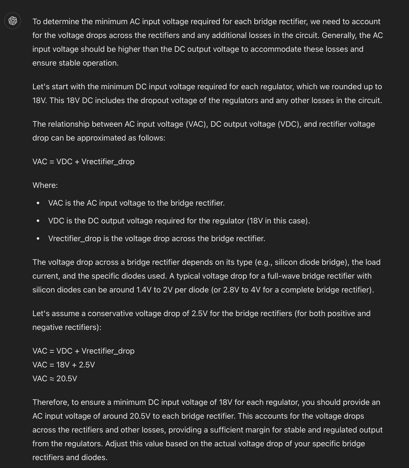

Regarding the AC input voltage and the electro voltage rating, I had rather lengthy ChatGPT discussions - my only source of info to run calculations! The response I received played out this way:
So without stating what is probably obvious by now, I have no experience with theory beyond basics. My experience is focussed on kit building/designing and simple repairs over 40+ years. Theory beyond Ohm's law, etc. is beyond me 🤣
As always, happy to take direction and comments on board. And yes I know, ChatGPT should probably be taken with a liberal dose of salt! But to my untrained eye, the logic seemed sound.
Bill, I notice you've used different transistors in the pre-reg section of the PSU - something I considered. Was that done on purpose? Tilbrook used BC639/BC640 in his design (and I dutifully copied). Would be interested to learn more about that part of the cct.
Tim
Tilbrook used under rated transistors, I replaced the original ages ago with BD type, the ones I put on there are rated at higher current, and they sit on their own heatsink. The power supply stuff you put up is for max ratings, you are no where near 1.5amps, lucky to be near 500ma on the VU, the other two, well lucky to be more then 50...I'd have to check what the opamps draw..the regs are big to ensure they run cold

Here is an updated render illustrating the reduced heatsinks (thanks, Bill!). The LED VU meters get a slightly larger heatsink.
Next step will be measuring the physical components against the footprints on the board to be 100% sure that everything is perfect.
One final consideration perhaps would be swapping out the BC639/BC640 pair with BD139/BD140 as Bill stated. The only logic I can apply here is that each BC device can manage ~1A, well short of the draw. The board has room to accommodate the BD devices if necessary.

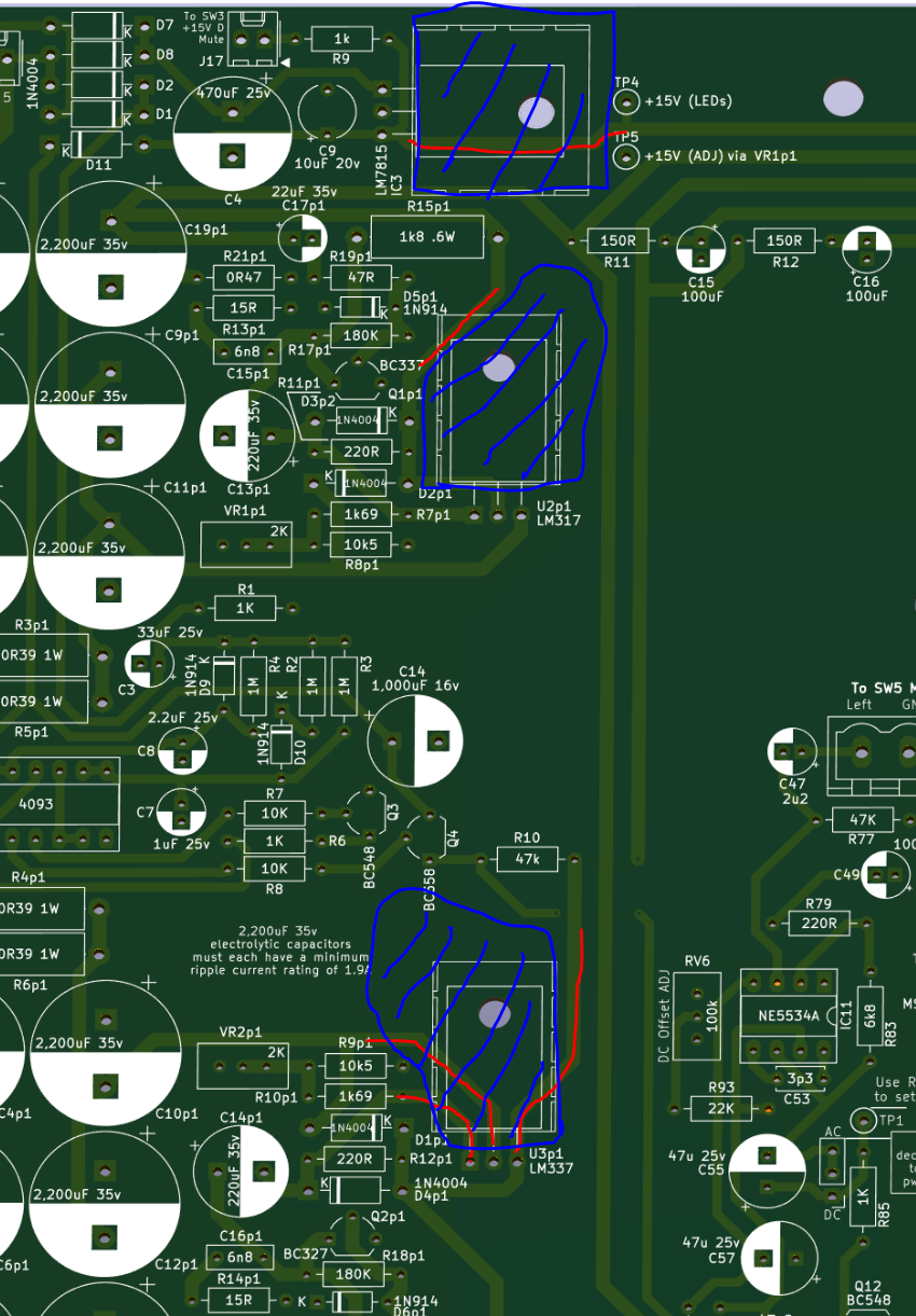

Tim, put copper under the heatsink, if you can fill the whole area....let the PCB work as heatsink. Look under my regs, I've put as much gnd that I could
Red line - move the tracks away from under heatsink, blue, place copper to create more heatsink

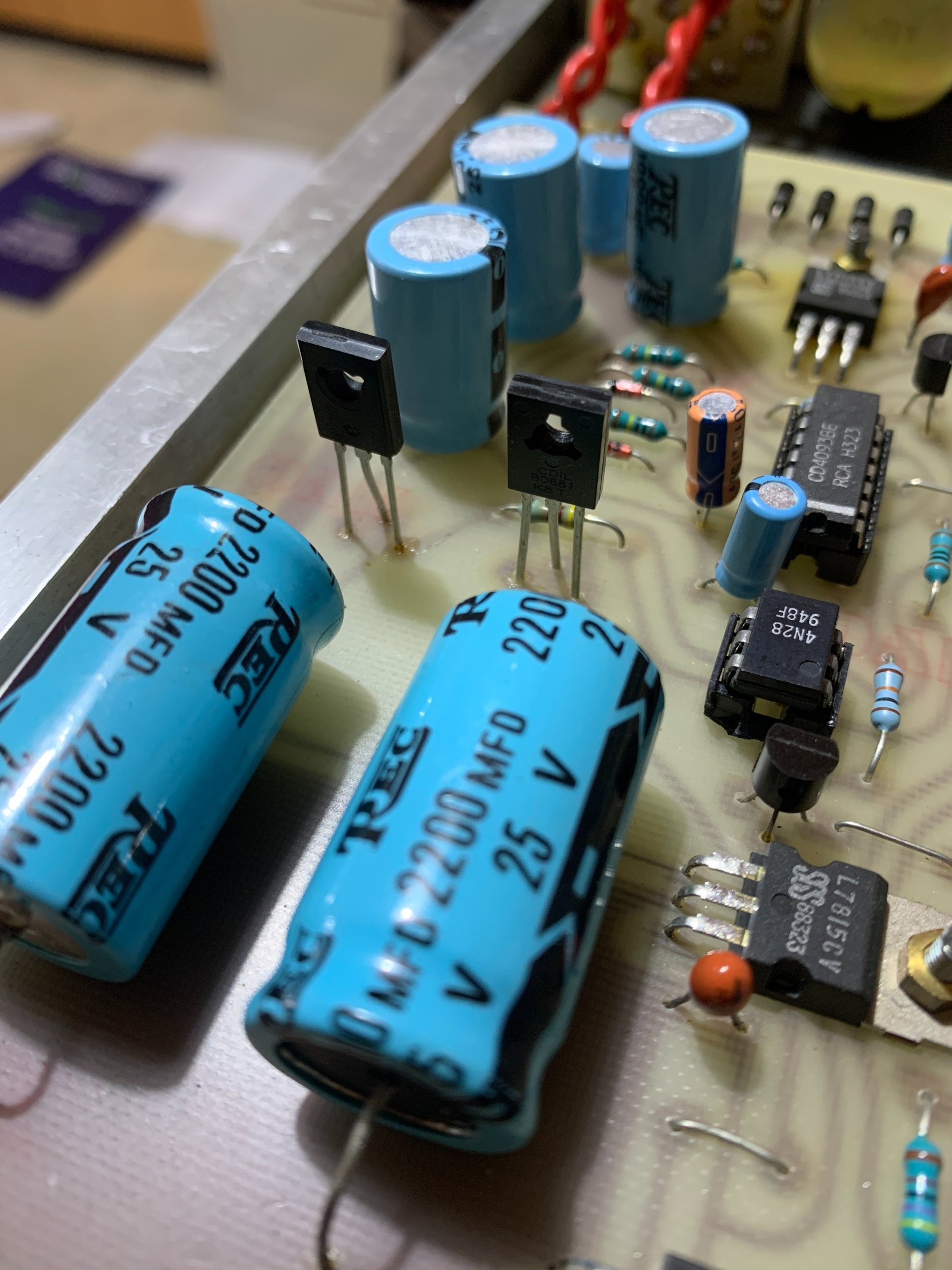

Had a little look at the 5000-pre that was not working and discovered that the BC640 in the power supply positive rail was open.
Had a set of BD681 /682  (darlingtons) so with a bit of effort to get access to the copper side of the main board, I got the old 639 / 640 out and the 681/682 fitted.
Drop straight in as the pin out was the same.
Fired it up and bingo !     back to life.
Bit of a soak test and they are still at room temp
Measured 29.4V across the 4.7K base resistor, so about 6mA thru the bases.
VEC on both is about 0.64V  so they are well and truly turned on.
The 681/682 are rated for  4amp nominal collector current, peaking at 6amps  so they should be  all good.
