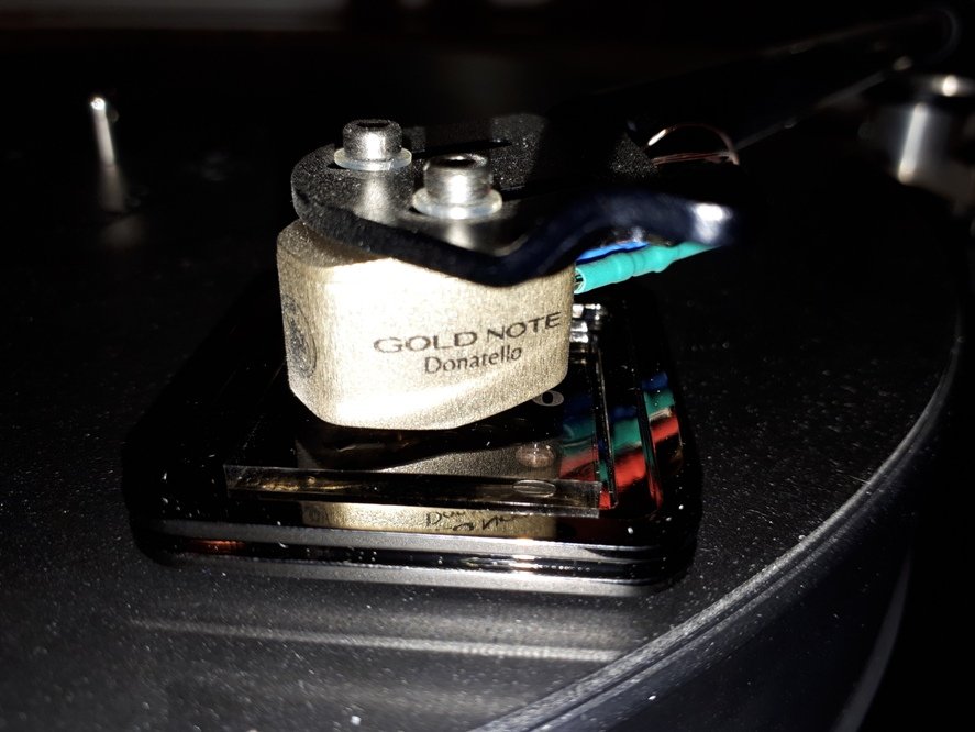

So I started using this (DS Audio ST-50) with good results, simply lower it into the gel type substance, a few times and your good to go, imo you can clean it more often without worrying about damaging the stylus, especially if your had a few too many drinks..

I've done this with Bluetac sitting between two 20 cent pieces so that no dust falls on the Tac. Seems to work ok, but I'm a bit worried about residue.
