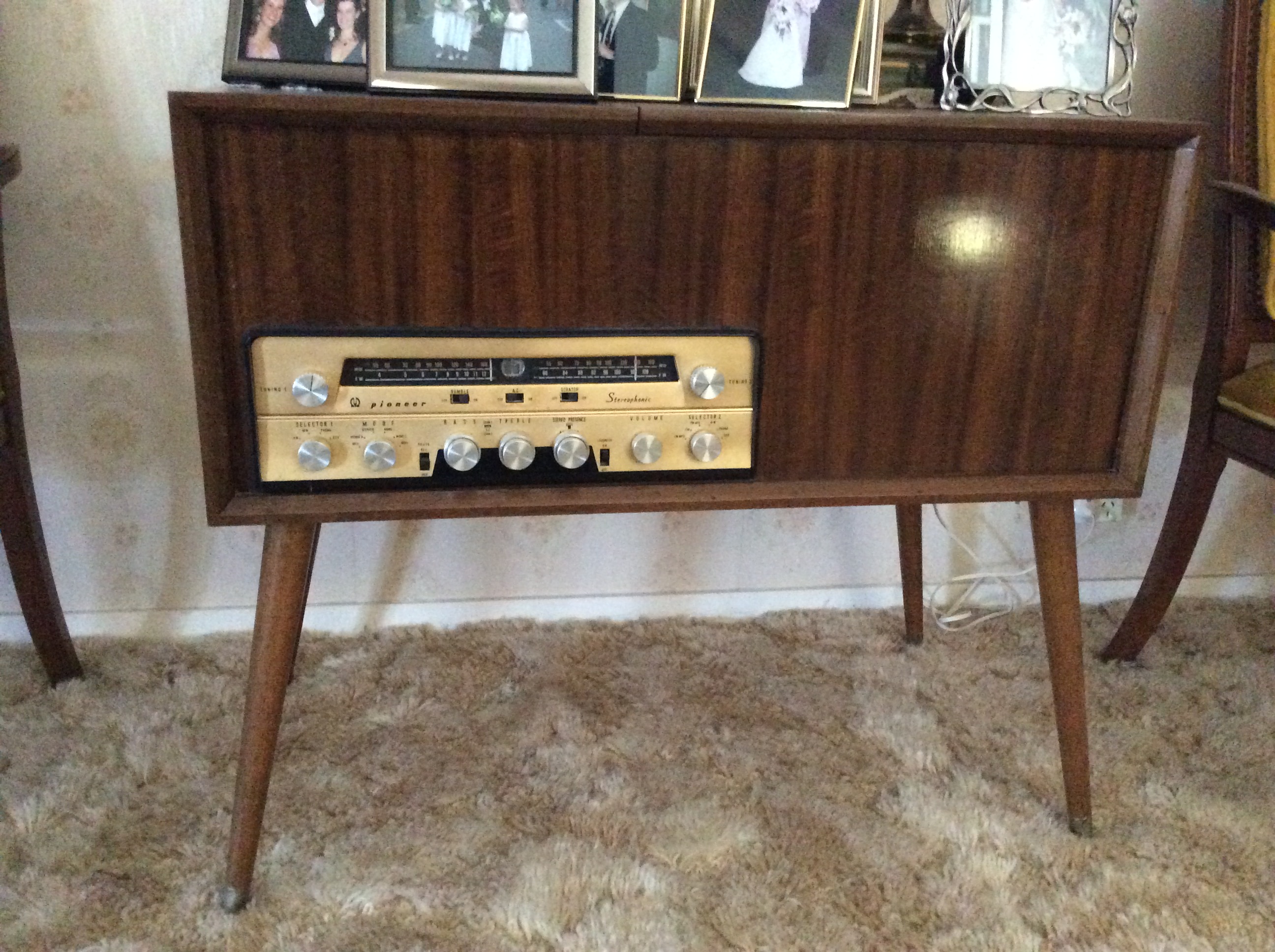

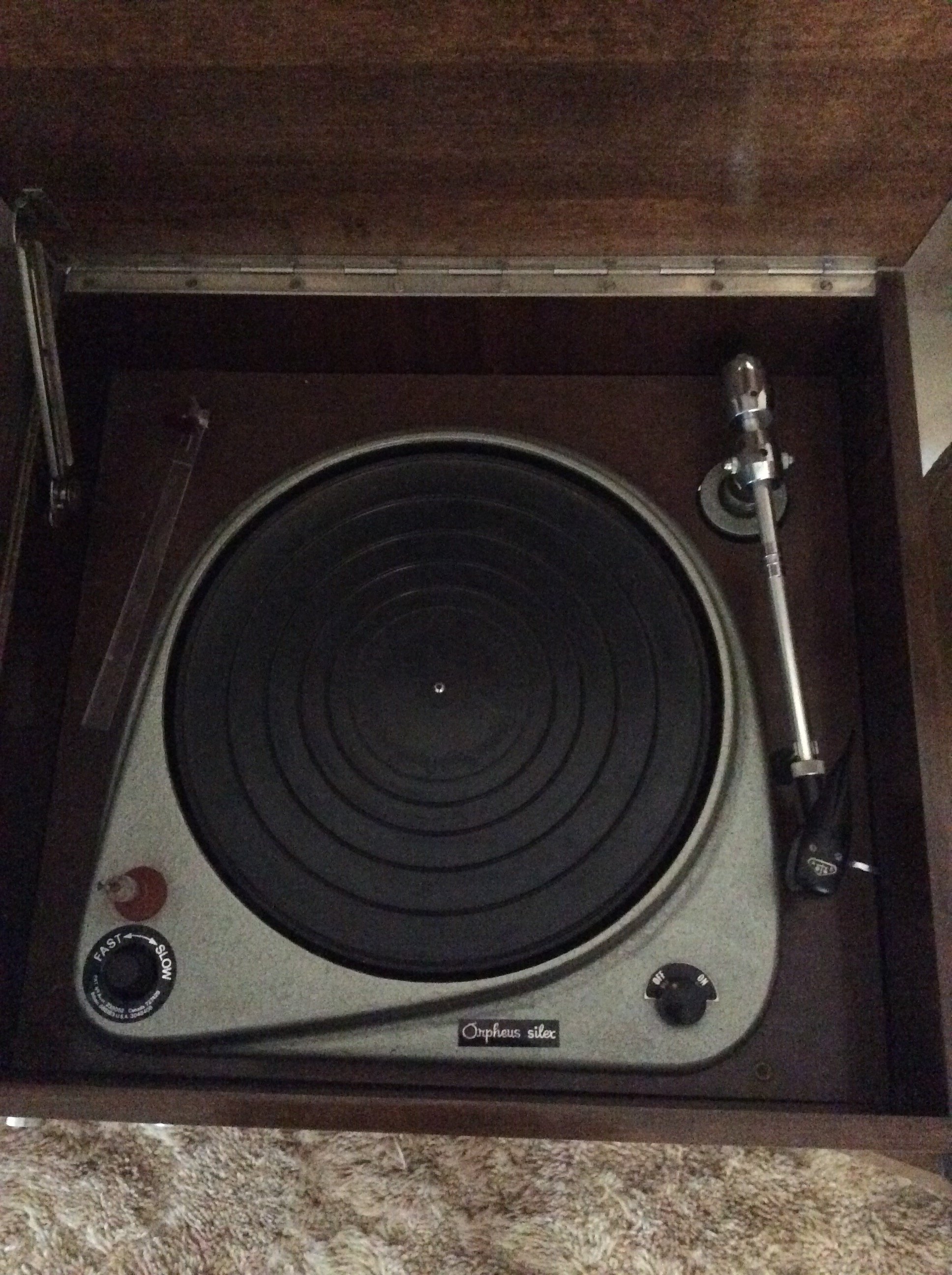

What a beautiful old piece of engineering!   I have both an Orpheus table, and a B&O tonearm like that, and hadn't thought of mating them together.   To have a console unit with the level of quality, and that includes the Pioneer stereo receiver, is indeed fortunate.
Link to comment
Share on other sites
  • 2 months later...
On 12/5/2017 at 12:57 PM, Mat-with-one-t said:
Yeah I know! I’ve also found someone to restore the unit, which has all its original tubes.  The setup also has an amazing set of old Warfdale omnidirectional speakers.  It all sounds pretty amazing last I recall it running....

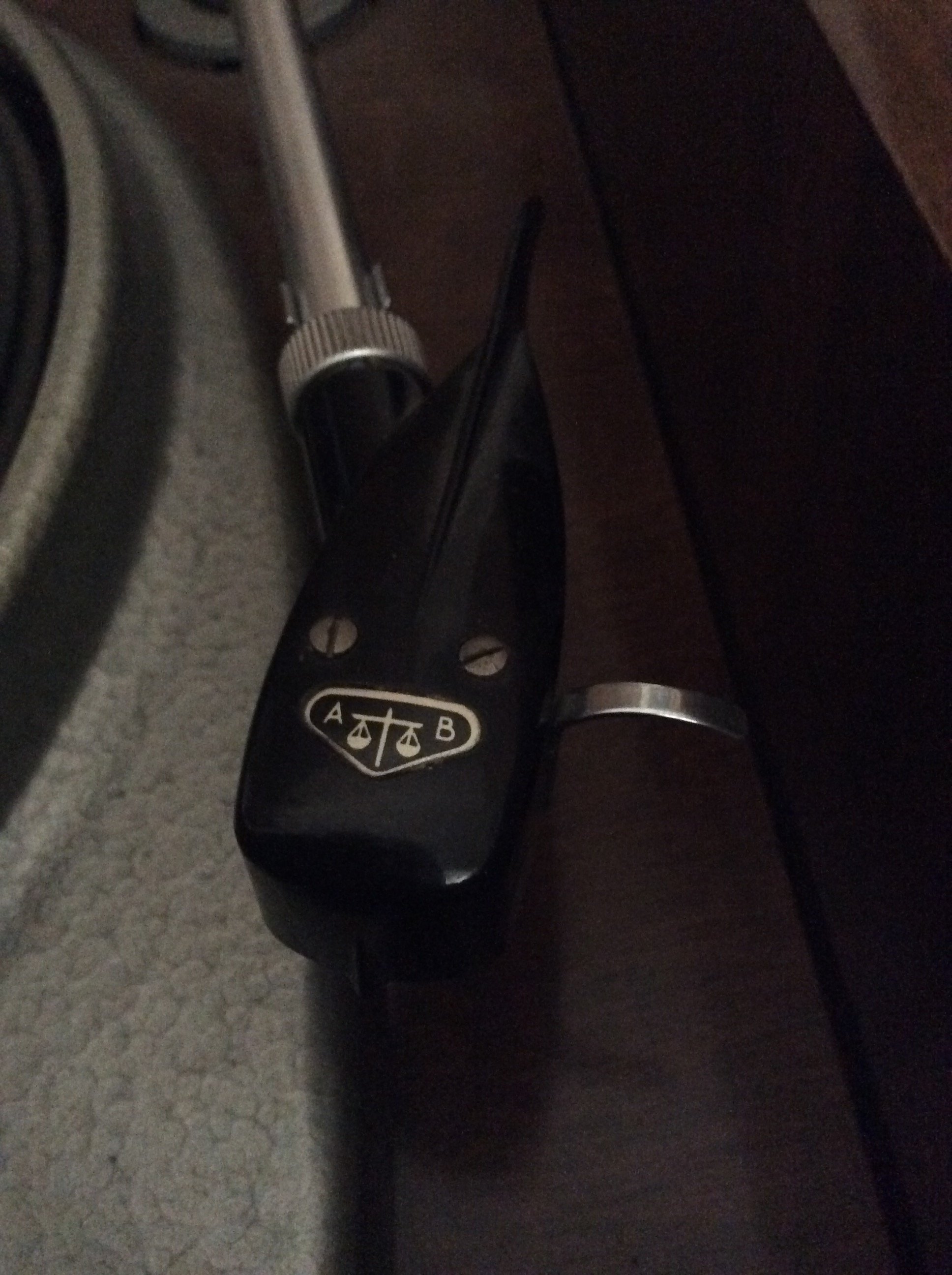

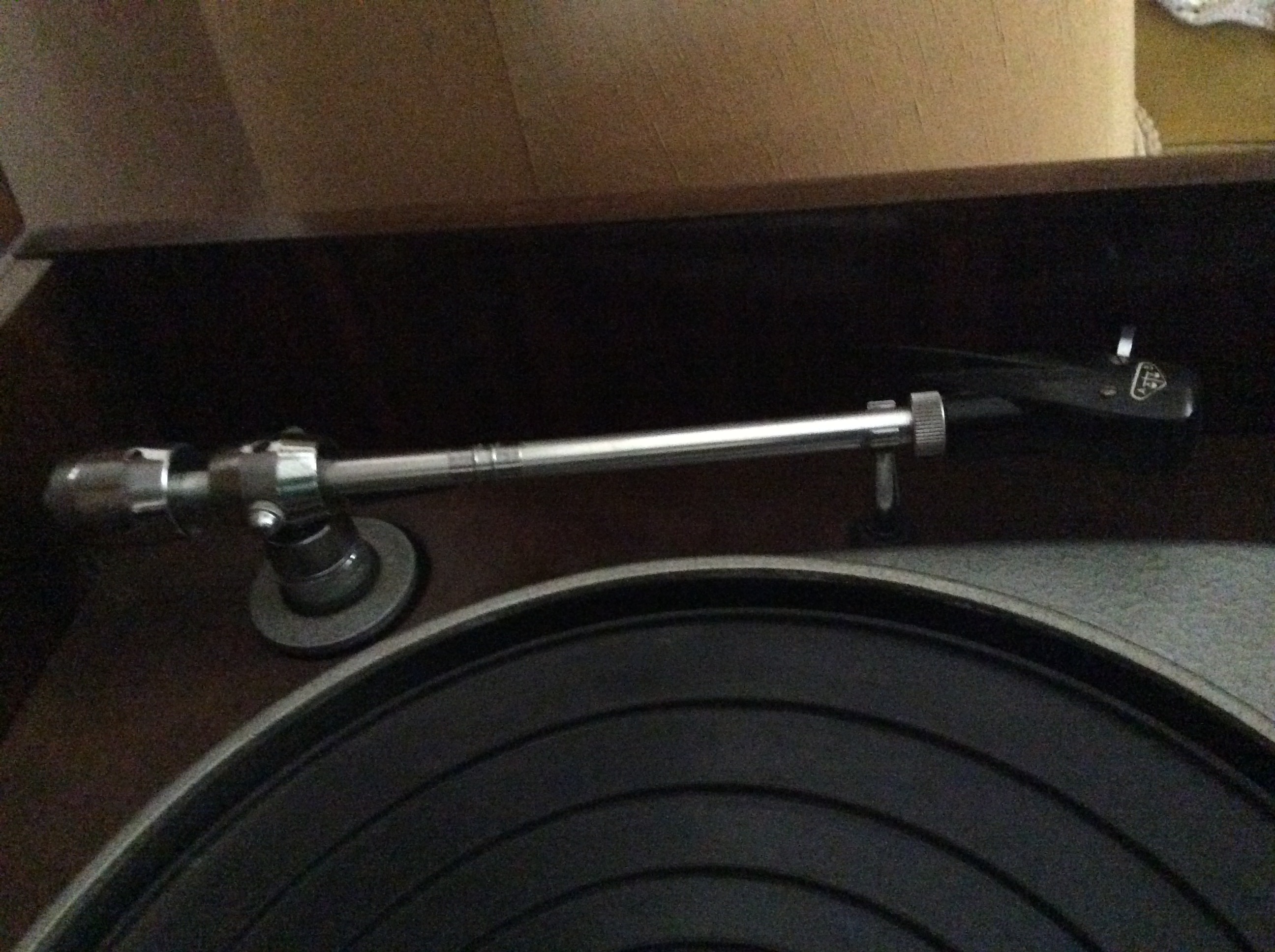

My father-in-law has those Warfdales, and they are still going in his garage.  I think he bought them with his Silex, which he no longer has.  Your parents Silex looks nice.  The rubbers underneath often perish and need replacing.  The rocketeer headshell on the AB arm is very cool.  Unfortunately they have a non-standard fitting, and the bakelite becomes loose, hopefully this unit is still OK.  I would suggest getting rid of the dustbug (take care removing the adhesive post so the paint is not damaged).
Link to comment
On 12/5/2017 at 12:52 PM, aussievintage said:
What a beautiful old piece of engineering!   I have both an Orpheus table, and a B&O tonearm like that, and hadn't thought of mating them together....
The arm is an "All Balance" (Dutch, I think) and they were commonly sold with the Silex, and Labcraft/B&O turntables.
Link to comment
On 12/2/2017 at 11:53 AM, aussievintage said:
Is that an Orpheus Silex Table?  Wonderful old turntables!   Interesting to use a tonearm mounted on the plinth with a turntable with suspended subchassis.   Originally a tonearm was mounted on a metal bracket from the subchassis of the Orpheus.  Of course, the suspension is a lot stiffer than on those spring suspended tables so it may work OK.
On 12/2/2017 at 1:46 PM, zero1 said:
This [the Silex] did come with a mystery box of bits & bracket/s so this may have originally been attached to the subchassis as you mention.
The tonearm bracket was often called the "mushroom".  Don't discard your mystery box of bits & bracket/s, as the mushrooms were often discarded and are becoming hard to find. There are some threads here with pics showing the mounting.
