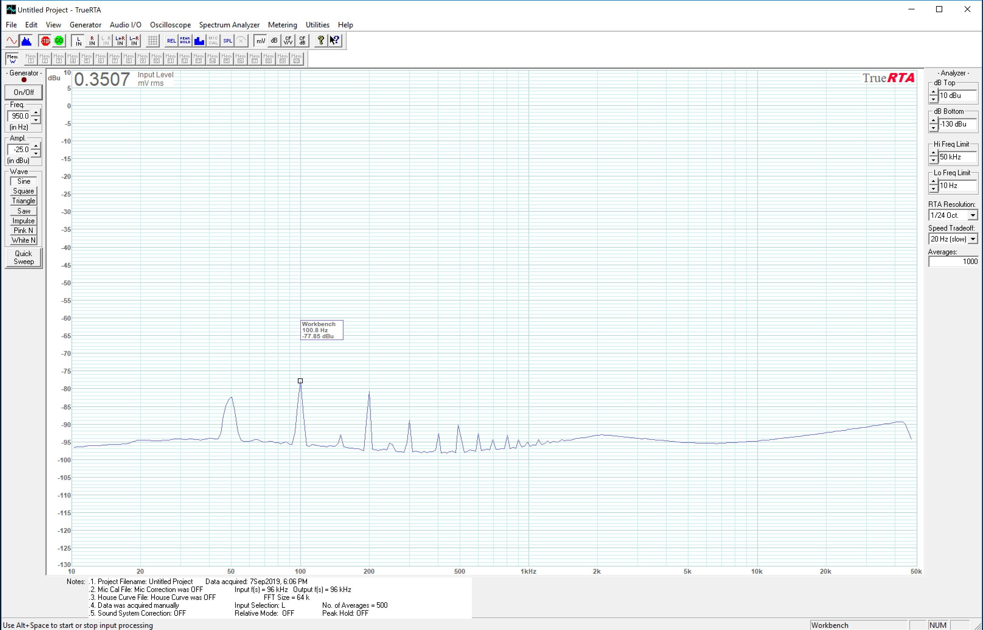

I looked at the Mani outputs with a simple test rig: Laptop connected to an external sound card via USB (192khz/24bit resolution) connected to the Mani RCA outputs. For the test the Mani is set to Low output MC mode (Gain 1 set to High, Gain 2 set to Hi and input set to 47 Ohms, which is how I use it for the Hana ML). I use the TrueRTA software on the Laptop to yield a spectrum of the Mani RCA outputs.
This is where I found the likely problem. The figure below shows the TrueRTA spectrum returned from the Mani RCA output, this shows multiple power supply harmonics related to the rectification of the 16VAC power source at 17db above the noise floor. The Left channel shown, the right channel was similar but some 6db lower. The primary rectification signature is at 100Hz with harmonics each 100Hz. An internal 50Hz signal associated with induced hum from the 16VAC is also visible.
Figure – Left channel power supply harmonics

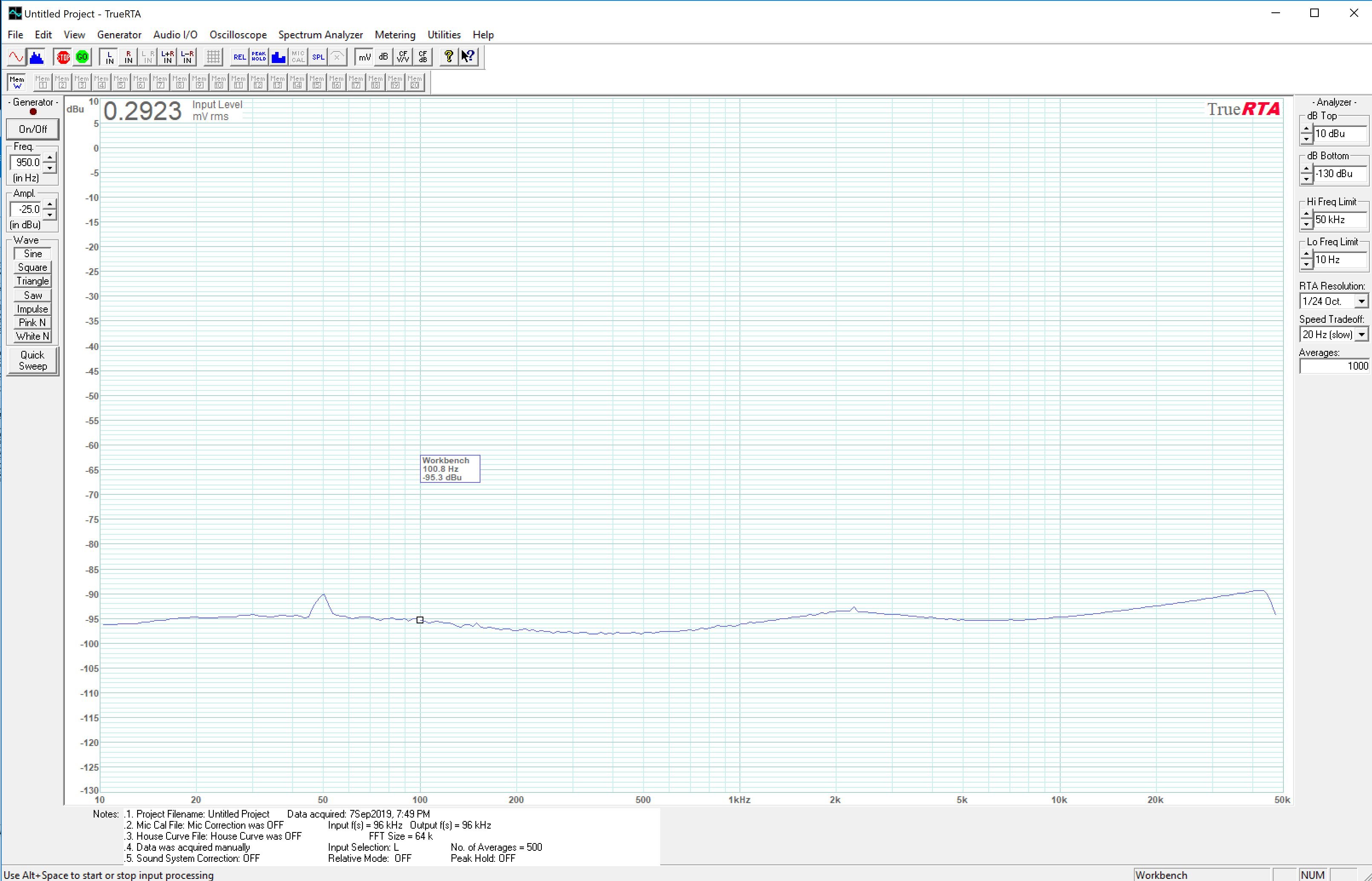

I identified the reason for the AC rectification harmonics and implemented a change. The following Figure is the Left channel after modification. Test Rig set up is identical to the Figure above so the two spectrum's are directly comparable.
Figure – Left channel power supply harmonics after Mani modification
The result now is that the power supply rectification harmonics are no longer present and the internal 50Hz induced hum is 7db lower.
