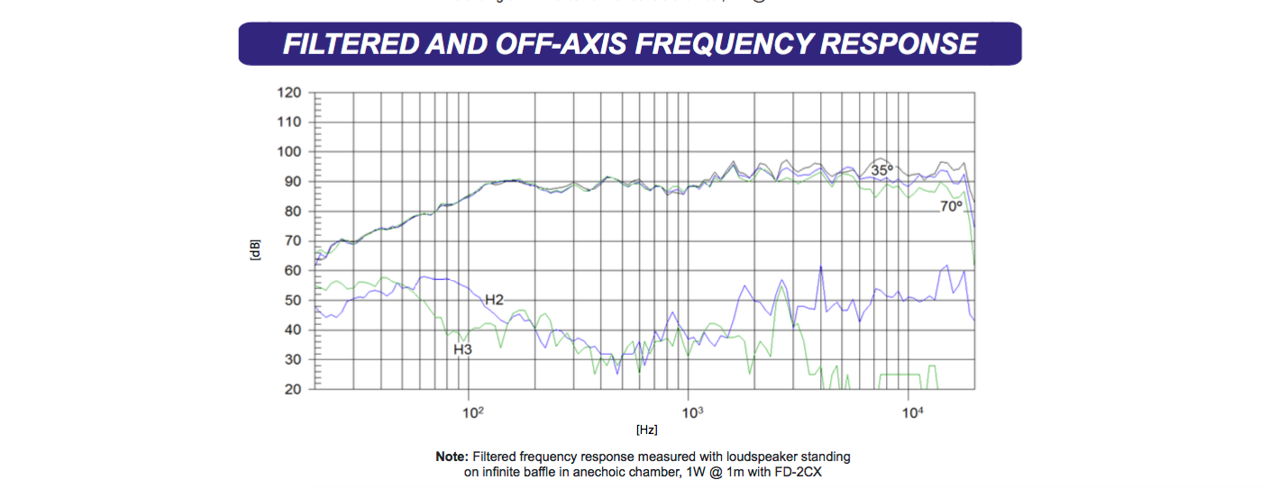

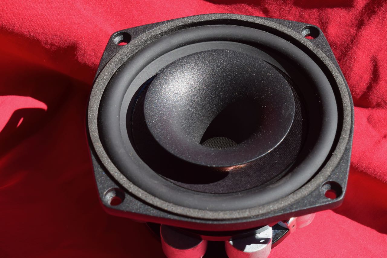

Wide sound field is perhaps the most underestimated aspect of any loudspeaker and this system has a sound stage around double a typical passive system. The five inch midrange is a key to wide dispersion. It covers the critical midrange and gives incredible dispersion.. The horn tweeter then takes over and goes right out to 20k.

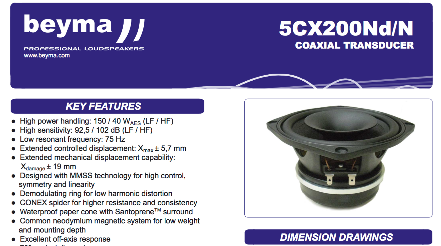

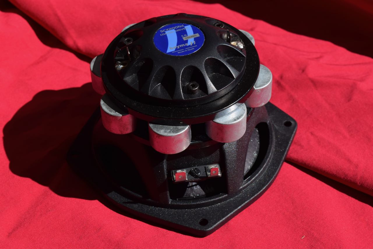

  These drivers are 2ea of:

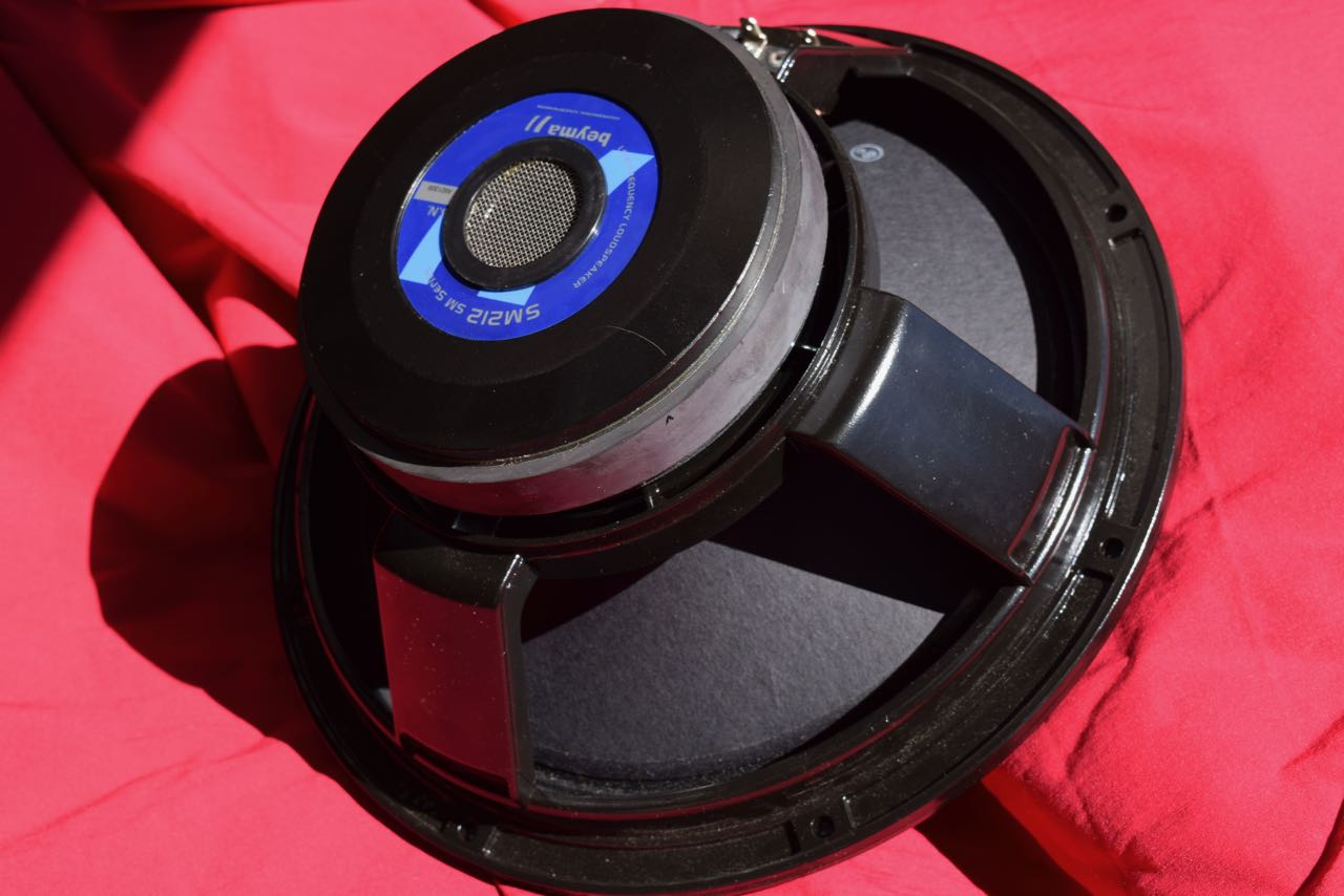

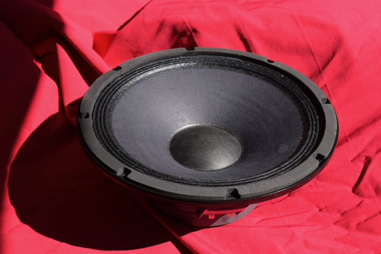

1. High efficiency Beyma 96db/watt woofer rated at 350watts continuous Rolled cloth surround. Cast frame. Vented pole piece.

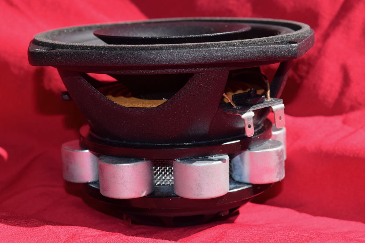

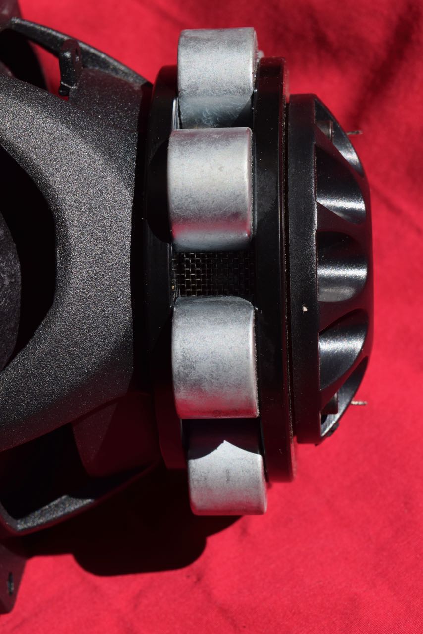

2. Beyma Midrange unit to match with cast frame, underhung neodymium magnet system
3. Beyma Horn tweeter with radial flare giving 70 degree dispersion
Not just high performance, but long-lasting. All units should be fine for a fifty year life span, at least.

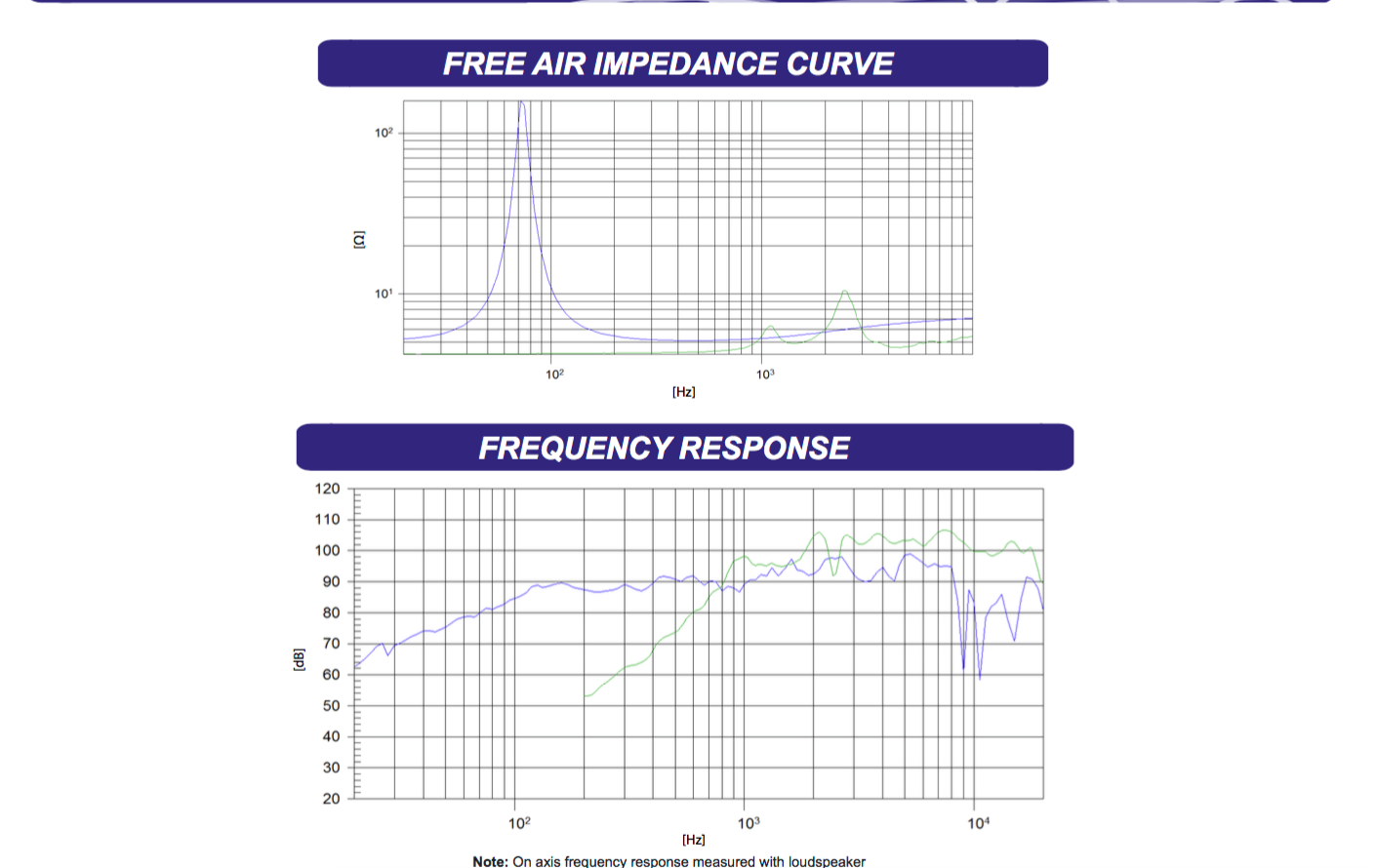

The woofer is mounted in a 100l box and the system will give a true 39Hz at around 94db/watt. Up to a  500 watt/ch amp can be used quite safely, as these drivers are pretty much bullet proof!
The dbx cuts off  frequencies below 40 Hz and sums them to a stand alone subwoofer ( not included in this project). 39H is actually far lower than most commercial hi fi speakers.  The Wizard only achieved 48Hz for example and it was an immensely popular loudspeaker.
The 24db crossover allows precise control of the crossover points and reduces distortion drastically as the drivers never actually receive a signal which is stressing the driver.
