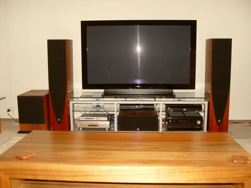

By way of example, this was our set up after participating in one of the Pio GBs: post-4905-1279688374_thumb.jpg Yorac's Elektra was added in early 2008 and is still going strong.

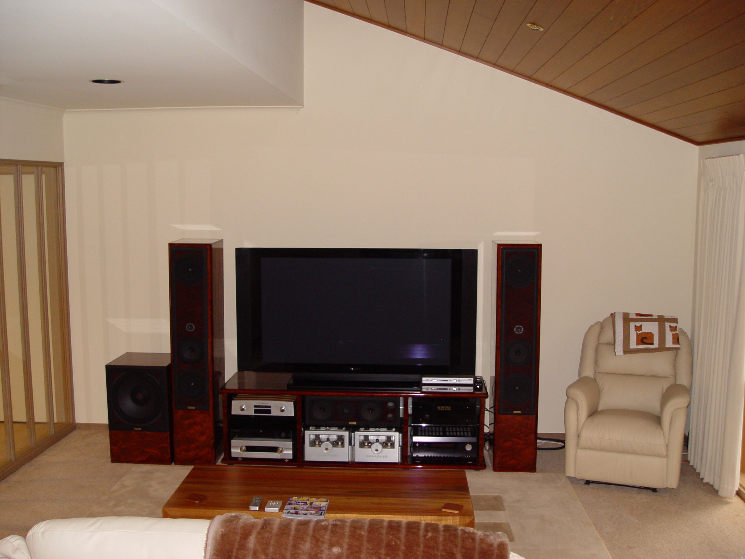

In the pursuit of some better sound we upgraded the stereo gear and all speakers mid 2009: post-4905-1279688526_thumb.jpg I've been more than happy with Greg Osborn's gear.

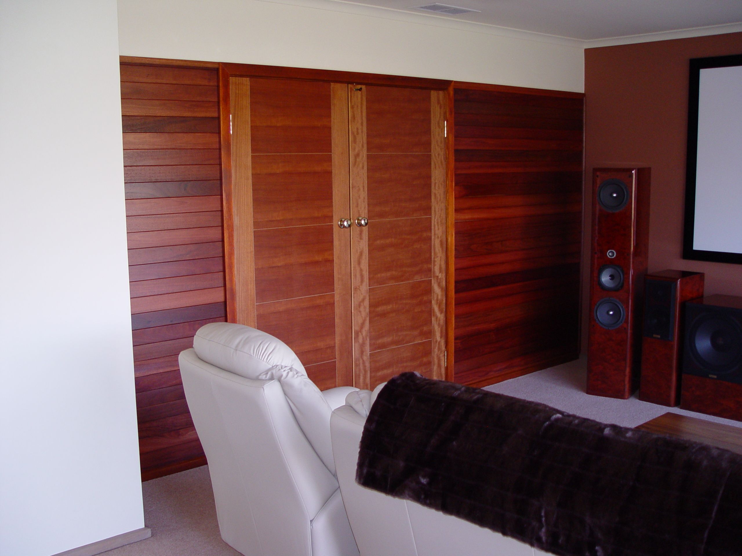

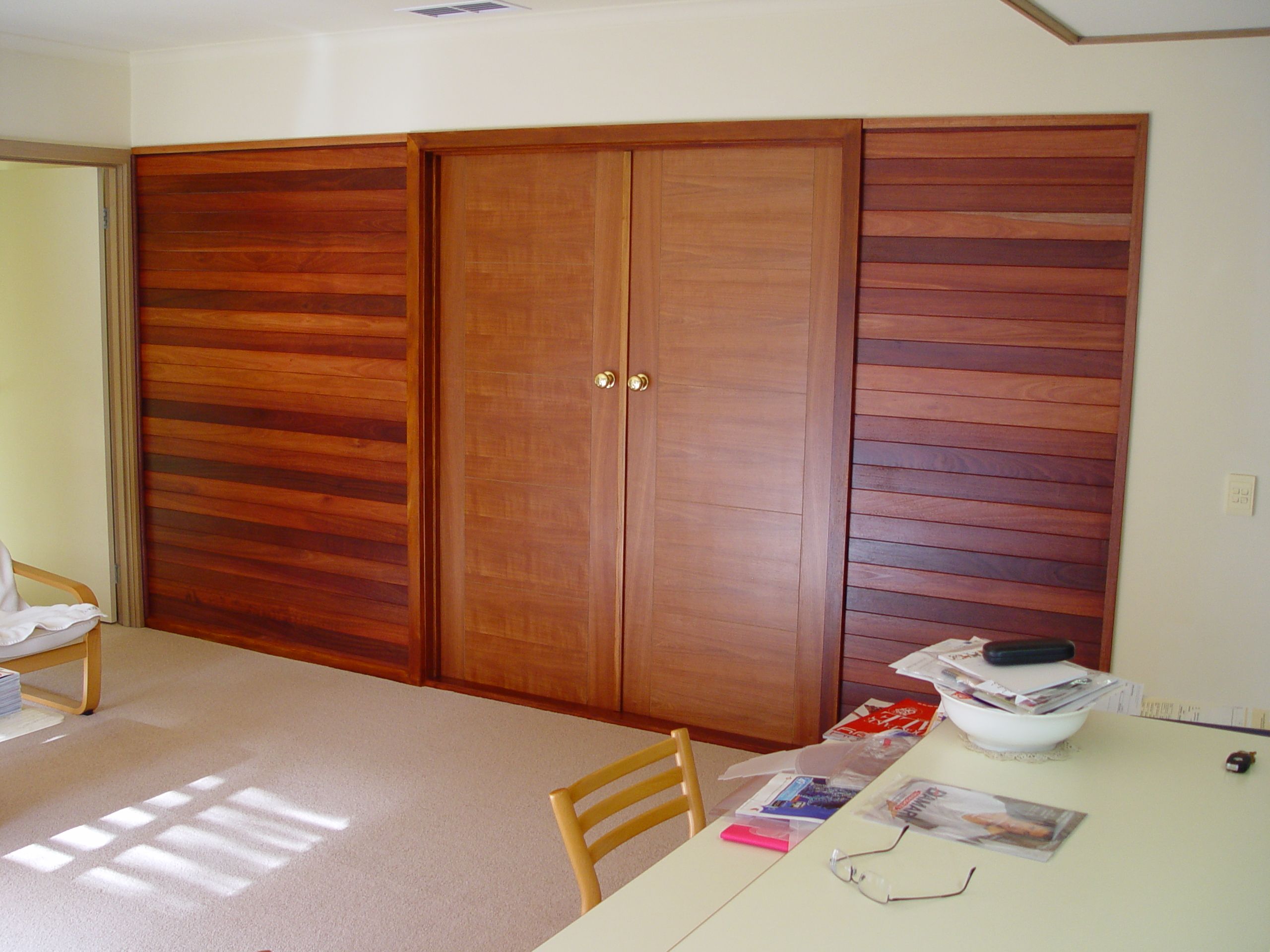

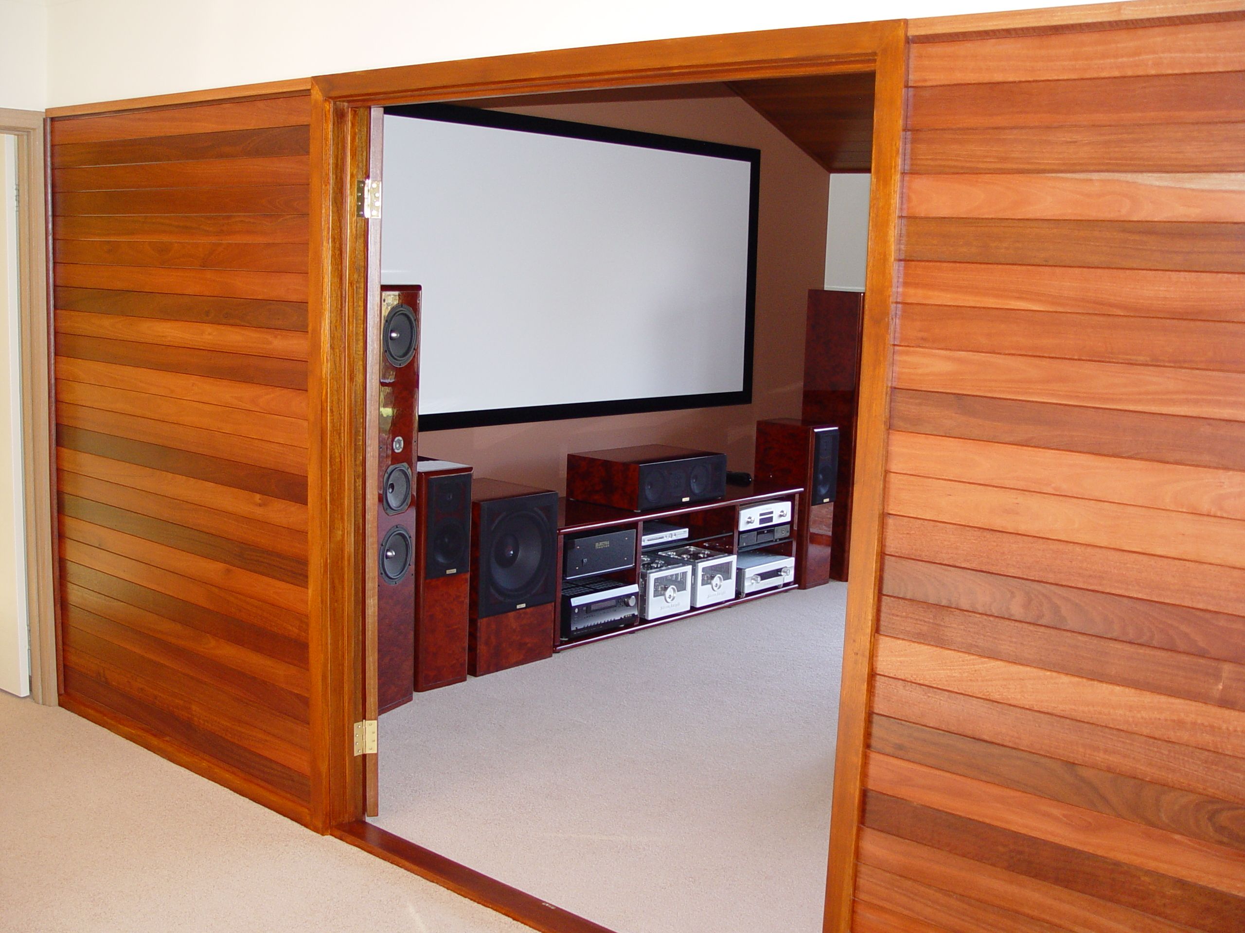

At the GTG at Selbys a few months ago I was mightily impressed by Mark's Mk4 lens (the Mk3 and corrector were also very good) and finally made the call to get a projector and set up a basic HT. The glass and timber divider you can see in the 2009 photo was replaced with some timber lining and doors for light control - had a chippy in to do the work and you can blame me for the paint.
From the kitchen family area: post-4905-1279688628_thumb.jpg
Doors open: post-4905-1279688676_thumb.jpg

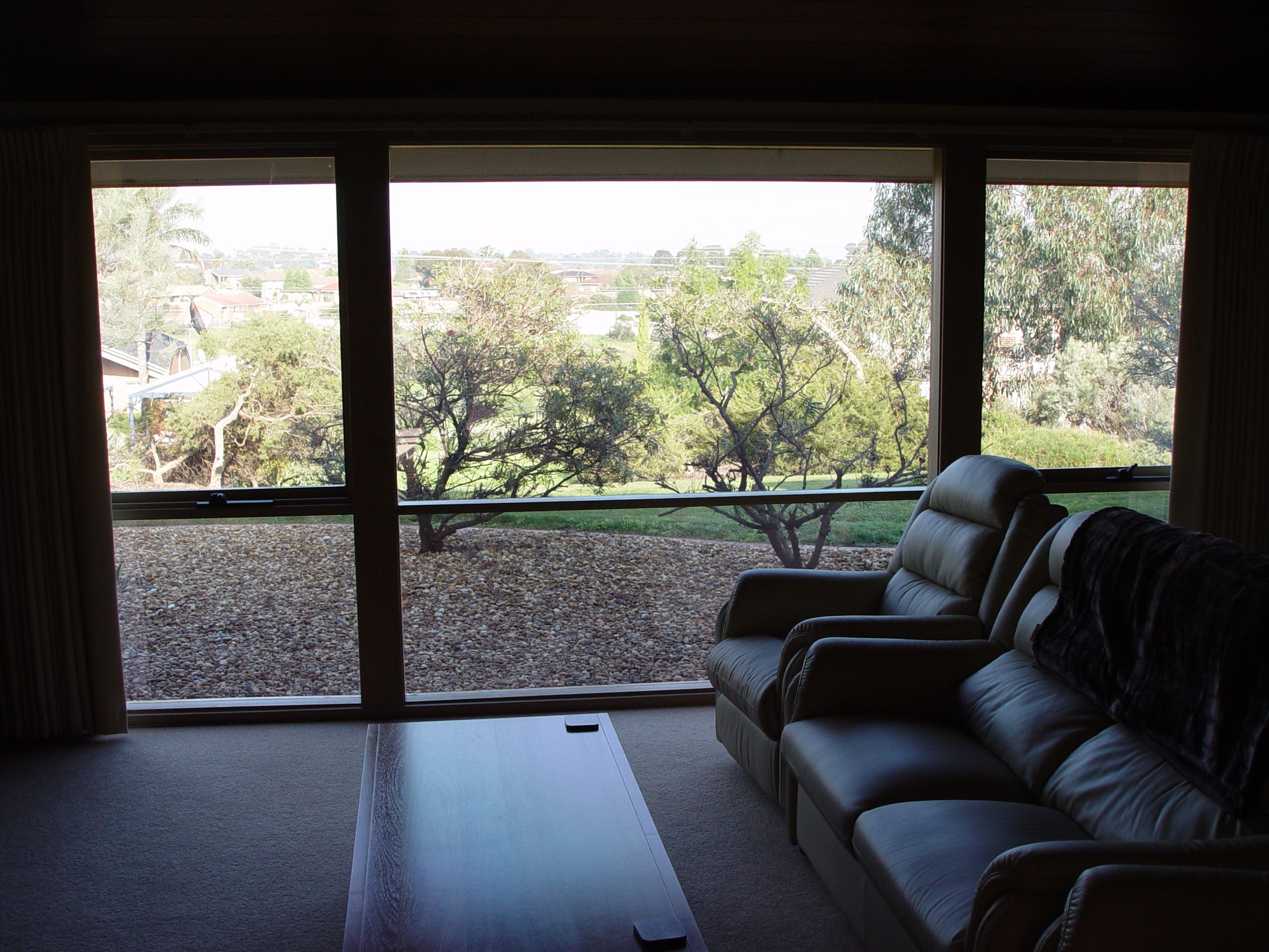

The windows in the room are a bit of a problem, even with good curtains. post-4905-1279688781_thumb.jpg Thanks to Drizt and mr-happy-pants for the suggestion of adding some timber above the curtain rail instead of the trouble of building a full pelmet. :D

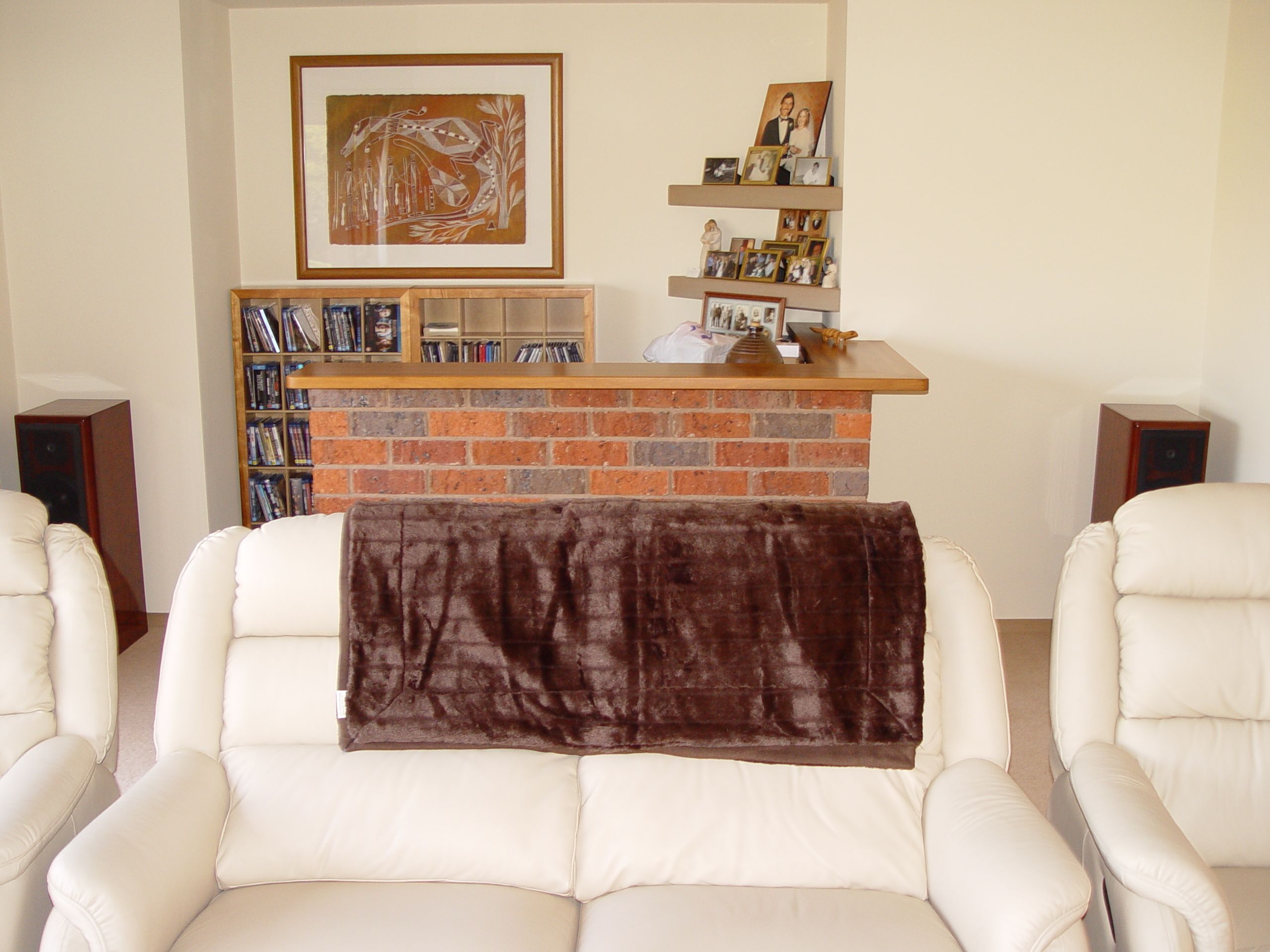

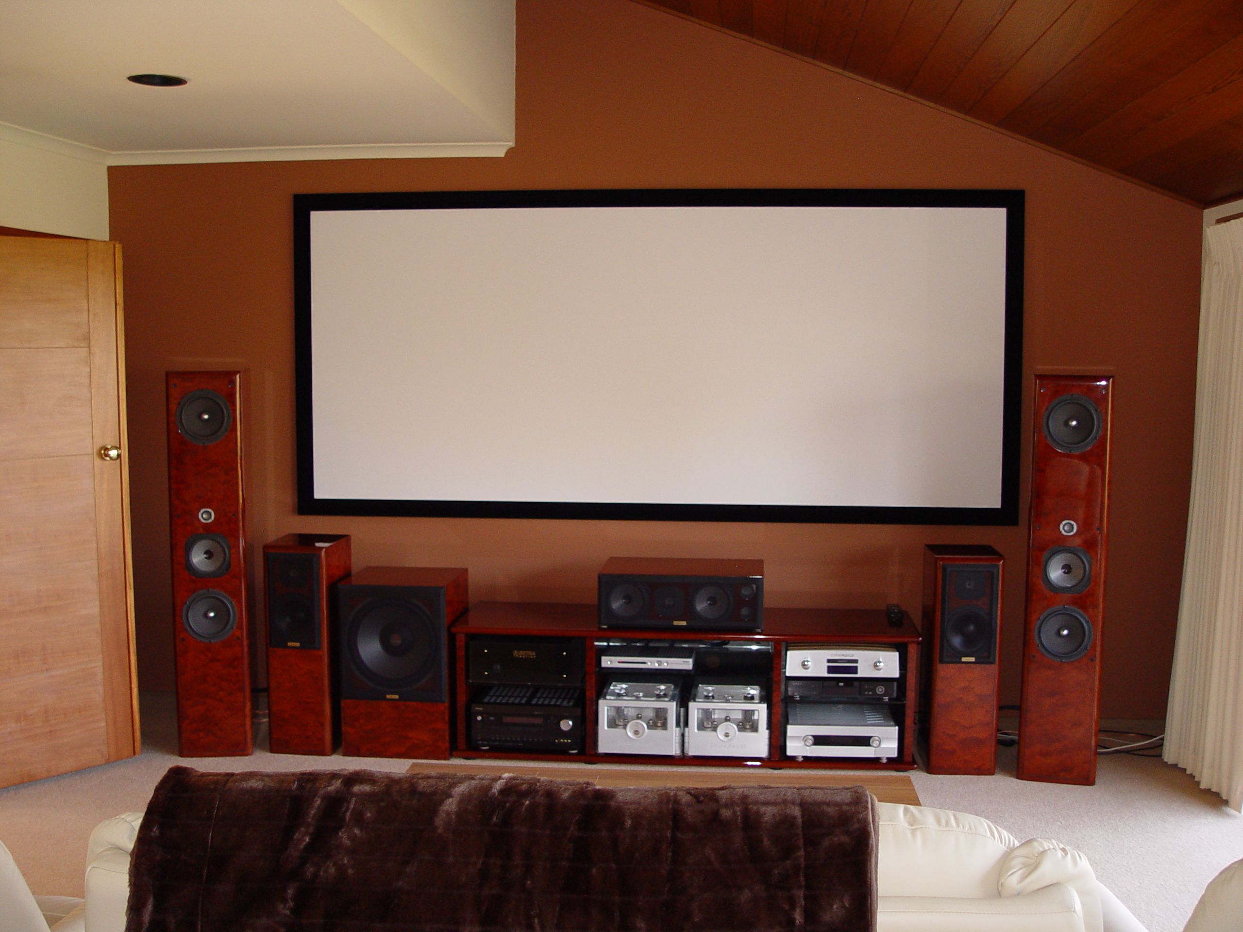

Some shots of the room as it's now set up.
post-4905-1279688926_thumb.jpg That's an OZTS 130" scope screen courtesy of Selby. We recently picked up a couple more F4 supers for the HT L/R channels so the HT and stereo systems are now separated from each other (no need to run the valve amps for HT duties [a waste] and the stereo gear doesn't have remote on/off functions, which has caused low WAF [sWMBO is happy the HT system is again operated through just the Harmony remote]).

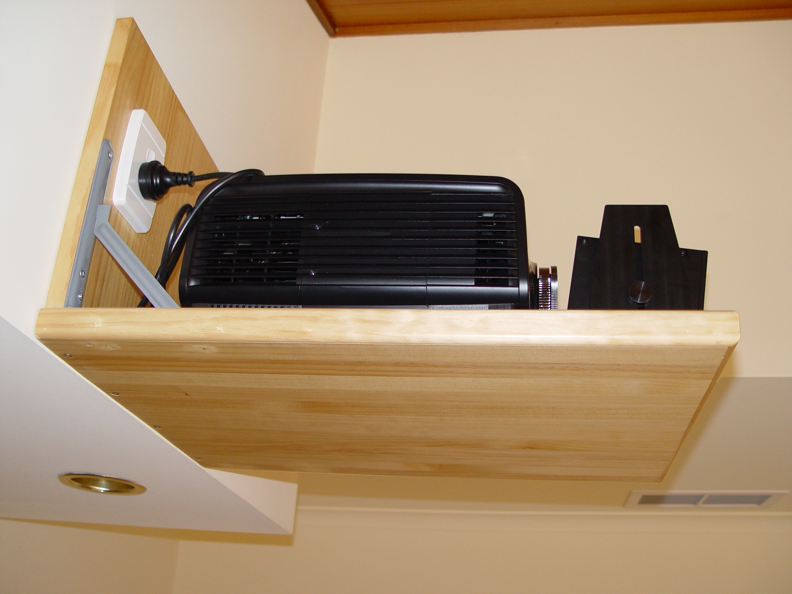

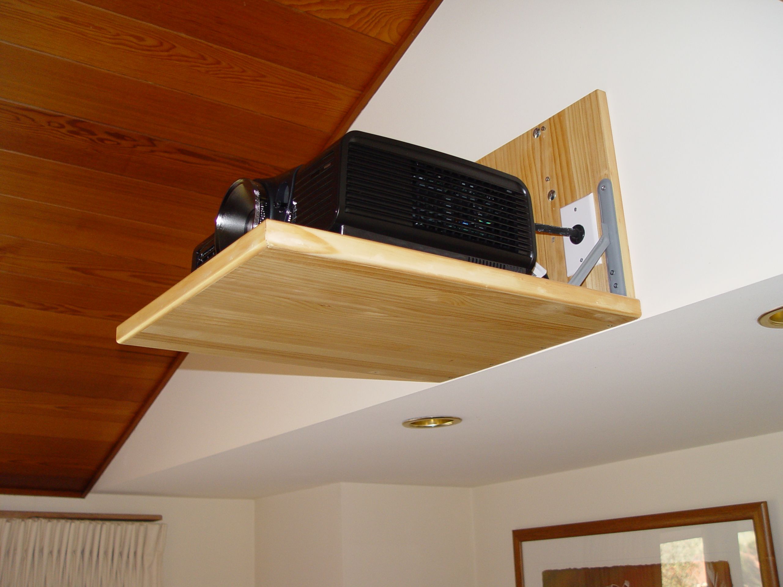

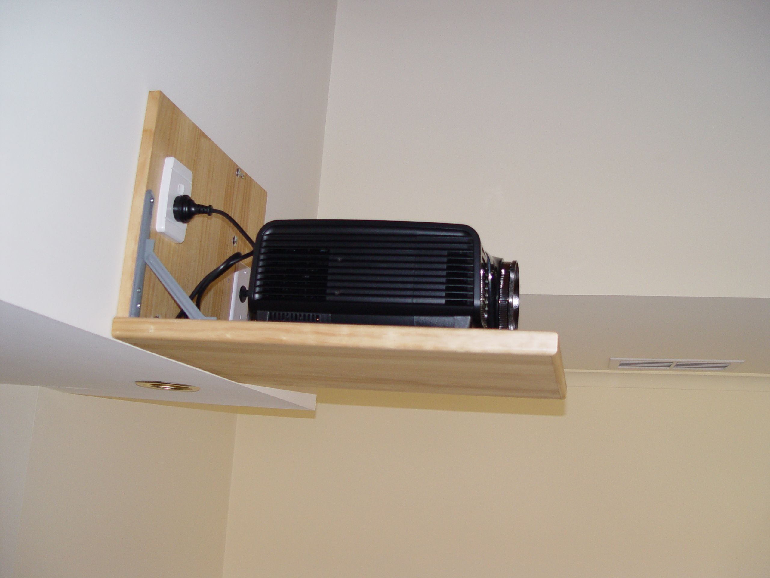

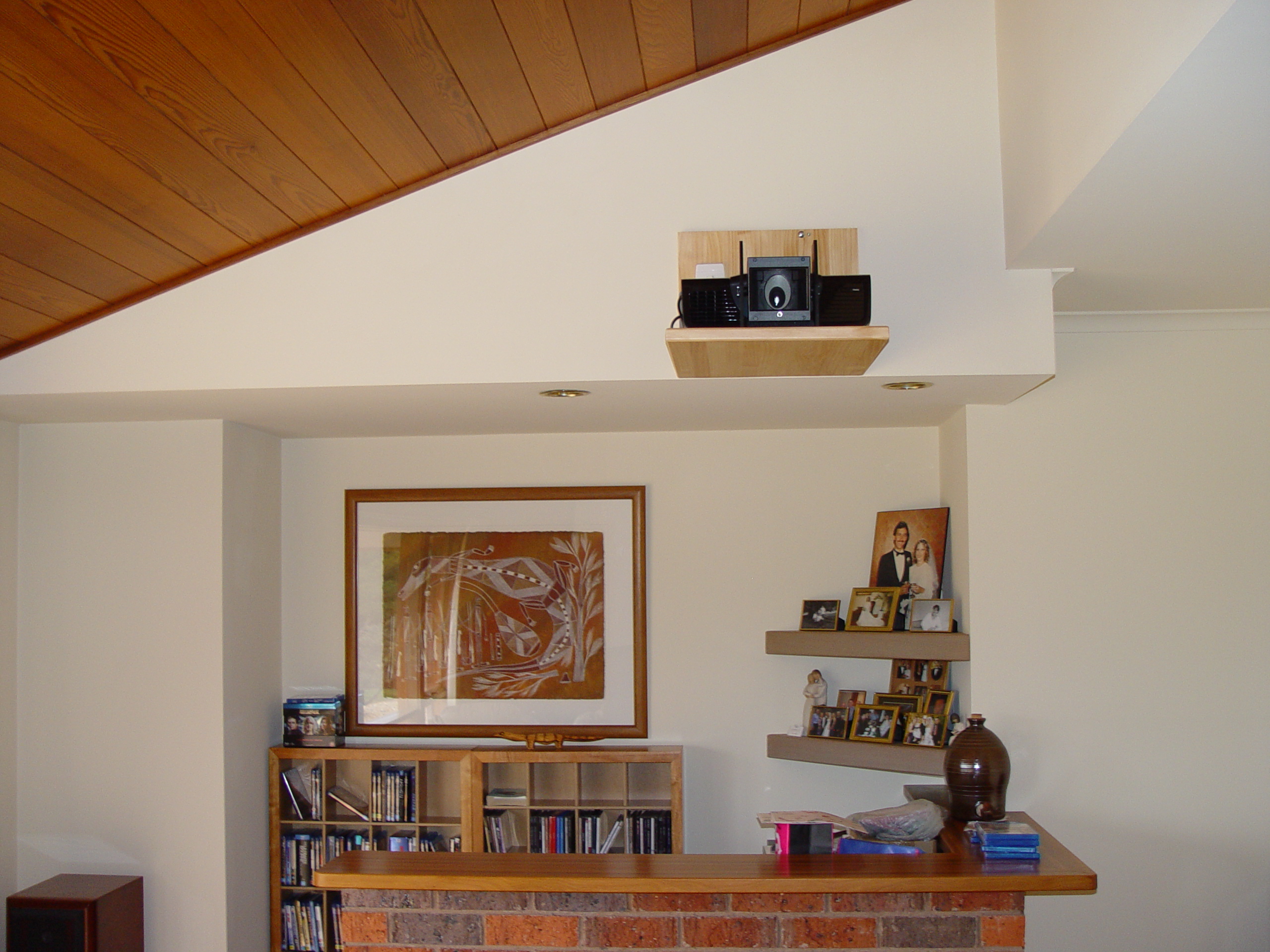

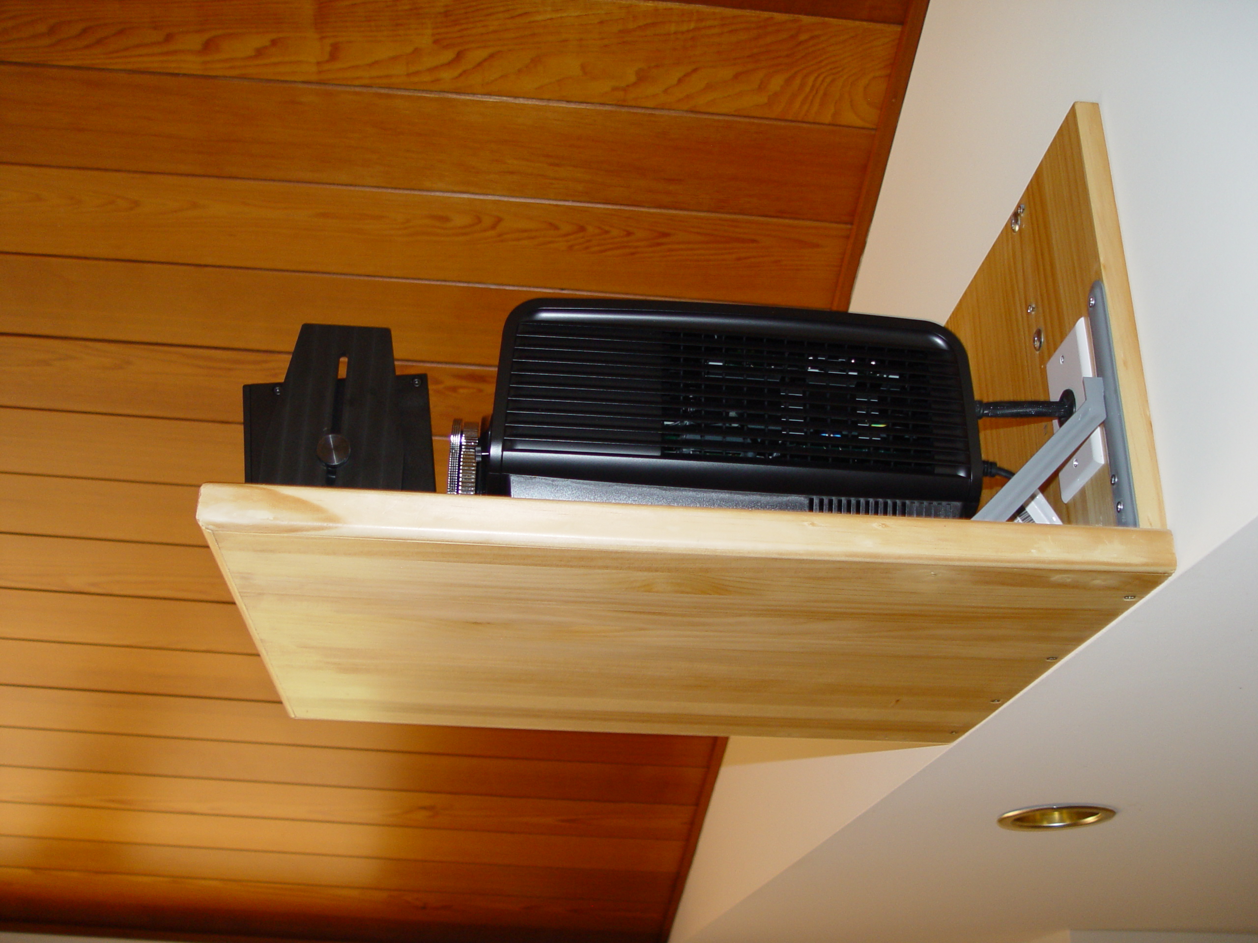

Bunnings AV solutions :lol: to hold the BenQ W6000 (thanks Jason V for a great price) :D

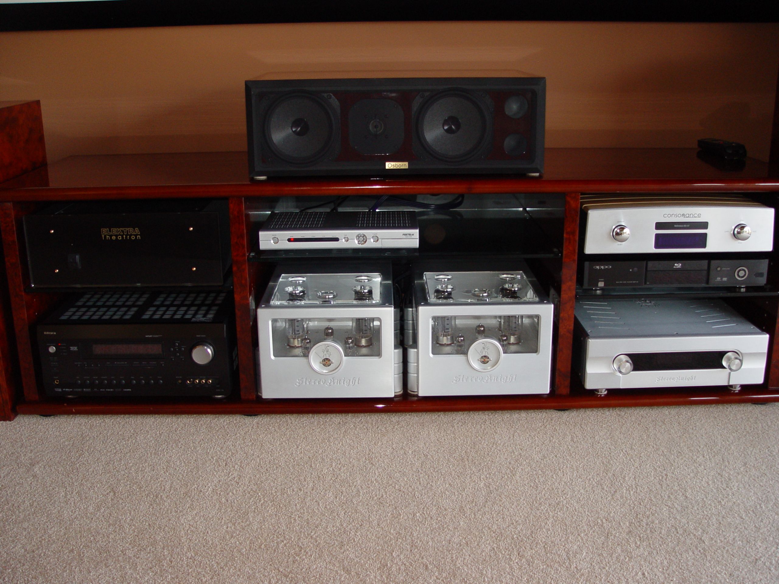

A photo of the HT and stereo gear (the entertainment unit was ordered through Greg Osborn - believe Aranmar Acoustics make all his cabinets - great WAF factor!)

I too, am a big fan of timber. It looks like western red cedar for the horizontal panelling, but what timber are the doors constructed of? All looks very nice and warm and a great invitation to what lies ahead!
How do you find the acoustics with the sloped ceiling?

Hi 709er, there's western red cedar on the ceiling, but we went with jarrah on the wall, as it's a lot harder (we have some WRC on another wall in the house and even though it's not a high traffic area, it's picked up a few minor marks over the years [being very soft]). The wall is in a high traffic area so we wanted something that wouldn't mark too easily. The doors are a cherry veneer (made by Statesman Doors in case you're interested).
Yes, WAF = wife acceptance factor - she indulges me in this hobby most of the time and I do try to make some concessions so it's not all one way. Hope your HAF is high.
The acoustics of the room are reasonable - I suspect the vaulted ceiling doesn't help (probably more so with stereo imaging than HT), nor do the large windows (bass leakage), but the slightly complicated shape does seem to mean we don't have too many nulls.
Some very nice gear.
And yes, I can see the WAF in the cabinets :D :D :D
Thanks Jutta - the quilted bubinga finish meant high WAF (luckily it's not causing many issues with reflections off the screen).

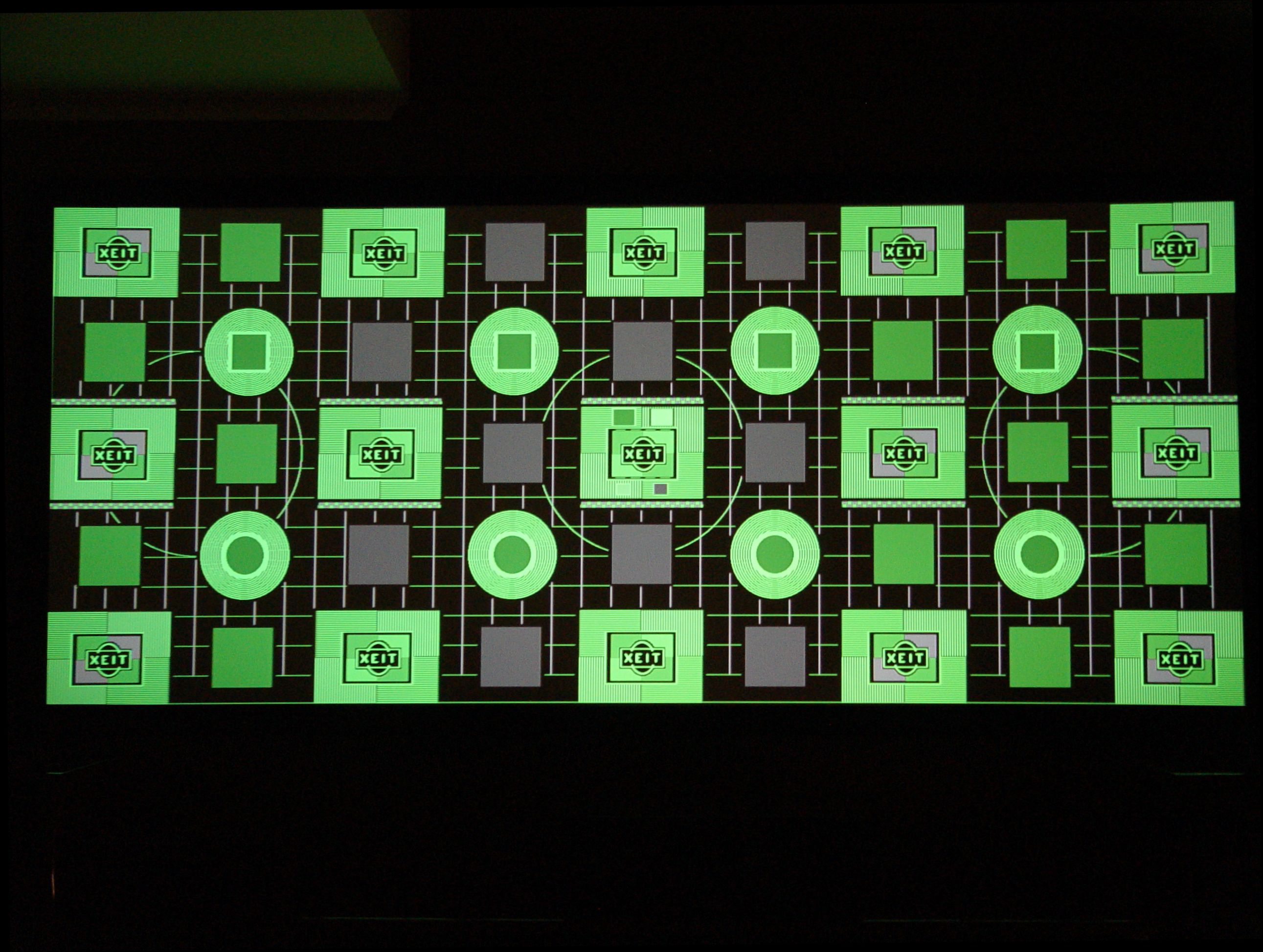

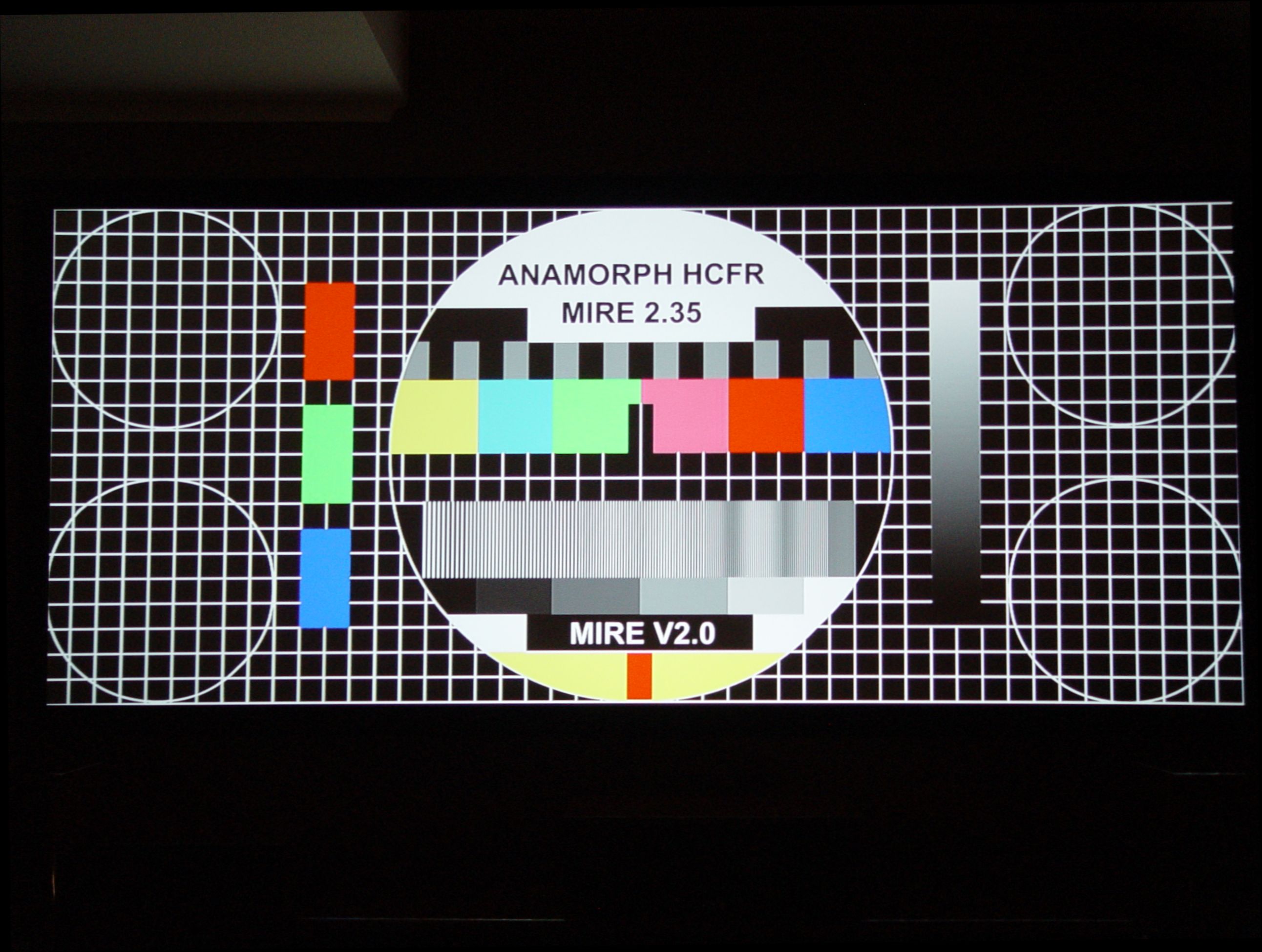

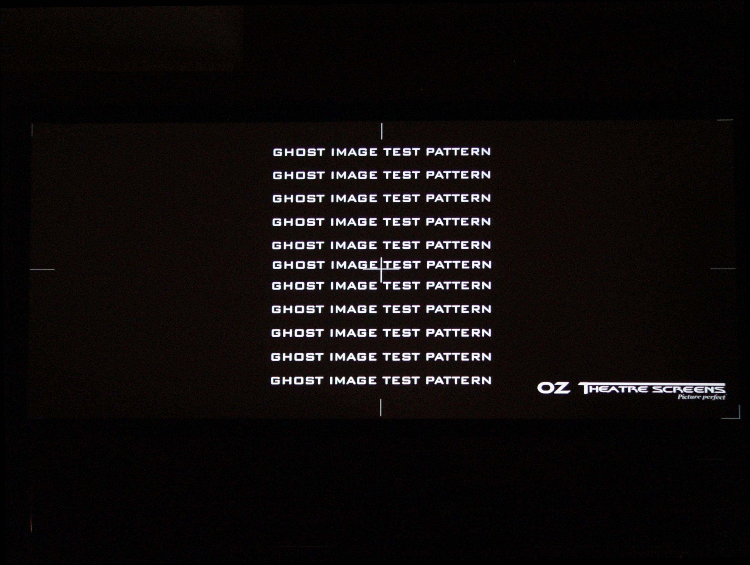

A few new photos with the Aussiemorphic Mk 4 lens in place:

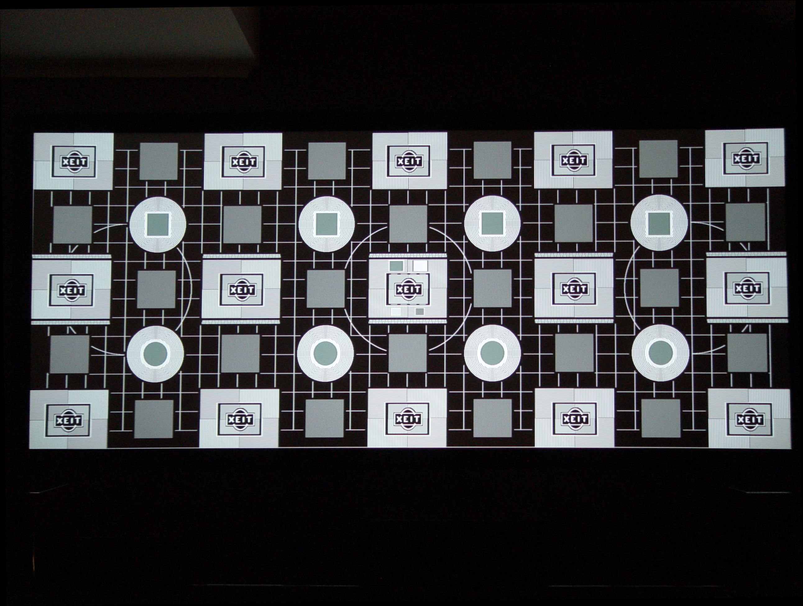

A few test patterns:
There's some vertical pincushion effect introduced by the camera lens - it doesn't exist in real life. There's virtually no pincushion effect from the Mk 4.
If you zoom Test patterns 2 and 4 you may notice some softness on the vertical lines on the far left and far right - this is a limitation of the W6000's optics, not the Mk 4. The W6000 is giving a little chromatic aberration because I'm using some horizontal lens shift - can get the left or right side sharp, as well as the centre, so have compromised on both sides being a little soft.
You'll probably notice that all of the photos are a little soft - the sensor on my camera is from an era when some were susceptible to degrading from humidity - after 7+years it's succumbing. It's much worse in low light situations, so I haven't loaded any movie images, as they don't give any idea of the actual picture quality (which I think is sensational). Need to buy a new camera at some point... :(

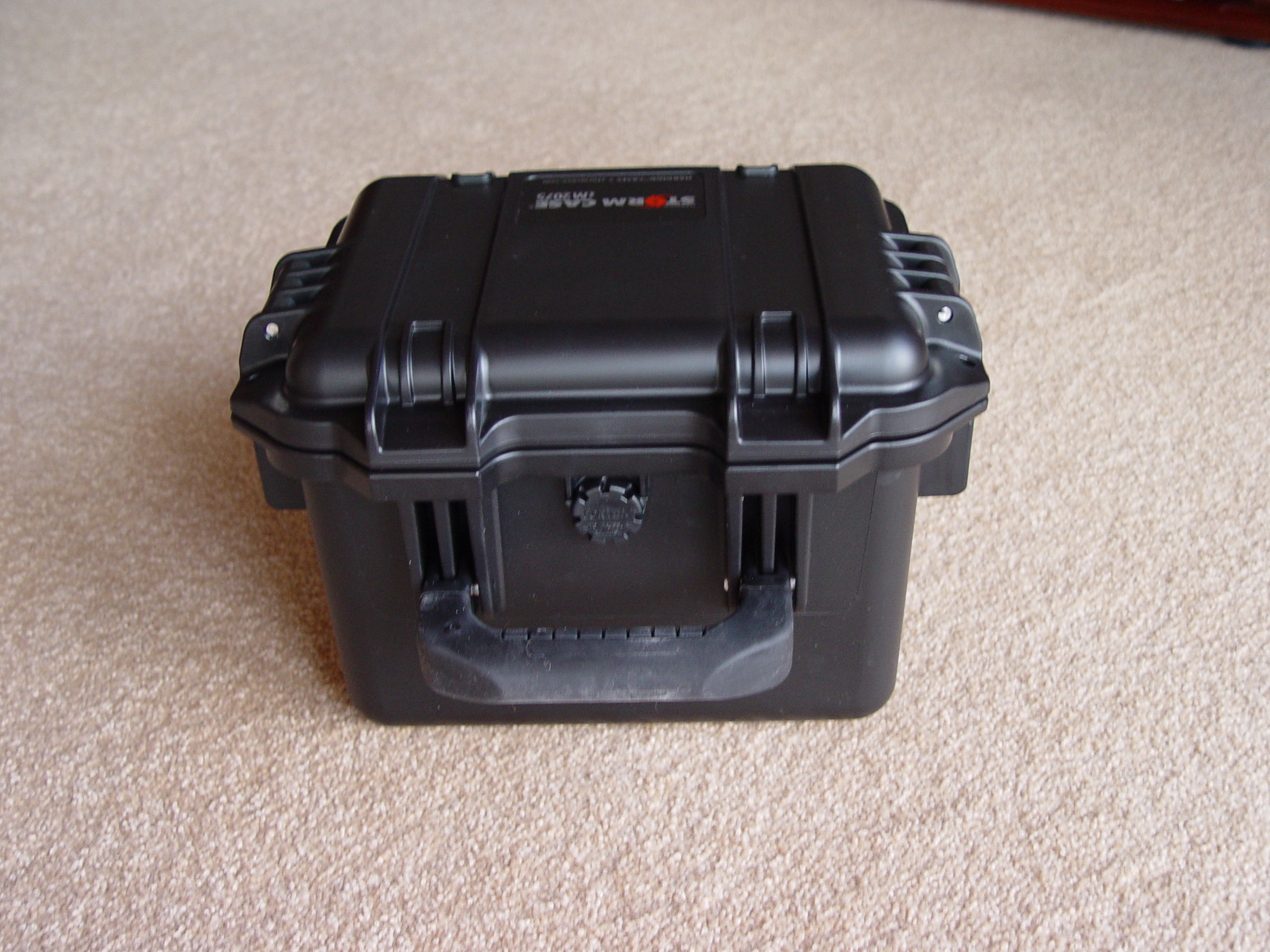

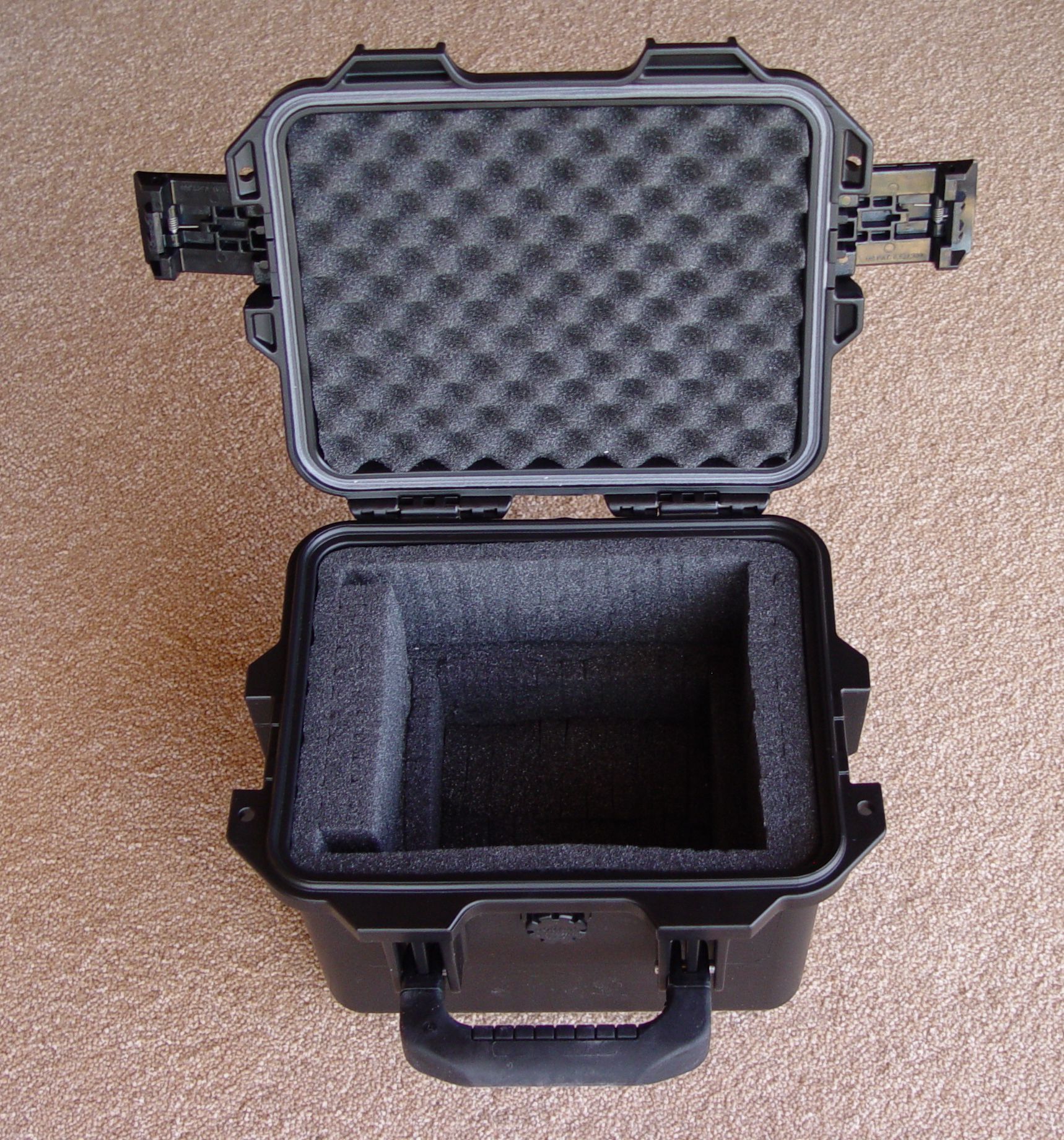

Finally, a couple of pictures of the storm case the Mk 4 now ships in - very nice Mark. :D
Must say I'm very happy with the Mk 4 lens. :D

Well done Quark. I know how much you wanted an Anamorphic Lens. The patterns look well nigh on perfect!
Great setup.
Cheers
Blade
Thanks Blade, yes the optics on the Mk4 are exceptionally good. :D
