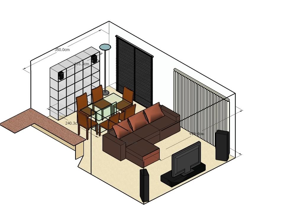

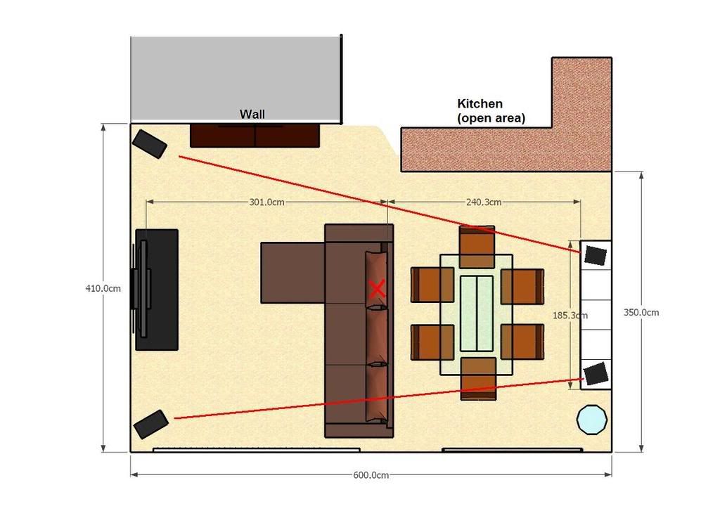

CLLee Posted November 28, 2008 Posted November 28, 2008 (edited) Hi guys, Firstly, thanks for all the info here that I've been reading for the past few months before setting out to buy my first HDTV (Pana 50" HD plasma). Very very helpful indeed. Back to my question. I have a 5.1 HT system set up in my living/dining area. Here're the diagrams (to scale) http://i64.photobucket.com/albums/h165/cll...Theatre3D02.jpg http://i64.photobucket.com/albums/h165/cll...heatre3D01b.jpg Due to the 'wife factor,' I'm unable to mount my surround speakers on the side. They don't fit into the deco and sort of in the way of traffic. So, I placed them on a shelf unit behind the dining table. The obvious advantage is that I get surround sound while watching TV at the dining table. However, I'm a bit concern if I'm getting the correct soundstage when I'm seated at the couch. Will this work, or I really should put them on the side? Any suggestions or feedback would be great. Thanks. Edited November 28, 2008 by CLLee
50mxe20 Posted November 28, 2008 Posted November 28, 2008 Well this is the bible http://www.dolby.com/consumer/home_enterta...oomlayout2.html So if you can figure out a way to get them at 110 degrees it would be better.
huang Posted November 29, 2008 Posted November 29, 2008 Well this is the biblehttp://www.dolby.com/consumer/home_enterta...oomlayout2.html So if you can figure out a way to get them at 110 degrees it would be better. also, you'll want them at ear level whilst sitting, so putting them a couple of shelves down might do you some good.
POV Posted November 29, 2008 Posted November 29, 2008 also, you'll want them at ear level whilst sitting, so putting them a couple of shelves down might do you some good. You don't want surrounds at ear level, you want wide dispersion from a surround field not directional staging. Best to have surrounds about 60 cms above seated ear level. Drew
CLLee Posted November 29, 2008 Author Posted November 29, 2008 (edited) You don't want surrounds at ear level, you want wide dispersion from a surround field not directional staging. Best to have surrounds about 60 cms above seated ear level.Drew They do have a wide dispersion in that position, and totally un-localised. I hear them in explosions and stuffs, but they are almost not there (can't hear them) most of the time. Is that a good thing? I'm trying to find a movie that has good 'rain effects' so that I can test out the overall sound field. Any suggestions? Also, is there anywhere I can download that Dolby Trailer with the space ship to test on my system? the one from this link: http://www.dolby.com/consumer/home_enterta...oomlayout2.html Edited November 29, 2008 by CLLee
