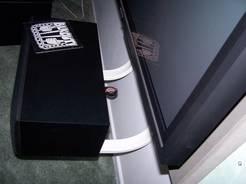

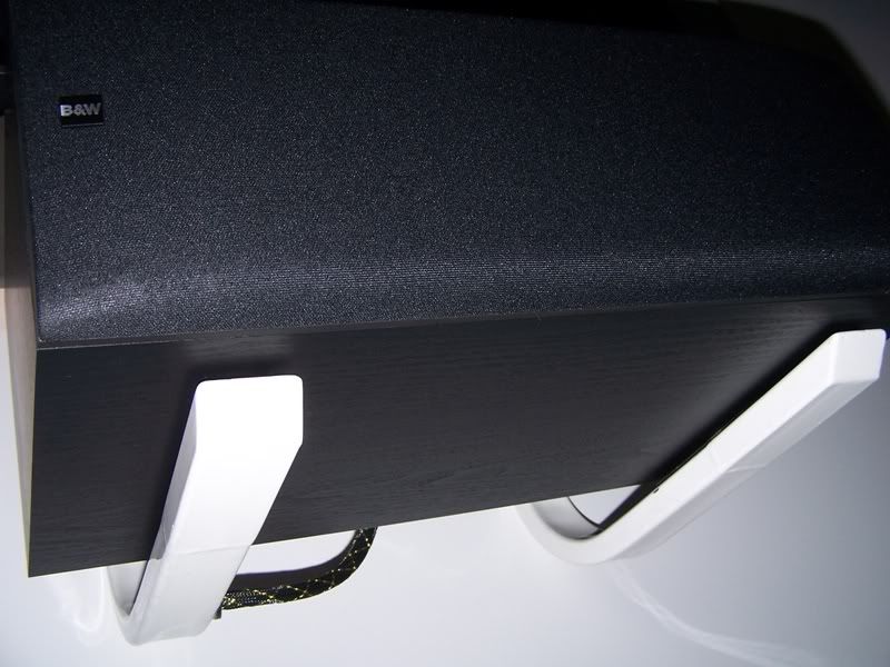

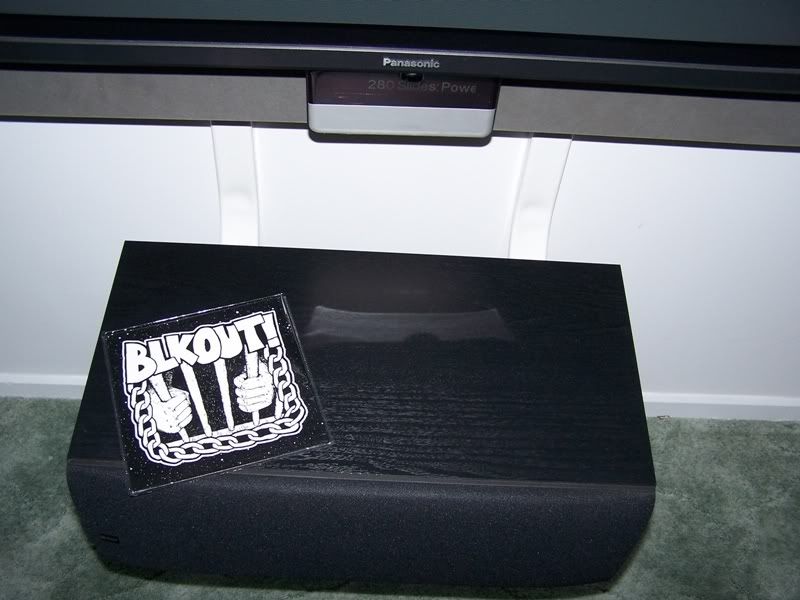

moochy1503560064 Posted October 13, 2008 Posted October 13, 2008 (edited) heres my DIY attempt last year http://i78.photobucket.com/albums/j99/pr1mo82/Picture636.jpg http://i78.photobucket.com/albums/j99/pr1mo82/Picture643.jpg http://i78.photobucket.com/albums/j99/pr1mo82/Picture644.jpg Edited October 13, 2008 by moochy
