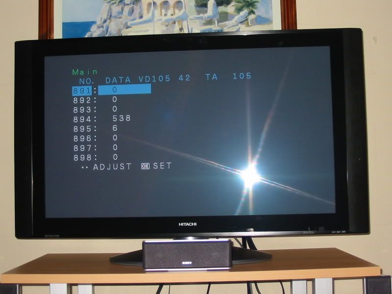

pjc Posted February 10, 2007 Share Posted February 10, 2007 Any one else here own one? I'm trying to figure out how to see the hours on? I'm keeping a log myself, but I'm curious to see what the 9500 thinks it's on hours are.Mark Get into the service menu (how to is in the 8800 thread - likely to be the same for the 9500) and record every line which is likely to correlate to hours used. Especially now the panel is young - should only be in low tens perhaps but you should know as you have a log. Then go back after a week and only the hours used should have changed and bingo...that line is the hours used. Someone with the 8900 did this and helped out all those who were interested. Good luck Philip Link to comment Share on other sites More sharing options...

GP11 Posted February 11, 2007 Share Posted February 11, 2007 Hey guys.. be careful in the service menu.. if any values are changed accidentally and you haven't taken note of the prior values, you could well and truly stuff up your panel. The hrs usage on the 8900 is line 894 and if you toggle through the 900 odd lines its easier to use the remote up and down (center toggle).. being v/careful not to sideways toggle. Remember.. do this at your own risk as it can be a minefield if your not confident of what your doing. The method of accessing the service menu for 8800/8900/9700, should be the same for the 9500/960D Here btw. I saw the 9500 in JB's this morning for $1995 Link to comment Share on other sites More sharing options...

GP11 Posted February 11, 2007 Share Posted February 11, 2007 OK..slight update. Using the method from the 8800 post does not work. I got caught at first because I must not have been pressing the 'down' arrow properly. Pressing the standby button and the input button for 5 seconds brings up the 'Diagnosis' menu. A bit of finger trouble on my part! Back to square one. Hi mxb I just did mine again... but it may be different for the 9500.?? things to note.. Make sure TV is in standby mode and no AVs are on.. Press the sub-power button AND the input select button AND the down-arrow button at the same time and hold for more than 5 seconds Note.. "I had to hold for almost 10 secs for the menu to come up.." The top of the menu looks like.. MAIN. NO.... Data.......VD105......42......TA....105 1.... 8 2.... 8 3.... 0 etc * etc * etc 894.......518... (this is my current hrs of use) * * 900.. (this is the 8900 end value) 1.... 2.... and it starts again , as you toggle through.. ( either up or down) I use remote up and down. I guess if this doesn't work you'll have to check other o/seas forums for clues fot your panel. Good luck.. Link to comment Share on other sites More sharing options...

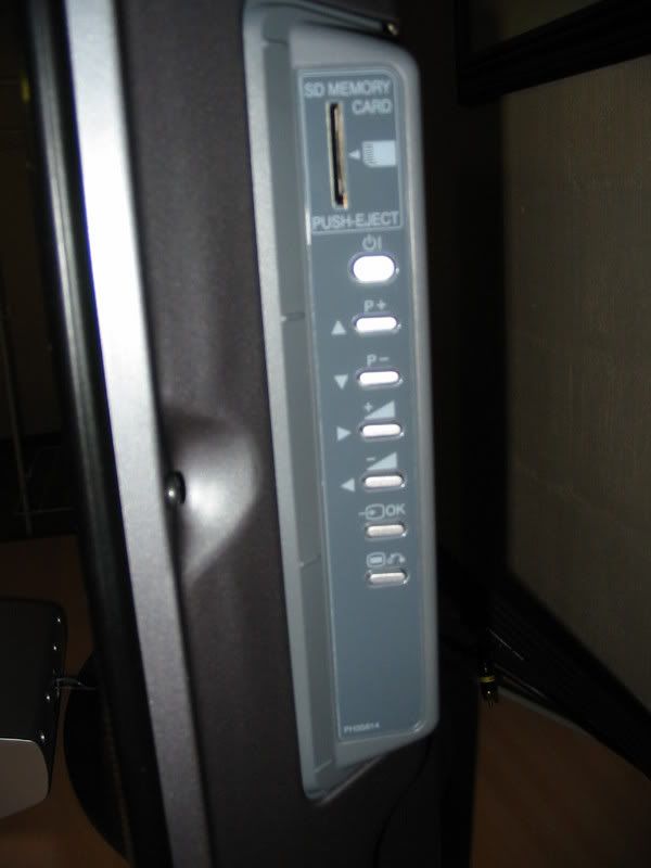

mxb Posted February 12, 2007 Share Posted February 12, 2007 I have tried to find a pic of the side control panel on the 9500.. maybe its different to 8800/8900/9700 ??... Here's a pic. Anything different? http://members.iinet.net.au/~mxb/9500panel.jpg Link to comment Share on other sites More sharing options...
GP11 Posted February 12, 2007 Share Posted February 12, 2007 This seems to be the problem. the 9500 has a duel up/down button. I did read over on the avforum where someone posted that you didn't need to hit the down button to get into the menu... Maybe just hold the sub-power button AND the input select /ok.. for 5+ seconds ?? (at your own risk) . BTW this doesn't work on 8900. Otherwise I think it's back to square one. The 8900 side panel. http://img.photobucket.com/albums/v394/c4d55/tv004.jpg Here's a pic of the 8900 menu http://img.photobucket.com/albums/v394/c4d55/menutv003.jpg Be careful.. I inadvertently changed a value when I tried to swivel panel while taking a pic.. Link to comment Share on other sites More sharing options...
mxb Posted February 13, 2007 Share Posted February 13, 2007 This seems to be the problem. the 9500 has a duel up/down button.I did read over on the avforum where someone posted that you didn't need to hit the down button to get into the menu... Maybe just hold the sub-power button AND the input select /ok.. for 5+ seconds ?? (at your own risk) . BTW this doesn't work on 8900. Ahhh. I've actually tried just pressing the sub-power and the input select. You get a display that says "Diagnosis" with a some other stuff on it, but you cannot navigate anywhere. As you say, back to square one. Link to comment Share on other sites More sharing options...
