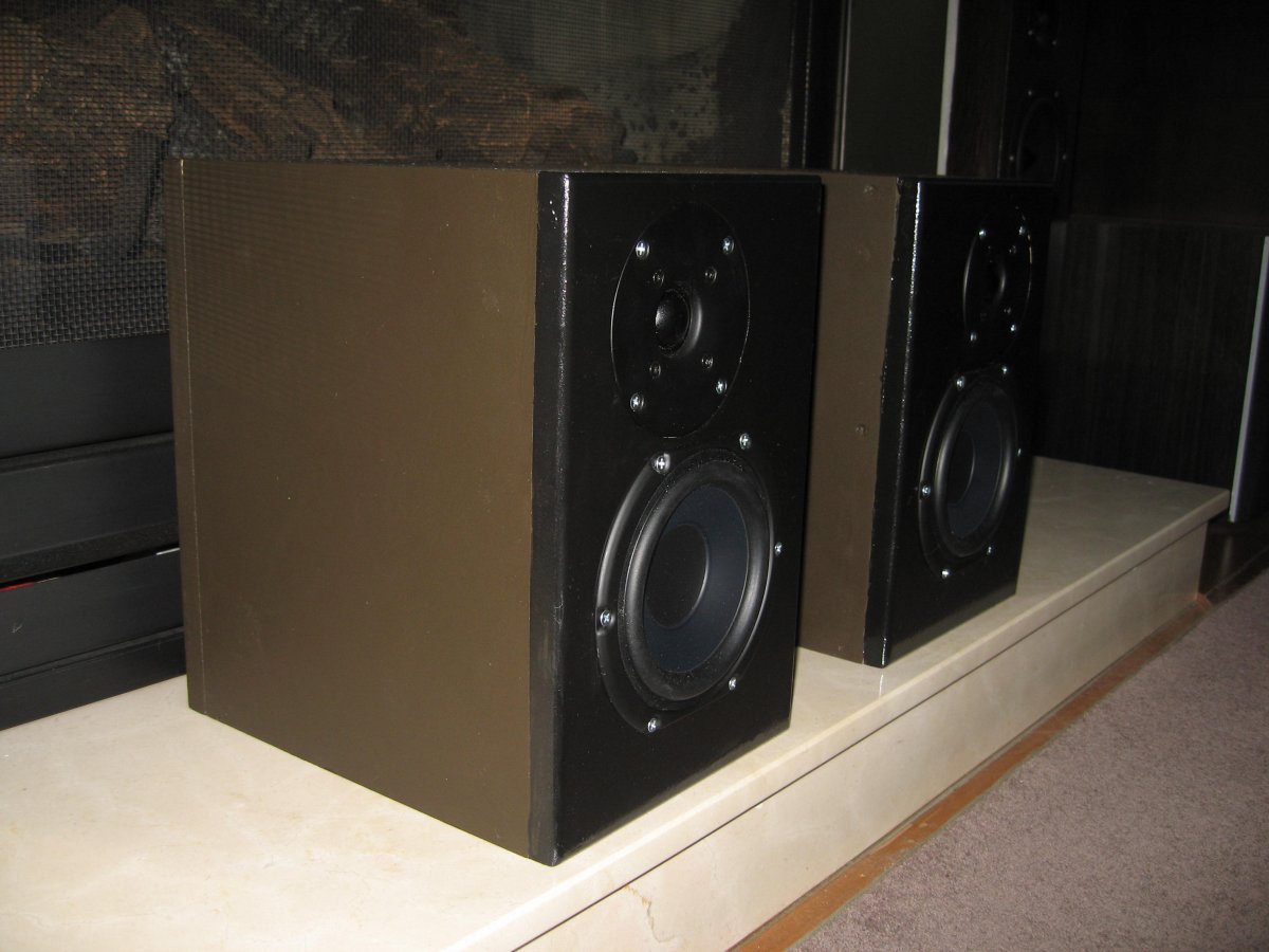

Here is my second pair of DIY speakers, with home-made cabinets.  Finish is acrylic paint applied with a roller and these look OK......... from a couple of metres away.
Drivers are Peerless 830656 5" mid woofers, tweeters VIFA BC25TG15s.  The crossover design was lifted from a European project which the builder kindly posted on DIYaudio (I think).  Second order on woofer, third on tweeter.. Please let me know if you're interested in the details.
Cabinets are 16mm MDF, ported in the back and the back panel is detachable for maintenance, hence the obvious seam in the finish.  The Peerless don't need to be rebated, which made construction relatively easy.  The VIFAs have a plastic faceplate so you have to be careful when mounting them, and you can't solder the terminals as it will melt the plastic.
Drivers are from LSK, crossover components and invaluable advice (as always)  from Speakerbug
I'm very happy with the sound, especially for the damage: about $280 all up.  HIghs are clear without being harsh, mids are smooth and detailed, and bass is acceptable as I use these with a sub.  Jazz and classical music work really well.
I haven't heard any commercial speakers which sound as good as these at the price point.
