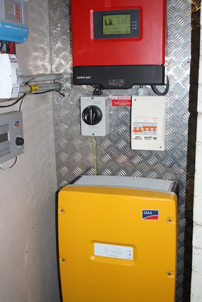

To add, my amp power supply comes from a 6Kva Isolation Transformer with a farad of insanely low ESR Capacitors,  but it is an inverter (SMA SI 6) hanging off a large battery, charged by over 4Kva of solar.
The silence in a treated room with the system up is lovely

Interestingly the isolated supply (transformer) I have is actually part of a Low Frequency Power Inverter made in Germany, by SMA
In the innards of the 80Kg yellow box is the capacitors and large transformer. It will quite easily run a 200A mig welder and a 9" angle grinder at the same time.
http://www.sma-australia.com.au/products/battery-inverters/sunny-island-60h-80h.html
This system was installed to run my stereo system, Sound Lounge and some of the home
It provides a very, very  low distortion mains waveform incrementally adjustable in 10ths of volts and a rather lovely piece.
