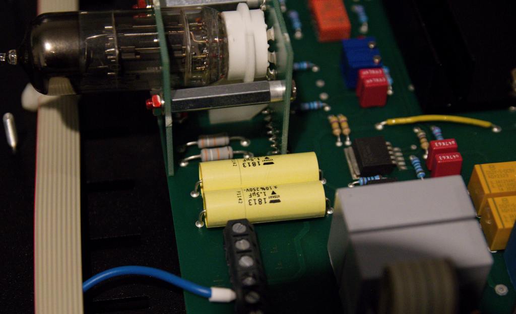

I have a Preamp that has a couple of tubes which has some Vishray 1813 1.5uf coupling capacitors.
There is not much room in there for large capacitors, so I was wanting to try some bypass caps across them.
I see the Duelund Silver bypass 0.01uf caps get good recommendations but they are quite pricey. Unless someone thinks they are worth the extra in this situation.
The other one I saw mentioned and was thinking of trying was the Jupiter Copper Foil 0.01uF 600VDC.
http://www.partsconnexion.com/capacitor_film_jupiter_copper600.html
Anyone have a suggestion to try a certain brand as a bypass cap in this preamp?
Not expecting any big chances but if I get that extra 1% then I am all for it. :)

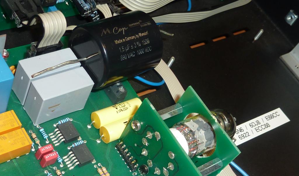

A friend has some spare Mundorf Silver/Oil 1.5uF caps but when I place just one in there, the lid does not close properly and hits on it.
  • Author
Actually just tried again and they just fit with the lid on in this position.

BTW, the originals are Vishay polyester capacitors which aren't the best. You want to use at a minimum a Polypropylene cap. Telfons being the top of the heap.
Edited by Sir Triode
No point bypassing as they are not electrolytic capacitors, you may as well remove the Vishay's and replace it with something better. Bypassing the films with another film will be paralleling, i.e. increasing the capacitance. Those Vishay's do the job just fine. You'd get a bigger difference by tube rolling, from a glance you have ECC88 to roll.

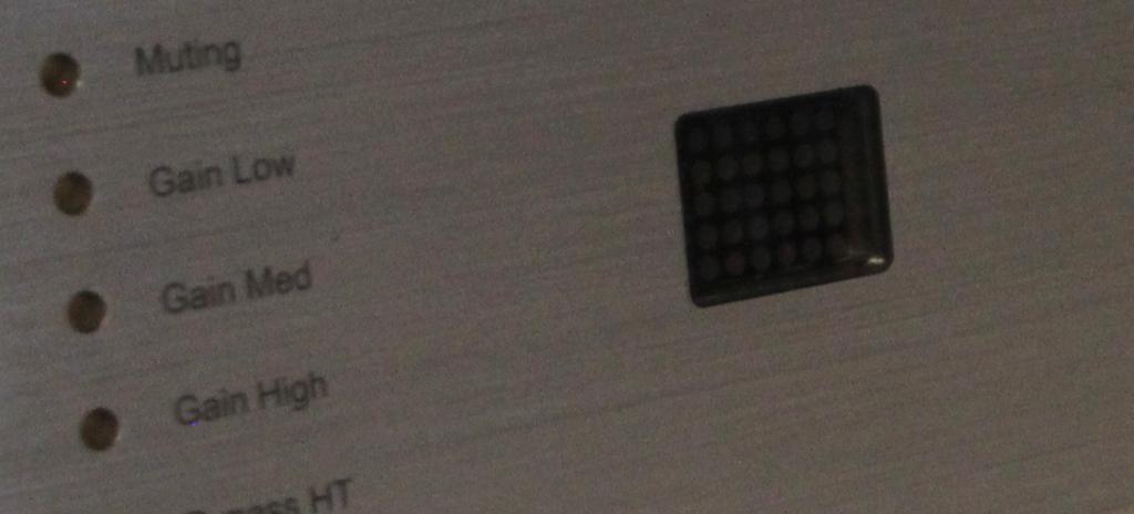

Its a Octave Preamp. Have had the volume upgraded. Recently had a local SNAer cut a whole if the front panel to to add the 2 LED display for the volume. (Fantastic job he did on that one!) Thanks Doncentric!!!

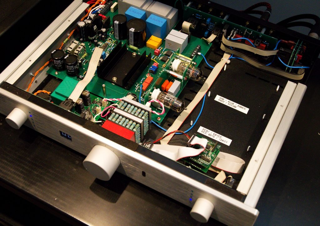

It already has been modified a bit so definitely not original anymore as in the pic below.
It is quite a slim profile which might make it tight for those bigger type capacitors. Those Mundorfs just squeeze in. They any good as I can get them at mates rates. :)

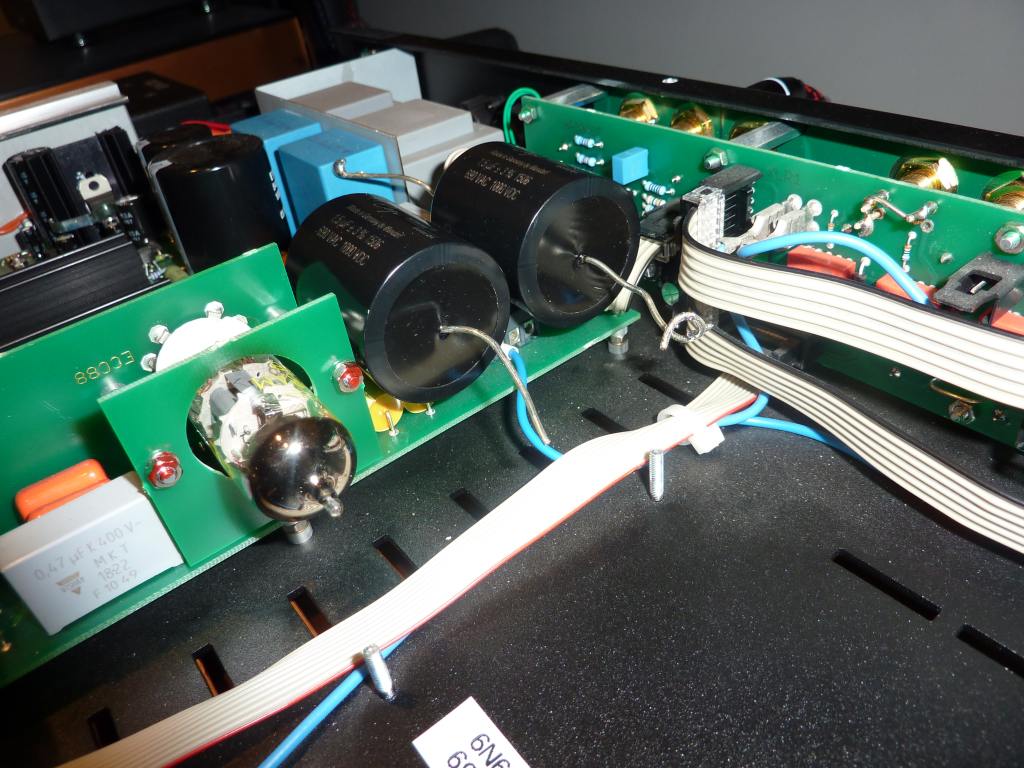

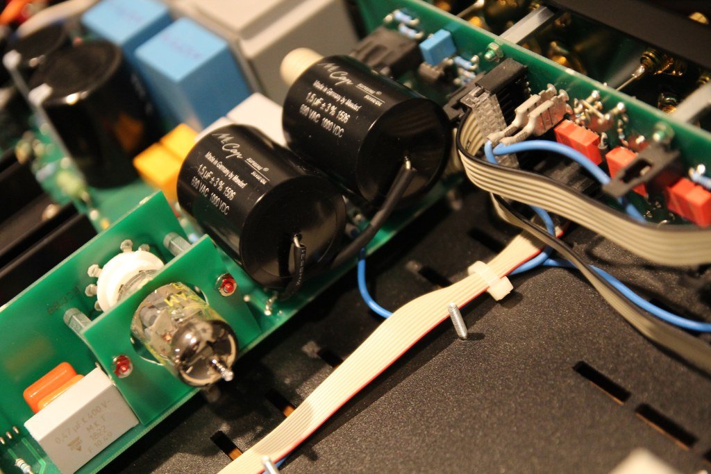

Well my mate said lets just try the Mundorfs.
So he put them in. He snipped off the old ones and joined the new ones to the bit sticking up left behind for now. No removing any boards.
Just powered it up and it does sound different. Will see how they go in the next few days.
Should sound great - you might have to wait 200 hours for their 'final' sound, though!  :D
Smart man your friend !!
Looks like he did a nice job of it too !! :thumb:
What is that very shmik-looking stepped attenuator, Rob?
Andy
  • Author
Andy
That is one I got from this guy below. 64 Step with relays inside. Included a 2 LED dimming display and remote. Great to deal with too as I had problems with the first model. He sent me out a new section and even new remote and boards. Works super great now. Was all silver to start with.
