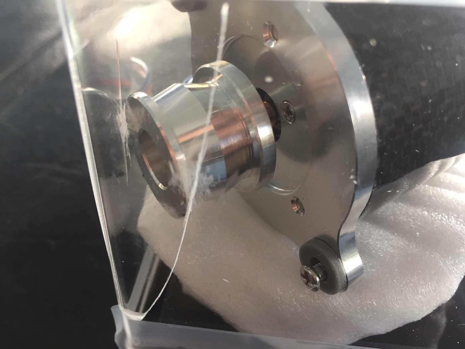

 The Motor kopt some damage in transit....:emot-bang:
hope its OK. Not going to Know until i do the rebuilds . I've emailed Edmund to see if i can do a "cold" run just to make sure

Ouch! yeah looks like it took quite a hit.
Also, you may have to modify the sensor mounting on your Khan (if it's the same as mine) as it's designed for the Linn tp.
I know Roger swapped the motor on his Mober to a re-max one, which I will probably do at some point.
Edmund gave me a re-max model no. to try.

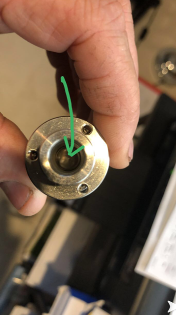

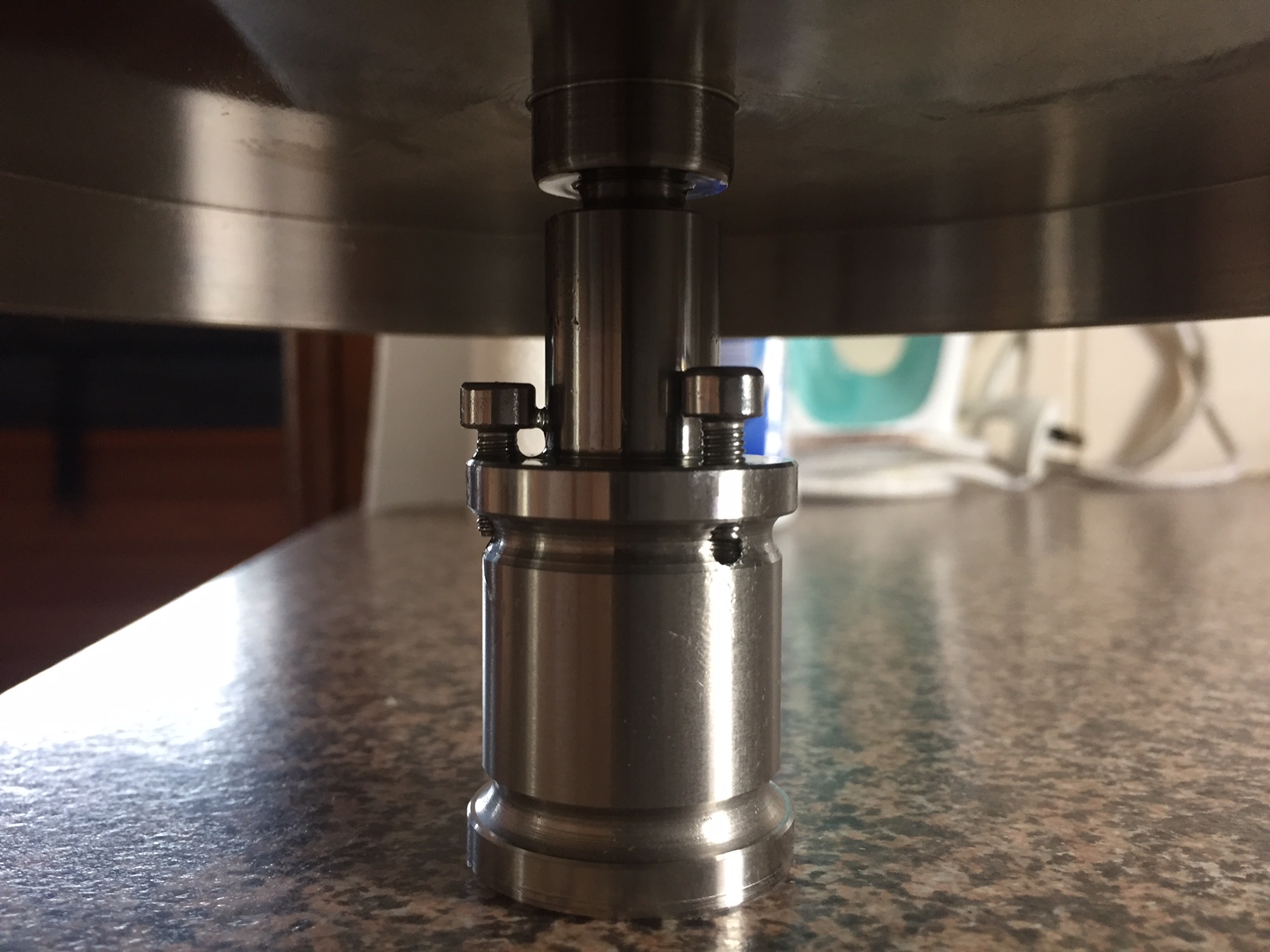

With Hand on Heart I have to report that the bearing has Failed in less than 2 years...
...basically it 'Locked up"  so I cleaned the well ...again...which didn't help then noticed the indentation on the thrust plate as shown...( best i can!! )
This was running with a TP Tranquillity too which reduces point contact upto 90%   supposedly.....:unsure:....
This was running with a TP Tranquillity too which reduces point contact up to 90%   supposedly.....:unsure:....
  .mmmmmmmm..
Tase.
Very sad, Tase.  :(  Hard to see how this could happen when you use a 'Tranquility'.  :(

8 hours ago, Capone said:
@Tasebass
Did you end up getting the bearing going again?
Yes...by replacing it with a Cirkus bearing I had in stock....
Incidentally it was the Radikal sensor that eluded me to the Mober bearing failing as the LED on the switch would not go dim ...( does this when speed is correct )....
Tase.

@TasebassHaving installed a brand new Cirkus bearing over Christmas I note that the thrust pad is polished to an amazing finish and looking into it you see yourself looking back.
I compare that to the mober bearing that is unused and see a dull finish with lines at the bottom of the bearing.
Is the circle in the photo an indentation or a shiny spot?  The fact the bearing bound up is not a good sign.
I haven't installed my Mober bearing and as it had sat for considerable time the oil supplied in it had dried out and was dried flakes.  I think someone else reported the same.
...That would have probably been moi .......as mine was caked in some oily gooiii stuff which required some soaking in chemicals for a period of time...
The thrust pad on the Mober bearing has an indentation. which as stated is even more puzzling cause it was used in conjunction with a TP Tranquillity....
I'd be sticking with the cirkus...
Cheers Tase.
