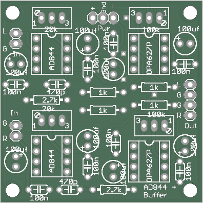

1st up the design of the circuit I will share here.
And then the PCB design sent of to Pcb Way in China which did quite a good job I must say.
Even got Enig plating (gold plated).

A close up with the populated PCB. As usual there is always some silly little mistake I make on the first batch of boards. In this case, I didn't quite get my talking happening between the CS8414 receiver chip and the PMD100 chip. There are a few pins you tie high or low (5/0V dc) to enable different communication protocols between chips. It wasn't anything major and can hardly be seen. I had to lift a pin from the CS8414 and tie it to Gnd as can be seen by the blob of solder between 2 pins. The CS8414 is the surface mount one on the top left.

@niss_man  I wonder if there is any DC offset on the outputs?

I have a trimmer on the ad1862 circuit to put 0 offset into the ad844. I also have optional trimers on the ad844 and the lme49710. I have 1-2mV at the output so I haven't even bothered installing my option trimmers,

That's an impressive low offset out result. Well done.
Also if you want a great alternative USB input look at the new Audial USB board that can bypass the PMD100 and feed the AD1862 right justified data direct with very low noise. This will  allow you to play NOS ,HD or use your computer to up-sample and filter to your tastes.
You can see on the image the trimers for the ad1862 beside them and the optional trimmers I didn't need above the ad855 and lme chips above them.
You would be able to make a nice simple dac with the Audial USB (usb only) using only dac chips and output stage, but I need other types of inputs as well. The price of the Audial is a bit ridiculous as well 170-180 euro, 230-250AUD delivered depending on the option of additional firmware!

4 hours ago, niss_man said:
You can see on the image the trimers for the ad1862 beside them and the optional trimmers I didn't need above the ad855 and lme chips above them.....
So you went with the LME49710 insteadd of the OPA627?

On 15/02/2017 at 4:12 PM, niss_man said:
Yep. Using the LME49710. OPA627 isn't really better or worse for that matter. Pretty much the same. The LME wins in the price department though.
