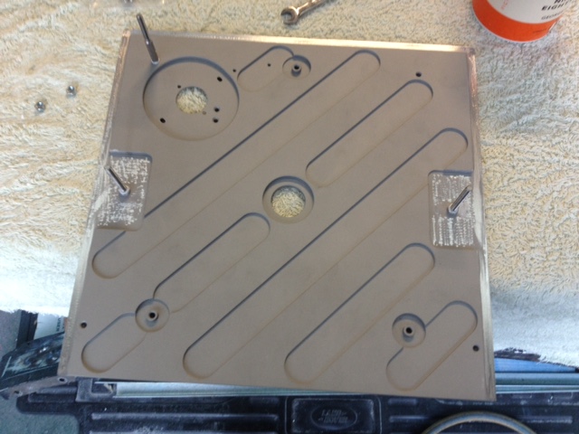

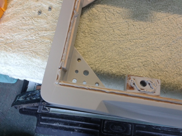

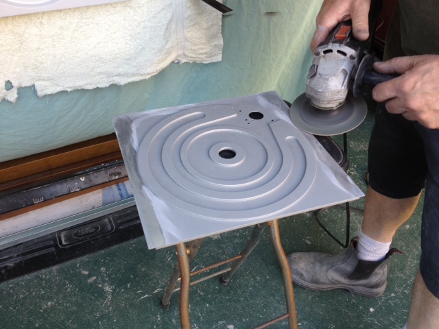

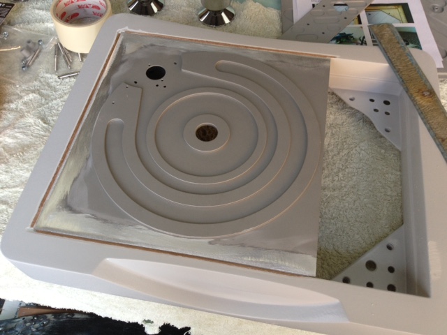

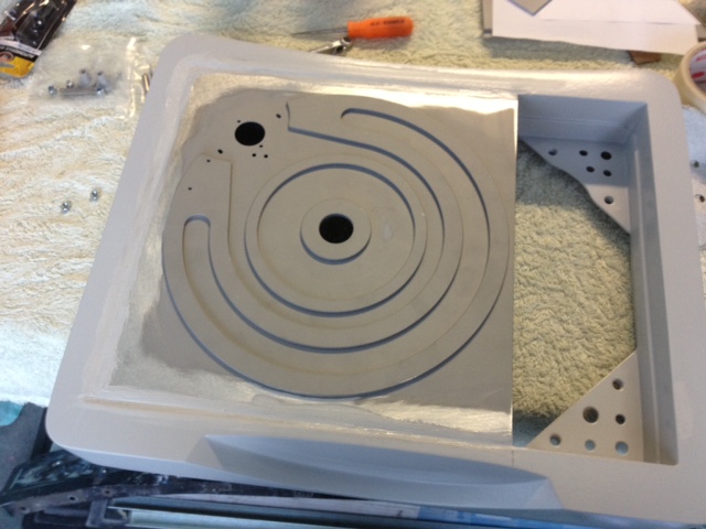

 Here I am prep the Khan top plate ready for bonding to the modified plinth using an angle grinder with a p36 grade pad to remove the anodize coating and key the aluminium...
post-109454-0-89633800-1460803527_thumb.
 I made sure the Khan and the modified plinth mated perfectly....this actually took some time to do but had to be done otherwise the completed plinth would have been next to useless
post-109454-0-80767300-1460803529_thumb.
post-109454-0-69802200-1460803530_thumb.

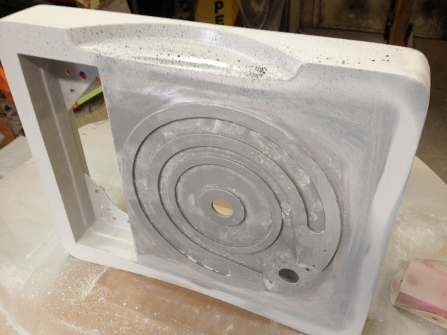

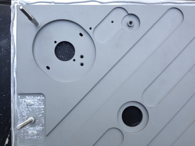

 Once the prep was complete including making sure everything was clean and dry!! I applied the Fusor 110 adhesive...
post-109454-0-52176500-1460803531_thumb.post-109454-0-32431100-1460803532_thumb.
post-109454-0-99661900-1460803532_thumb.

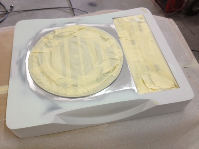

When the Fusor had fully cured I went into the filling and painting stages....
I didn't rush this process either, letting the adhesives and substrates cure and dry fully before moving onto the next phase (s).....

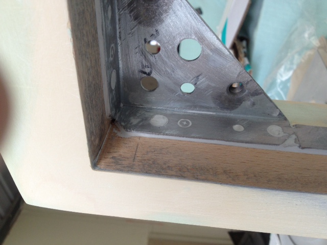

post-109454-0-18113100-1460805010_thumb.
Above is an image of the steel "chassis" I fabricated and the attention to detail needed.....

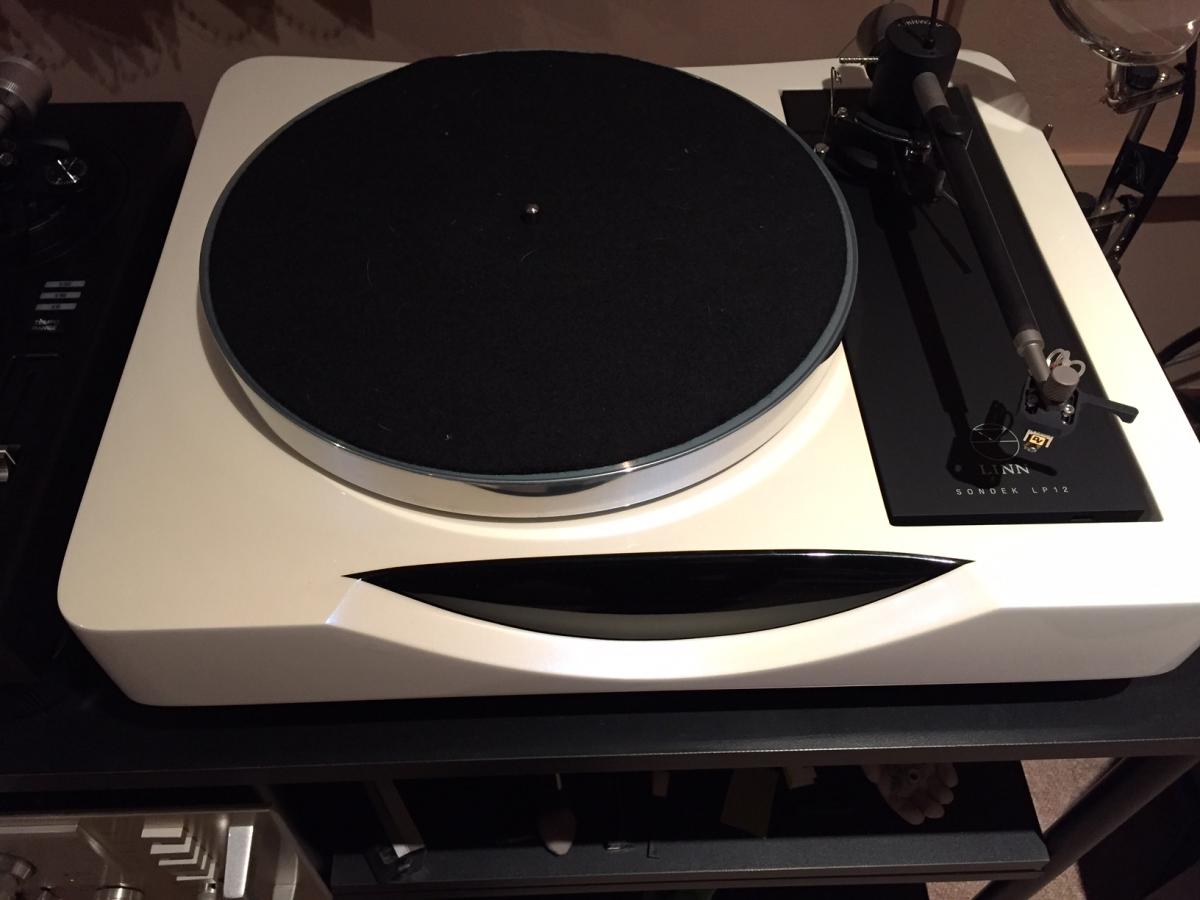

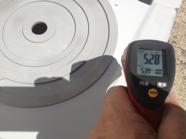

As the weather warmed and still in the testing stages I kept checking for thermal movement for weeks on end.....this is the second plinth outside in the Sun for some severe testing.....
post-109454-0-94884400-1460805012_thumb.
This image I shot tonight nearly 3 years after initial fabrication...no movement..no sinkbacks...no shrinkage...
Looks exactly the same as the day the final finish went on..... :)
